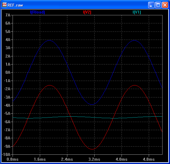

Perhaps the best way to appreciate the value of the switching current sink is to look at the current waveforms in the power supply and load. First up is a reference design that uses a constant current sink made from another linear transistor circuit...

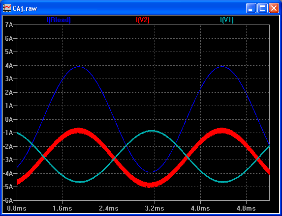

And here is the same supply current going into the switch-mode version of the amplifier...
I think this shows something like 2.8 Amps versus 5.5 Amps from the PSU for the same output power.

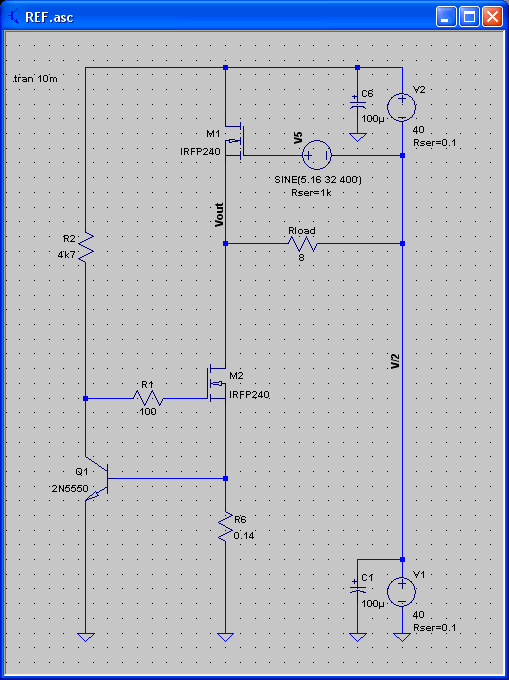

I ought to explain the above plots a little better: The "Reference" class A circuit I'm using is shown below. To see the supply current share I've split it into two voltage sources and biased the follower to allow the load to return to the mid-rail point. The model I posted earlier for the switching version uses the same basic layout for comparison.
The dark blue plot is the load current ~ [ 4A Pk. (4*.707)^2 * 8 = 64W if that's the accepted way to calc. RMS power in the load]. The other plots show averages of 5.5A and 2.8A in the two designs. For the 80V supply shown this is 440W vs. 224W (I hope someone is going to check this because it's beginning to look too good to be true to me).
BTW; All the single ended designs I have come across use a high-value capacitor to return the load to one or other supply rail - nobody ever seems to use a split supply. I guess it's because it would be impossible to adjust the offset into the follower gate such that the source remained within tens of millivolts of the mid-rail voltage under all conditions?

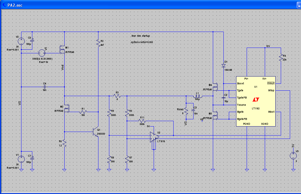

This circuit is very interesting. I wonder why we have never seen anything like it before. I looked at the circuit of post 59 and have a few comments / questions.
I had to add UIC to the transient analysis command, otherwise it gets hung up running a pseudo transient thing. How did you get it to run?
LTspice can plot power, and you can also have LTspice give you the average value of power. See the "trace data selection" section of the LTspice help file on how to do this. Note that you must have an integer number of 400 Hz cycles for the average power to be correct. There is a start up transient so I saved data from .5 msec to 3 msec.
I realize the current regulator circuit is just intended to demonstrate the principle, but in practice I would consider using some kind of PWM controller. What you have now is sort of a hysteresis regulator that depends on propagation time through the loop. Please don't take this as criticism, because I think this idea is quite innovative.

sawreyrw said:QED047,
Well, I'd really love to be able to take some small credit for raising it - but I bet it's been rattling around somewhere else before.
UIC? I'll look that up right away! I just hit Escape and it ploughed on regardless.I looked at the circuit of post 59 and have a few comments / questions.
Many thanks for the tips! I've only just started out on the learning curve. BTW there's a *very* obscure reason why I used 400Hz as an arbitrary test frequency. I wonder if anyone knows why (giggles).LTspice can plot power, and you can also have LTspice give you the average value of power. See the "trace data selection" section of the LTspice help file on how to do this. Note that you must have an integer number of 400 Hz cycles for the average power to be correct. There is a start up transient so I saved data from .5 msec to 3 msec.

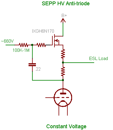

QED047 said:Something would surely have to servo the DC to keep it in check? And I'm guessing that that would clutter the circuit beyond recognition.
Nah, just search the tube forum for MJK's variant of the Anti-triode.
Its based upon Waveborn's gyrator load, but an active helper too.
Got incredibly useful self-servo action at DC...
Very few changes to implement... Here's a copy of his diagram:
I believe this one would tend to center out around 658V...
The IGBT in this diagram is doin what your switcher ought to.
To be clear, its drawn upside down to the way yours works...
The plate of his triode would be your MOSFET's source.

Thinking on a bit, the problem with the power plots for the abused centre-tap in post#60 may be to do with the way I return the flyback voltage. The recycled energy is a bit toxic when it makes its way out the diode's cathode. Returning it to the PSU and modelling it properly is a bit of a challenge. I'm not seeing anything like it on my breadboard.
Perhaps I should be re-introducing the recycled power into the supply resevoir via an inductor? The flyback voltage goes as high (or low) as you let it, so a capacitor is still needed on the cathode. But it would seem to be a good idea to use an LC combo to pour the volts in gently?
The power in each sense resistor is 1.25 watts, so a 3 watt resistor will not be abused at all. I'm not sure what you mean by 'recycled power', but the cathode of the diode must be connected to a very low inductance point. Otherwise you will have a huge L di/dt spike.

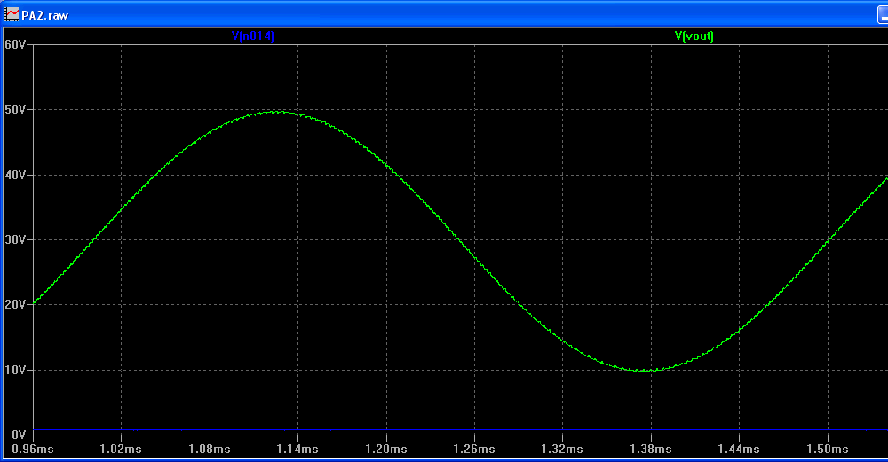

Attached is a schematic of an LTspice sim plus some output.
