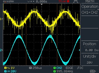

Hello.
I've built 6 of these amplifiers now, and 2 L15D to power my surround system. I use them to bi-amp front an center, while the L15D's are connected to the surround speakers.
The "processor" is a Yamaha RX-A810, receiver with pre-out. Last time I ran YAPO, room correction, I got the message that all my speakers where miswired.
Therefor I tried to measure input/output with an oscilloscope, an learned that the L25D reverse the phase from input to output. Anyone else who has discovered this?
The "prove" is in the picture below, keep in mind that for test purposes I used a small transformer 2x30V/120VA. I normally use 2x45V/500VA for two amplifier connected to a Klipsch RF-82.

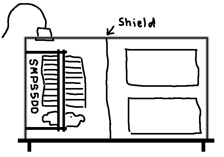

If i mount them vertically, pcb-pcb with the heatsinks on top and venting holes in the chassis.
Should be ok i think..?
But also you mention no direct shielding. I'm not sure what that means. Can I have a section for psu, separated by a wall? The wall will be fairly close to the outer module though, about 10mm.
I've made a rough illustration. The distances here is not correct, it will be much tighter.

Mesc: seems fine, if you can drill some holes on the enclosure for ventilation. the smps has a small thermistor on the mains side power transistors which will shut-down the smps if the temperature rise above 85*C which can happen in a sealed enclosure. the highest normal working temperature is about 55-60*C on the secondary diodes heatsink or transformer windings. durring tests, I overload the SMPS500R and keep in a seled enclosure till it reach the OT tripping point to make sure will work properly. but of course this is an exceptional situation and should not be encountered often in real life situation, because it shortens the life of capacitors if they are exposed to high temperatures and high ripple current for long periods of time. nice drawing, btw 🙂
