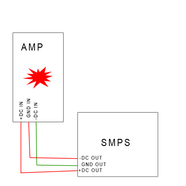

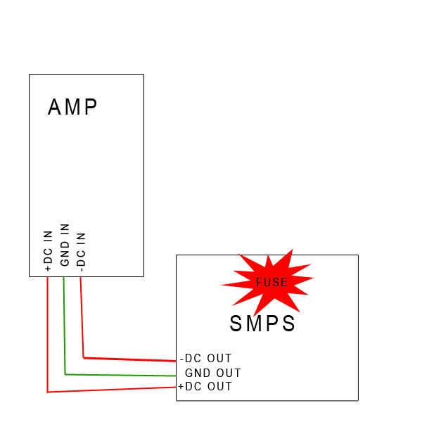

I have an SMPS500R that I hooked up and accidentally switched the ground and neutral lines when I plugged them into my amp. Of course, my amp fried and when I fixed it and turned it on again, the fuse on the SMPS blew. Any ideas on what could be the cause? I'm nervous to plug it back in when I fix my amps in case anything else on the SMPS is busted.
No no no. Sorry, I should have been more clear. I plugged the GND wire from the SMPS into the -V terminal on the amp; consequently, I plugged the -V out from the SMPS into the GND terminal on the amp. This diagram shows what happened on the first trial. The fuse on the SMPS didn't blow on the first trial, but rather the SMPS made a strange humming sound. When I fixed the outputs to be correct for the second trial, the amps turned on for a moment, and then the fuse on the SMPS blew.
The first picture is showing what happened when the connections were incorrect. The second picture shows what happened when I fixed the connections from the first trial, and tried powering the system with the blown chip in the amp.

I see now.
seems that one of the rail was shorted. i can fix the power supply if you can send you back. please contact me by mail for return details.

This is the fuse which blew. The other two smaller ones are fine.
In 90% of the cases, the fuse is the last one who blows, it;s purpose is not as much to protect the smps, but as much to protect the rest of the mains circuit against the effect of a short circuit.
you can replace the fuse, then have another try. i suggest to use an incandescent light bulb instead of fuse, if the smps is damaged, the bulb will lit continuously, if not, just during turn on. if is fine, replace the fuse with a similar one, 8-10A at 250V. do not make improvisations, like wires soldered over the fuse or pcb.
Ok. I'll try the lightbulb in the morning. Are there any other tests I can run to see if the SMPS is damaged? By the looks of it, the rest of the components are fine. I don't see any blown resistors or capacitors since there are no burn marks or discolorations on any of the other parts.
I just did the lightbulb test and it lit continuously. This means the SMPS is broken, correct?What do I need to do to fix it? I'm quite experienced with soldering and pcb layouts and can order replacement parts in the USA, which will be much faster and less expensive than shipping to China and back.
