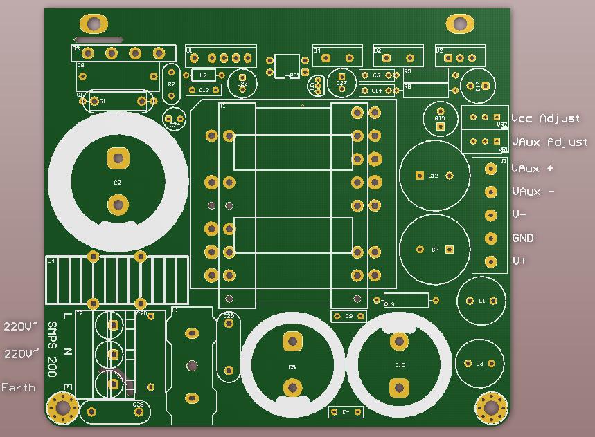

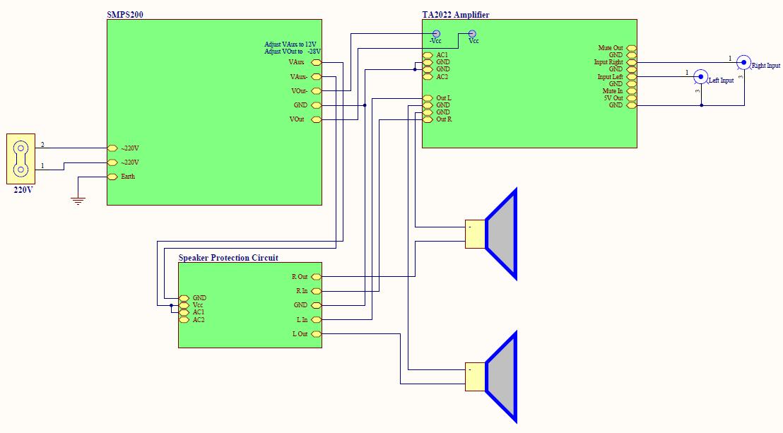

i will write the manual for the smps soon. until then, please ask me if you have some questions about.
I will attach the pinout diagram and application example using this smps, TA2022 amplifier board and Speaker protection circuit

How to connect to TDA89xx board?
the smps250 pcb size is 100x90mm. complete size including all the parts and heatsink 100x100x52mm. the output voltage can be adjusted within +-25 to +-31V range, so can be used for any TDA89xx amplifier modules.
If I want to use the smps instead of my toroids, how do I connect the SMPS. Is it in the samme place as the toroid, or should I solder new connections somewhere on the circuit board?
to use the smps for the TDA89xx amplifier modules, just simply remove the rectifier bridge from the board and connect the AC1, AC2, to the corresponding + and - pins, and connect the smps to the amplifier board with regard to the correct polarity. the smps output voltage must be lower for the TDA8920 and TDA8924 amplifier boards, +-24V and for the TDA8950 can be +-30V. the voltage can be adjusted from the small pot on the smps board.
