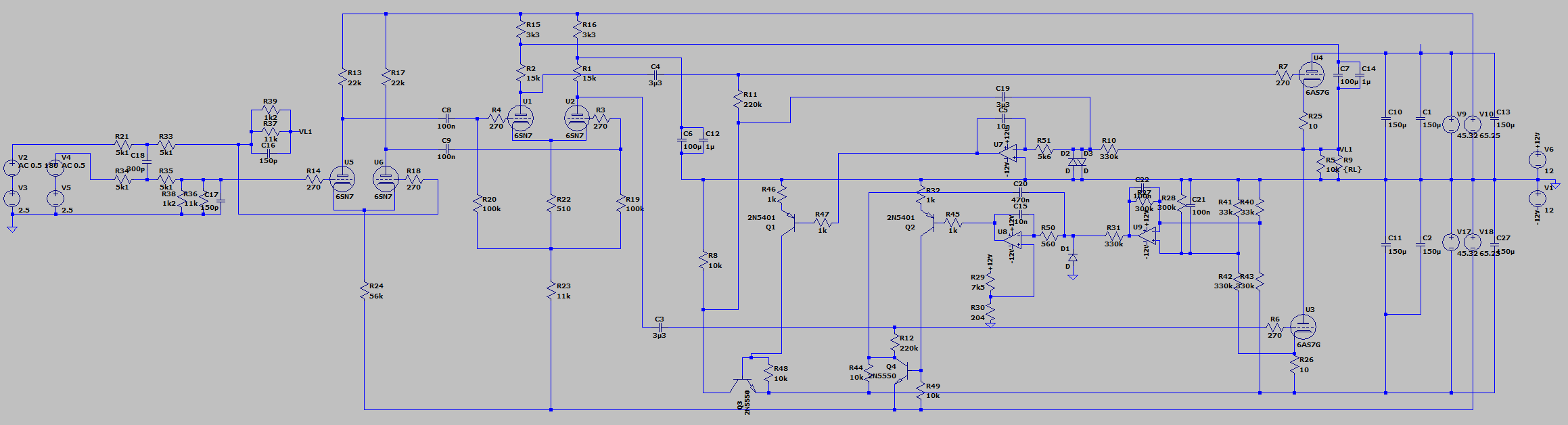

In regard to the heater/cathode voltage, how do I arrange that when my output is a push/pull stage? That would essentially mean that the voltage between cathode and heater will always be different from one triode to the other, within the output tubes.

Tube amp schematic
The thing is, that the PP output is an OTL configuation, so its a totempole configuation where the top tube cathode is connected to the output and the bottom cathode is at -b or -45V, which makes it impossible to have the same heater to cathode voltage withing the two triodes in the tube.

Hard to see at the schematics as it's very low resolution , can't you post a better
image ? Or better a pdf ?
Sorry, not used to posting pictures here. I hope this works better.
The issue with connecting the heater across the different tubes is that then i would need 4-5 different tube heater supplies, so that is not an option for me.

Yes, this schematics is readable (in my computer).
The only tube that has cathode far away from ground seems to be the bottom 6as7. Am
i guessing right ? Is the amp fed from + and - 200Volt ?
The bottom tube(U3) could in that case be supplied from AC filament where the DC level
is closer to -200Volt.
All other tubes seems to have cathodes close to ( within 50Volt) from ground.
My supply rails are +/-65V, trying my best to keep the voltage low, since this is a headphone amp that is intended to be DC coupled to the output.
Cathode U5 and U6 is about 0V, Cathode U1 and U2 is at -40V while U3 and U4 are at output level and -65V. If its just a matter of keeping the heater voltage under the cathode voltage and staying within the limits of the tube, then it seems like i should tie the heater to -65V rail, or am i wrong?
