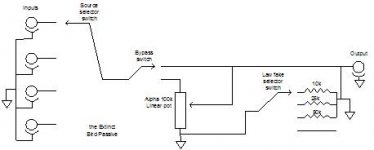

I intend to build this passive for my low power class-t amps, amp3, t-amp, Charlize (one day perhaps).
Idea behind being that I can switch to different pot value depending on the source chosen.
Easiest is a switchable law fake value.
Example I would choose 50K or 25K value for Monica2, 10K for output of CD player, whichever sounds best or gives the optimum attenuation without limiting HF response. I also think that Monica2 cannot a 10k pot correctly.
The bypass switch is specially included for Monica2 which gives low output. This way I can bypass all attenuation. I guess that I will also have to put the law fake switch to the unconnected position for this to work.
I intend to use Alpha 100k linear. I know that the 50k log is very good and very cheap. I'm not sure 100k is ideal.
Has anyone done this before. Will it work as intended?

I can only repeat my views that unless you are using a 10K volume control, you need to have an active buffer before the class-T amps!
And if you are using a 10K volume control, your Monica2 won't work optimally! In short, no amount of clever (passive) switching will allow you to use Monica2 (or DacKit) with a class-T amp. 😉

In theory it will be a good idea to have a switchable volume control impedance.
But only if all the equipment that you are using will work on one of the switchable impedances. If two of the items in your chain won't work together without a buffer, then it doesn't matter how many options you have for the volume control, they just won't work optimally.
Once more. The Monica2 needs to work into 20K or higher. Without a buffer, the class-T amps need a 10K or lower volume control. There is NO impedance higher than 20K but lower than 10K!

Hi, just to say that you have grounded both sides of your resistors in the diagram.
Do not ground the output..
Thanks audio1st, I didn't realise that I grounded the output on the diagram. What was I thinking?
