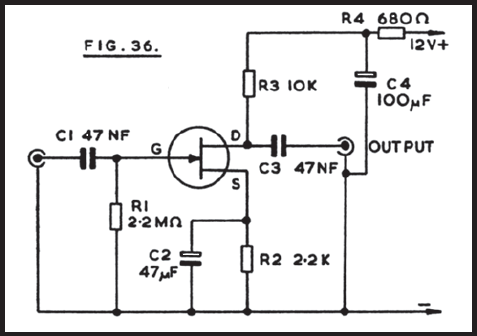

Switchable Hi-Z input impedance, how ?
my, this fet amp looks just like tube amp
jfets are supposed to be the masters of hi-Z input
how high input impedance can we achieve using tube only ?

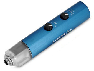

this 'thing' has instrument hi-Z input, and connects directly to USB port
even has headphone out
not really cheap, but what else do you need
plug it into your home stereo media streamer
or via PC with all kinds of software
and thats it
very tempting

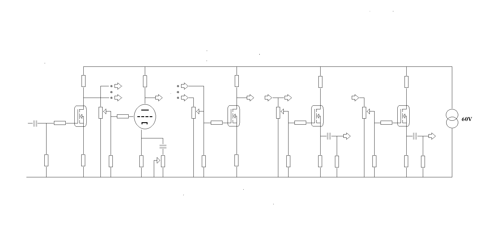

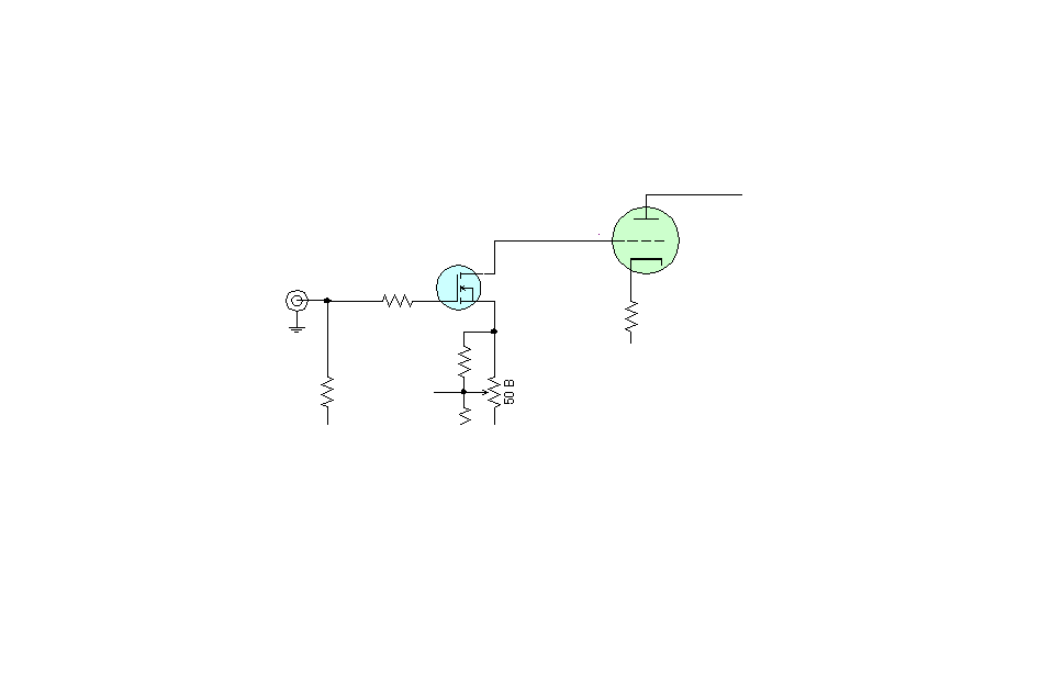

hey, I chopped this out of a probably nice amp
but I wonder, running this at just above 100V+, maybe it would make a nice buffered distortion preamp
only part of it ofcourse
btw, I night have found my preferred bass sound
adding just a little touch of natural growl, and its almost similar to the gnarly sound of a real acoustic double bass
which I happen to like a lot

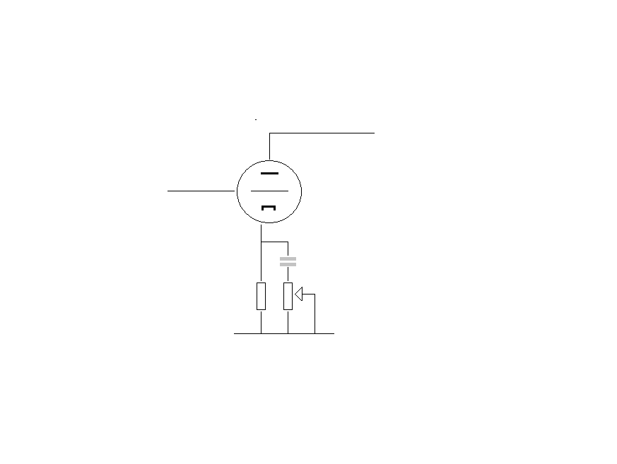

also, this might be cool
both gain and frequency adjustable 🙄
still need output buffer to drive a solid state amp :mischiev:
either the same mosfet
or I have some 6C19n that ought to run fine on this 'lowered' voltage
well, easier said than done :clown:
hey, maybe the 6C19n would make nice distortion with even lower voltage:scratch::faint:
hmm, I would need two input options, with a switch
one with all mosfets, and one with tube coupled in
but thats the least of my problems
is this completely nuts

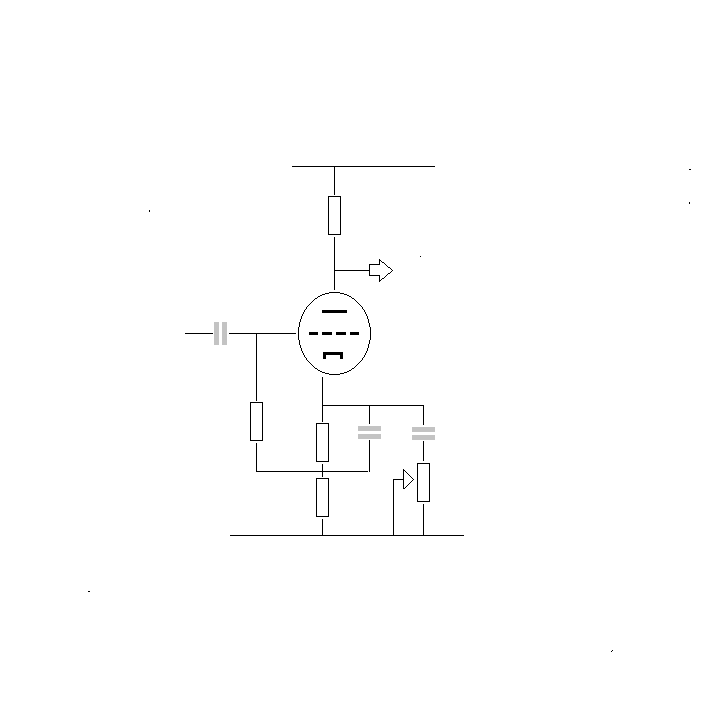

The answer to getting hi input Z at AC whilst maintaining that lower max Rg1 value for the input tube was in an earlier post (D96 was it?). Divide the cathode bias resitor, bypass the top resistor and connect the RG1 to the junction of the 2 resistors instead of 0V.
That is BOOTSTRAP the Rg1. DC wise you still meet the max Rg1 requiremnt (and it is at DC where it is important) but you also increase the effective AC impedance.
Ian

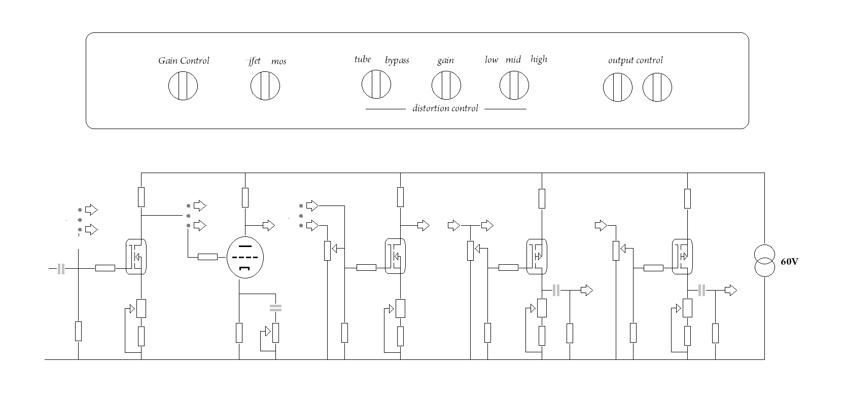

btw, I removed one att
I think D96 said that I could use the cathode bias like a gain control
but now I want to use as distortion gain control
not yet sure how much gain I will have, or how much I need

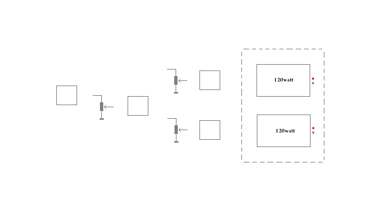

I got a nice DIY stereo power amp yesterday
built it a long time ago, and now got it back
will try a few experiments
Ian

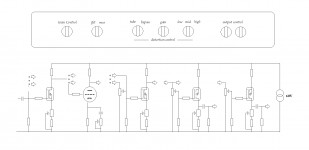

something like this 😕
I remembered now that max grid resistance of 6C19n would be 500K
but should be no problem to have a jfet in front of it
apart from the 'problem' with different voltage
I was trying to avoid that by using a mosfet instead(2sk2013)
at least I suppose it would be ok with this higher voltage
btw, I plan to have a switch with 3 different cap size fore the cathode/gain control, and pot adjust will be on front, or as rotary switch with fixed resistors
if possible at all

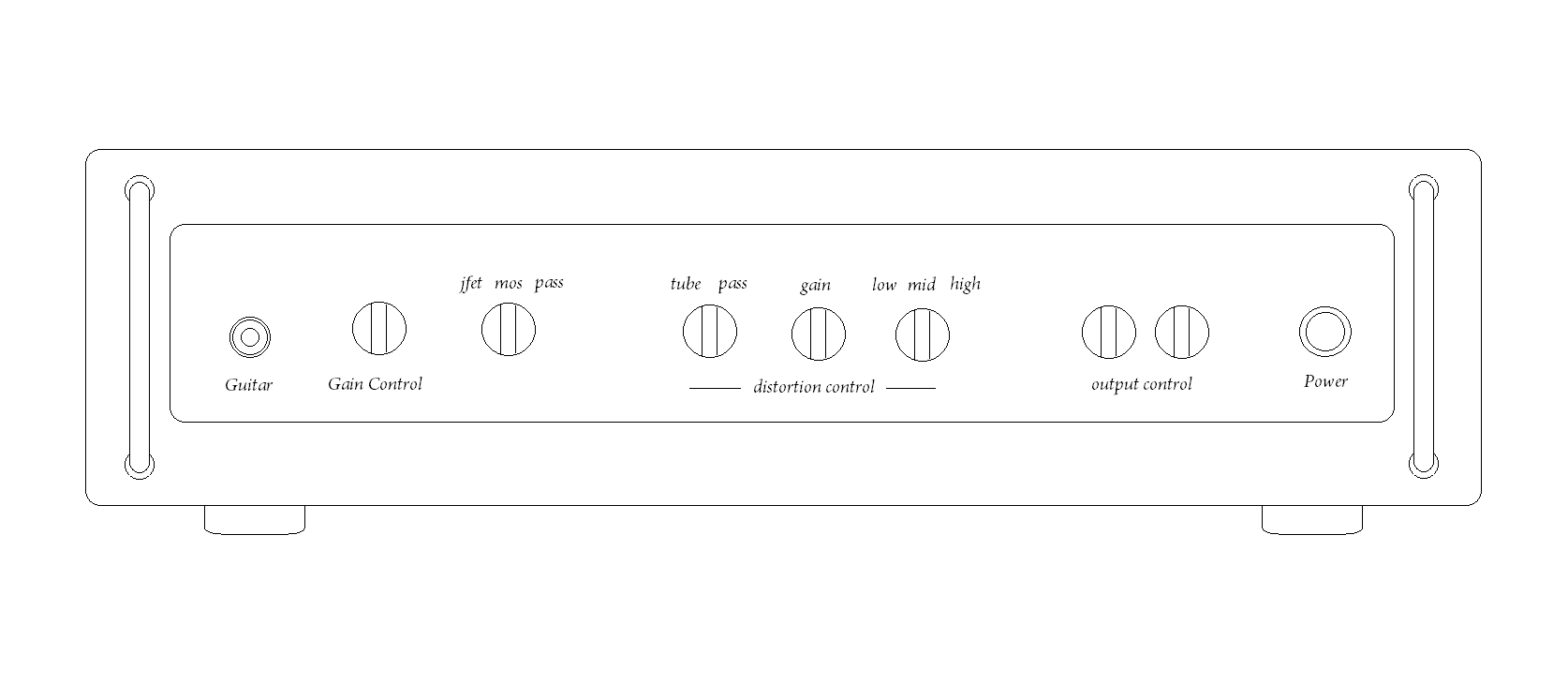

Yes,
Something exactly like that.
The signal voltage at the cathode follows the signal voltage on the grid. For AC signals the signal across Rg1 is therefore about 1/10th what it would be if the Rg1 were tied to 0V instead - for AC signals therefore Rg1 looks to be about 10 times as large. So if you use a 500K resistor for Rg1 it will look like about 5 Meg Ohms as far as its AC input impedance goes.
Of-course there is nothing wrong with the proposed JFet buffer either - the boostrap arrangement might just be a little easier (less parts).
Ian
