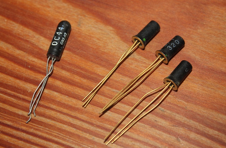

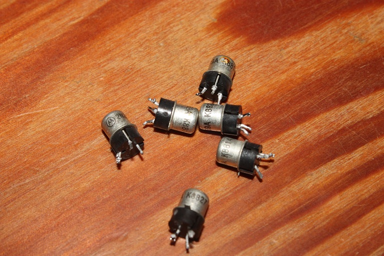

finally someone noticed it 😀
I didn't know when I found it, and thougt it was just a weird worthless component
until I searched, and found its very rare, and 'wanted' for classic distortion sound
could be fun to try it, but would be a shame to destroy it
and I don't know much about it at all

I searched again where i found it, but ofcourse only this one
there is also a SFT 320
also old transistor
do you anything about that one ?

For OC44 you can build up a nice little vintage fuzz

looks similar to what I have seen mentioned as Rangemaster ?
noticed the lowish input impedance....if you can call 68K lowish ?
I suppose it will need a high-z buffer ?
any idea about output impedance ?

OC44? - takes me back ...
😀..... how about the other less famous SFT 320 ? 😕
