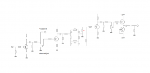

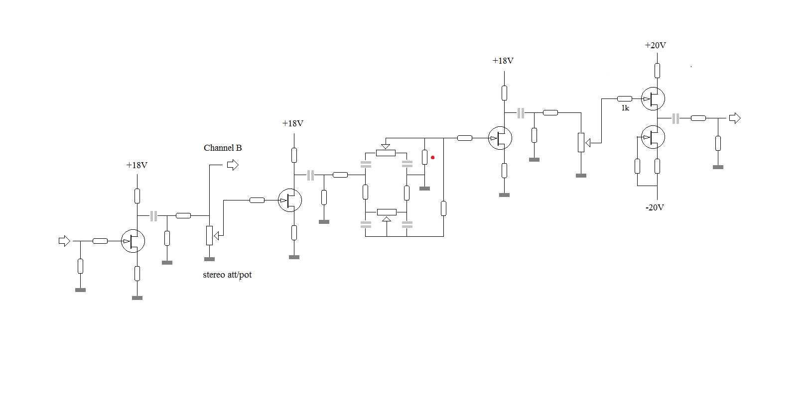

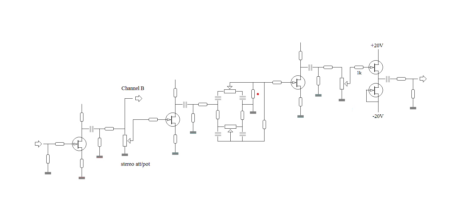

What schematic (link, post nr.) ?... like using two 2sk170 instead of the complementary pair...
What trick ? Why/where combine J310 & BS170 ?...would the trick work for combining j310 with BS170 ?
Sorry Tinitus, i can't see inside your head, please reference your ideas with links/post numbers...
1. What do you mean when you say: "with the j310 being a tougher one" ?
2. First you want all N ch. devices (and the buffer is a great place to do it) but now you want complementary pair, push-pull buffer ? It makes sense only if you want to drive the next stage which has 1k-3k of Zin...
....... maybe a symmetric output buffer ....... ?
shoot, forgot I think you said j310 cannot replace a sk170, directly
any ideas ?

Right, it will produce more undistorted voltage swing in the same topological form due to differrent construction (long gate vs short gate JFET), lower gm (lower gain being the price to be paid).I think you said 5v out, and isnt that more than sk170
Not directly - they belong to different construction groups.shoot, forgot I think you said j310 cannot replace a sk170, directly
any ideas ?
If you want complementary buffer with J310 first you have to find a P ch. complement for it.
And if you want a single ended buffer with J310 (like B1) you'll have to put up with Zout of few hundreds Ohms or to use coupling cap.
sounds good to me, and what I had in mind, eventually
introducing the j310 kind of changed the picture, with its lower gain, and no buffers needed, apart from maybe the output
ah, I see what mean
if no cap, there would need to be resistors to adjust the dc, and thus higher zout

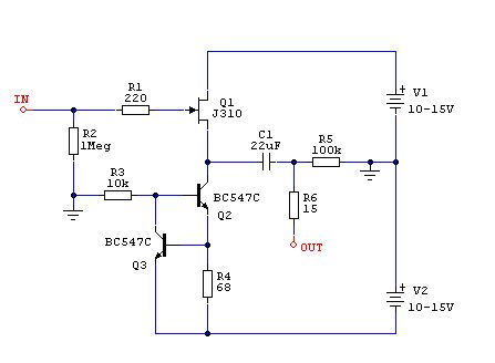

could a j310 output buffer look something like in this ?

Yes it could, but since you have a lot of BC547 you can use them as CCS (see attached sch.). If you plan to use SMD J310 don't go over +/-12V PS voltage and to lower the Pd you can change R4 from 68R to 100R. Expect Zout in range of 100 to 150R (R6 included)....
hey, thats the one, I like it, simple and very cool looking buffer
thanks juma

BF245C can be used - it's cheap and abundant, but with it you can expect a bit higher Zout (200 - 250R).... any alternatives to the j310 ?
(and not to forget, I still have 2sk170)...
You better save k170 for hi-fi projects but if you insist to use them this way, set the current through BC547 CCS to about 80-90% of Idss (by means of R4 - higher resistance => less current)
It doesn't change anything important here......oh, and it appears all my BC547B, are...B types, Motorola(736ZF)
j310 with CCS looks just perfect for me, thanks
