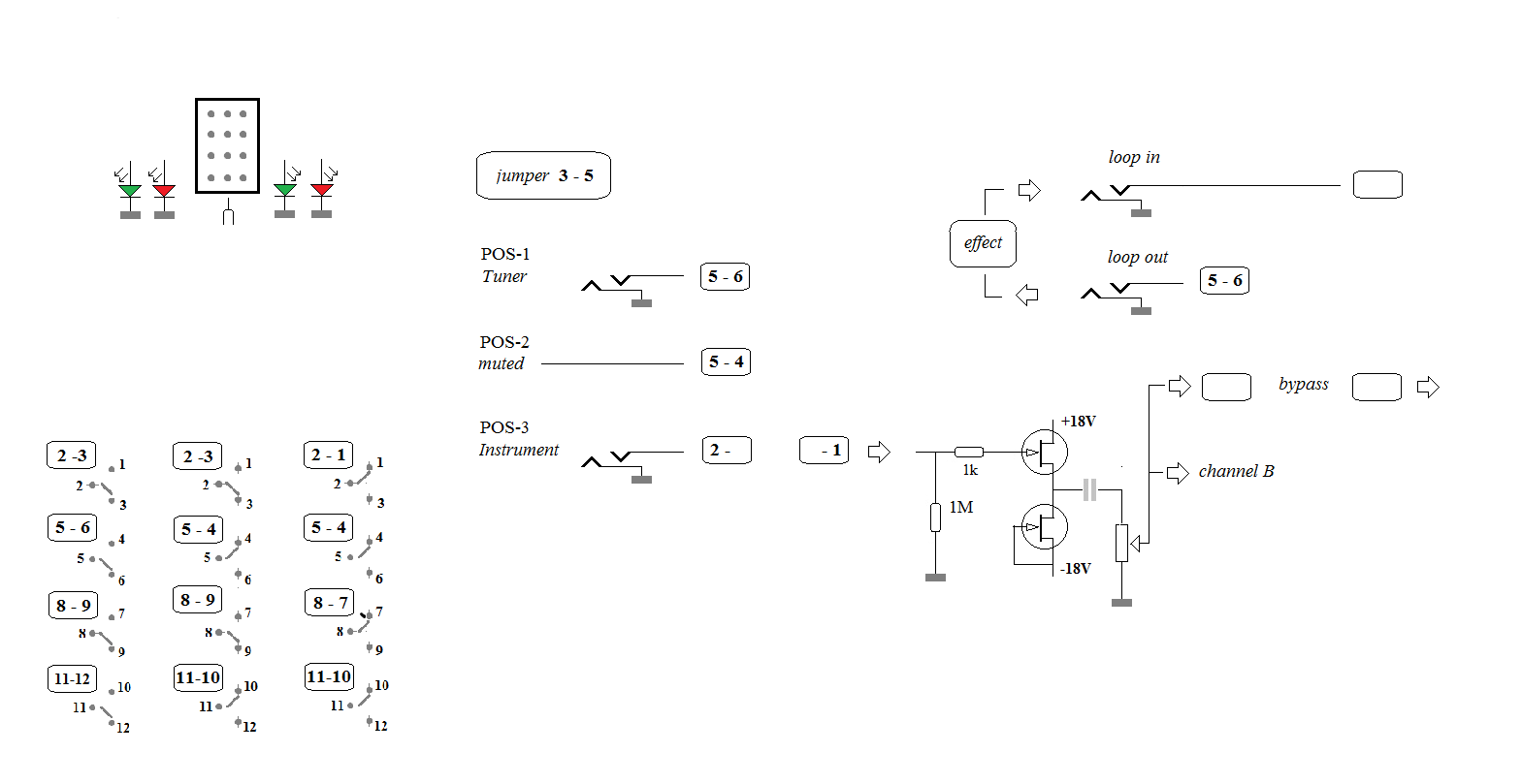

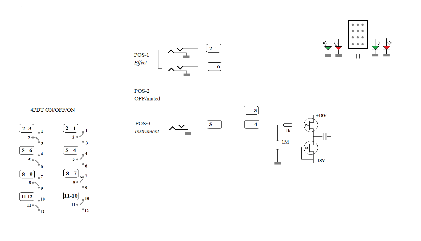

only problem with above input scheme is, tuner isnt working while playing
my main problem seems to be that I insist on the middle POS-2 to be the muting mode
I cant see how, and its very annoying
and btw, the muting mode would actually be the tuner in muting mode
in reality its just a second 'direct out' plug
should be easy, but.....

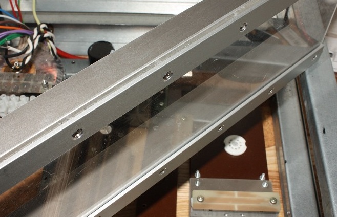

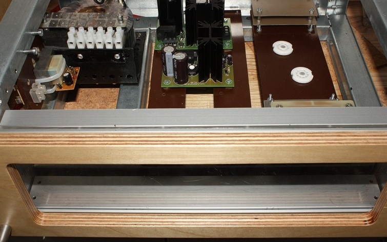

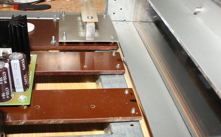

hey, while thinking about it, a few pictures
I managed to assemble the front
havent yet used the new smoked poly plate
so this is just some scatched clear poly, for the proto work

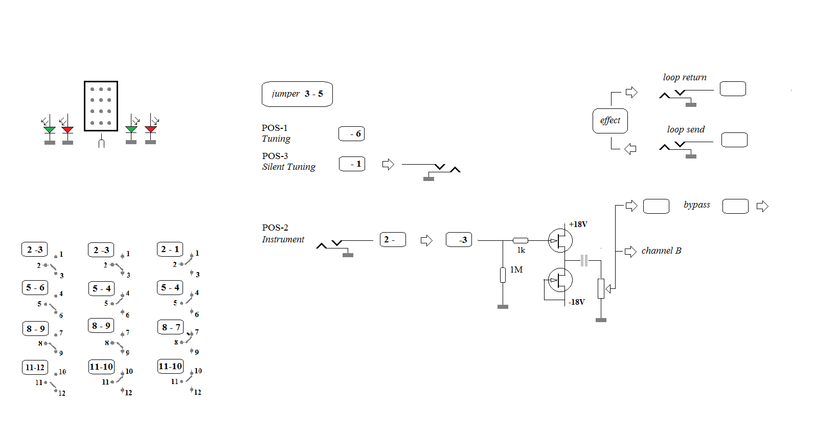

ok, regarding input switch toggle postions, I decided to change it
normal playing have to be the middle position
while playing you have both tuner positions available
tuning while playing, and silent tuning
funny how easy it suddenly becomes
I call it audible tuning and silent tuning, because thats how I will use it
but preamp bypass would probably be more correct

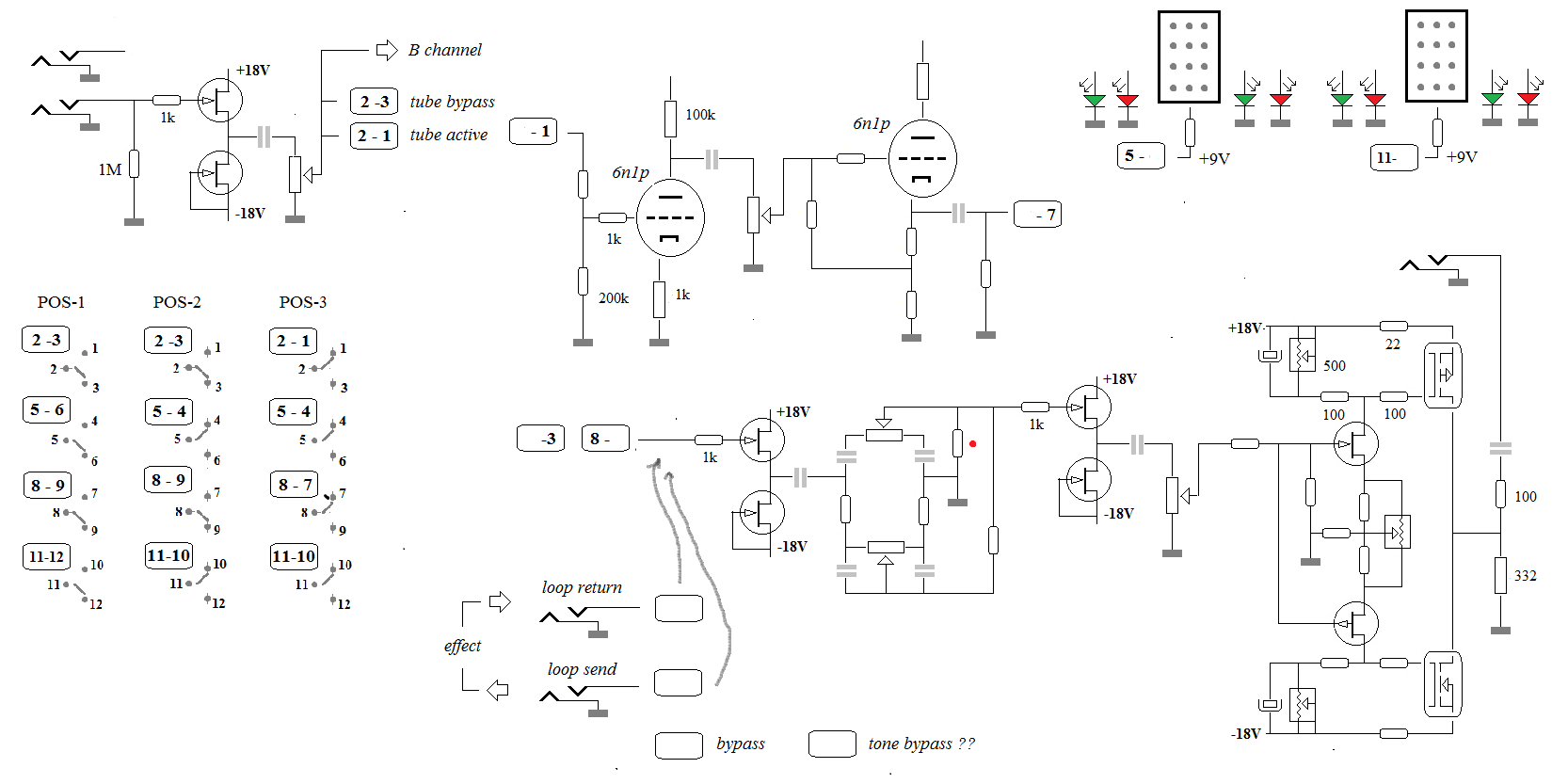

looking at the effects loop
right before the tone control curcuit might be a good place
maybe the loop swithc could also do tone bypass
but might be streching a bit too far but its tempting

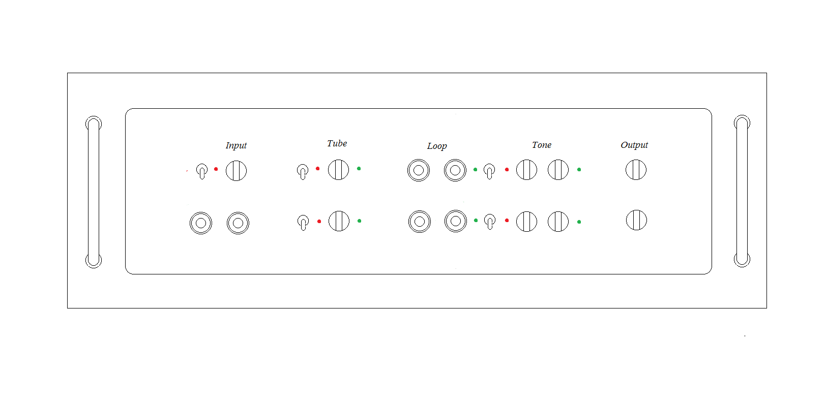

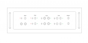

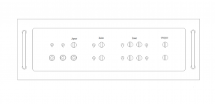

and possible front layout
getting crowded, but still doable, thanks to the LED's
if loop/bypass and tone bypass should be done with one and the same switch, then tone bypass will only work when effects loop is in bypass(off) mode
there is only 3 positions possible
but would be perfectly ok as there is no clean signal with effects anyway
hope that makes sense
now I only have to put it together, and make it work
.........work on getting all the sections running with very basic switching for now, then you can see what works best and rewire the switches if needed.
absolutely
I know the effect loop will work
having tone bypass in the same switch probably wont
and I dont think I would throw in an exstra switch just for that
tone bypass is not that important
but a few filters could be....shoot, I forgot

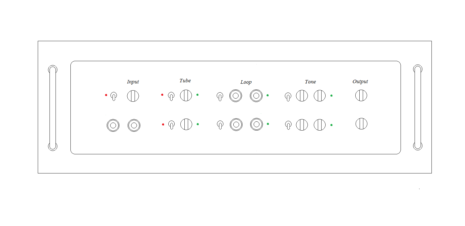

ok, I have put in a couple more switches for the tone curcuit, to prepare for any filters no more space for any further crazy ideas
I think design process is finished now
and here we go again

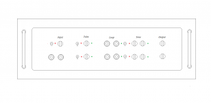

revised layout(again)
one optional effect loop, just in case
the switch also do the muting
seem to work nicely with 4PDT with ON/OFF/ON function
and should still have plenty options to play with LEDs
hmm, I have 3 option for splitting the signal
but which to use
1. just take it from a mono pot, to each channel
2. use a stereo pot
3. use two buffers
but I will still use stereo pot for that one too
more practical with only one control at input
but which to use
2. use a stereo pot
3. use two buffers

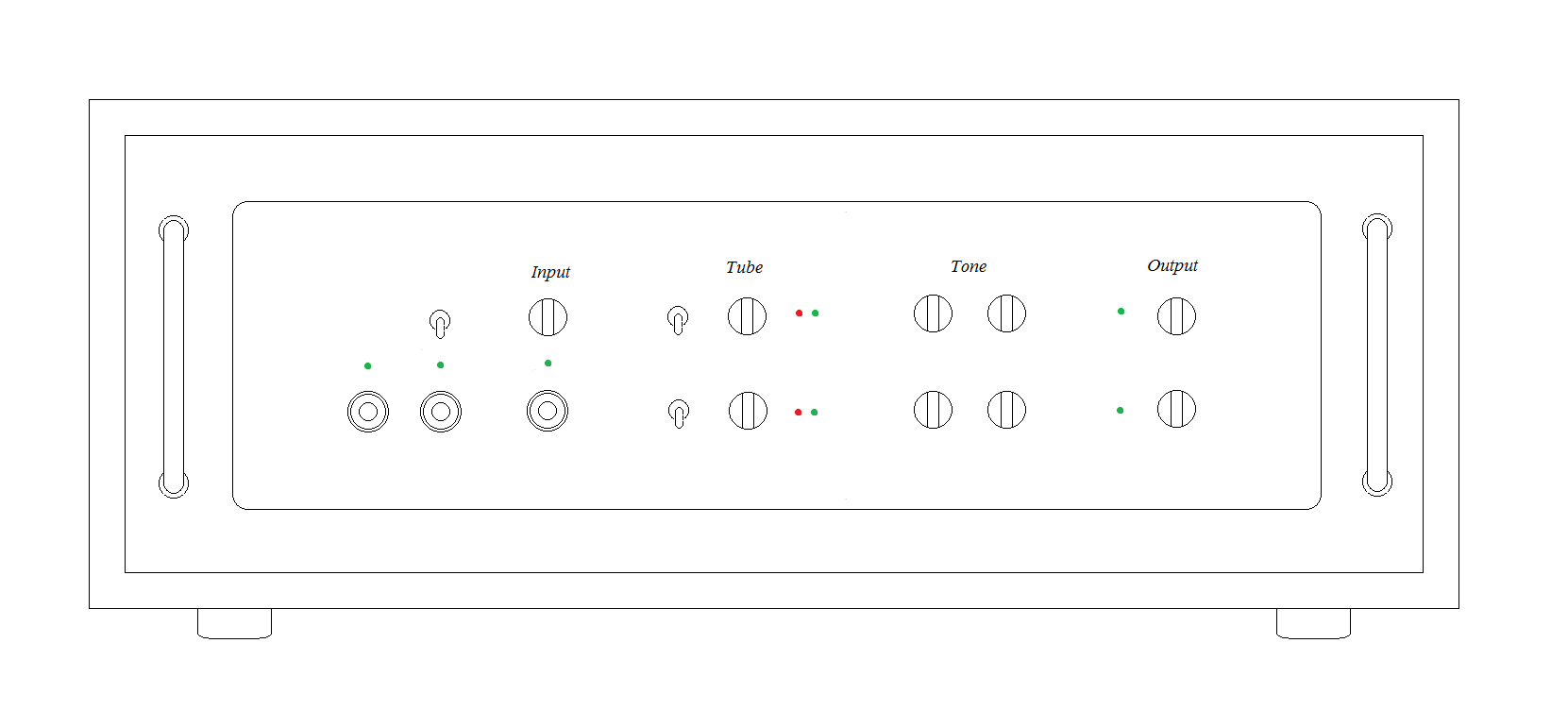

ok, I guess thats it
simpler now
LEDs
with the change to 3PDT switch with ON/OFF/ON, the mute comes natural
but I cant figure how to active a LED in that middle OFF position
but then, if the green LED goes out, I guess thats good enough
and theres a nice bonus of using same ON/OFF/ON switch for the tube curcuit bypass
in OFF position it simply mutes each channel seperately
I think this will be a nice feature to have, for several reasons
and I looked at having a red LED for the OFF function, placed close to the output att-pot
same problem again
and could be solved by having a green LED activated in both tube curcuit switch positions, where there is a signal
if the greeen LED goes out, the channel is out, muted
who wants to look at a stupid red LED doing nothing anyway
but should anyone know how to make the middle OFF position activate the red LED, I would still like to know, thanks
simpler now
LEDs
same problem again

Hi Guys
Using a center-off switch to control three LEDs is easy.
Wire the 'up' , 'down' and 'middle' LEDs with their cathodes to ground.
In series with the 'middle' LED wire two diodes. At the top of the diodes string add a resistor to the power supply. Connect the junction of the resistor and top diode to the wiper of the switch.
The 'up' contact of the switch goes to the anode of the 'up' LED.
The 'down' contact of the switch goes to the anode of the 'down' LED.
With the switch in the middle position, the middle LED is lit.
In the 'up' position', the 'up' LED is now inparallel with the 'middle' LED plus its diodes, which requires a higher turn-on voltage overall, so the 'up' LED is on and the 'middle' LED is off.
The same happens in the 'down' position with the 'down' LED.
This is called "current steering" and is explained in the Switching Methods chapter of TUT.
Have fun
Kevin O'Connor

thanks, will look at it
hey, I know its a bit confusing thread
its just one I have to let off my steam
but sure, I am trying to build this thing
