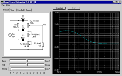

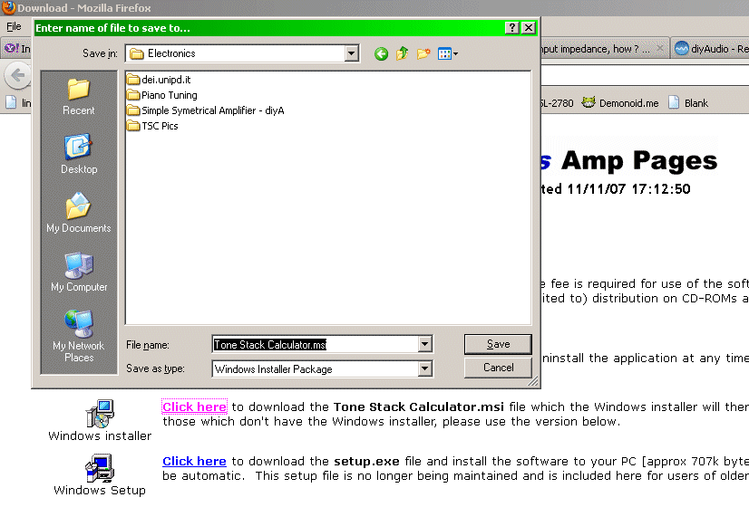

.......Tonestack Calculator from Duncan Amps. It is free and very useful for setting up different resistance and capacitance......
Hi Tinitus,

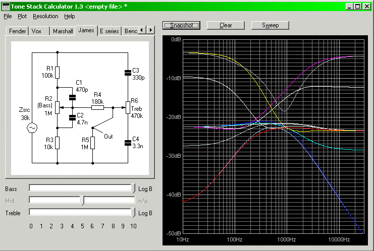

I'll second shanx in recommending TSC, in case you haven't tried it. It offers a fixed, useful set of topologies; component values can be changed easily (double-click and dialog box) and the results observed. It's also (almost too much) fun to play with.
Features
Download

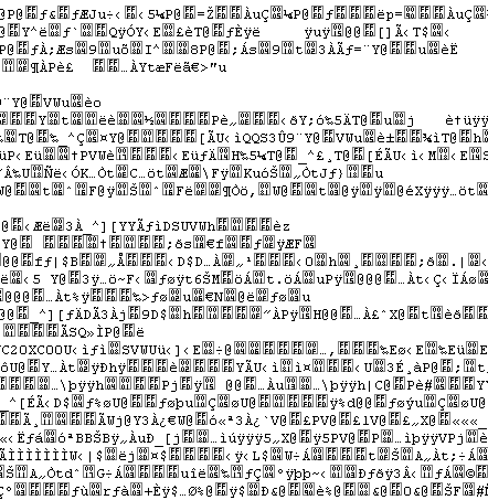

thanks
I have tried
but all I get uploaded is computer software codes

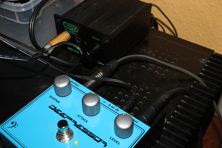

got my old Creek head amp back
and is now connected to my bass rig
it works, with some connector mods

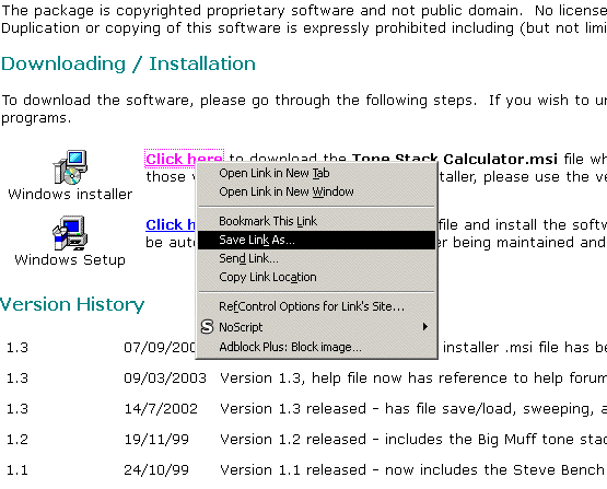

..all I get uploaded is computer software codes..
Mmm, see what you mean.....my browser does the same (? see below) if I left-click on the download link. Usually, though not always, clicking on a link to a file makes the browser ask if I want to open it or save it. Some inner mystery of http I suppose.
What works for me is this: On the download link do a right-click, which should make a context menu appear, then left-click on the "save link as" or "save file as" (whatever variation on this theme your browser gives you). This should tlet you save it to your machine. You can then run it by double clicking it - you might want to virus scan it first, just in case. Hope this helps. Nice do-the-job toolmaking earlier on btw.
thanks Simon, but I give up
managed to get it into a paint file

Creek head amp and compressor, nothing else
well, and my old LC Audio hifi stereo amp, to make it worse
the neat trick is that the head amp is only amplifying the top(midrange horn and CD)
and is adjustable
heh, it works great, best yet
and is adjustable

Hi Tinitus,
If you are having problems with tone stack, maybe you should download Tonestack Calculator from Duncan Amps. It is free and very useful for setting up different resistance and capacitance. There are a lot of styles too, fender type vox, marshall. You could ''tune'' the response curves for bass. Are you getting too much signal attenuation on your tone controls?

I'll second shanx in recommending TSC, in case you haven't tried it......It's also (almost too much) fun to play with.

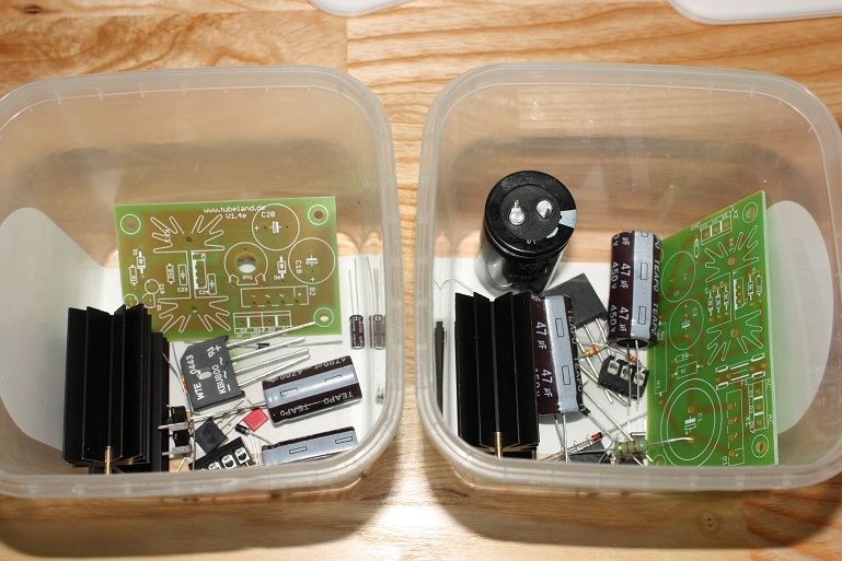

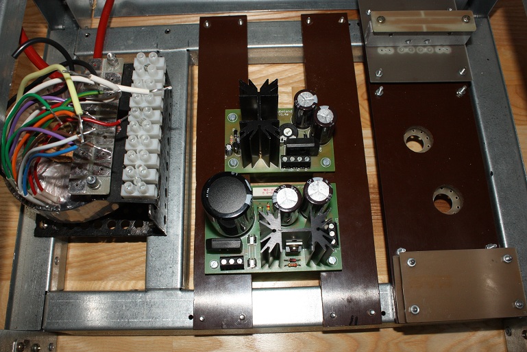

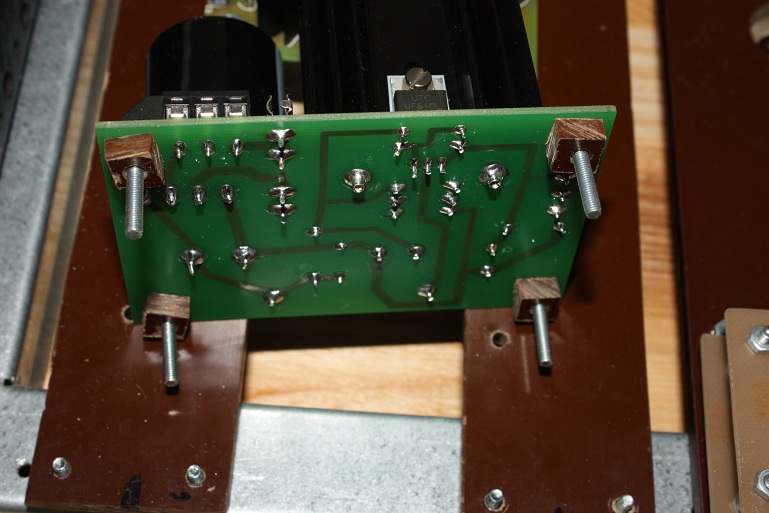

Hi Tinitus, I hope the build is going well. Did you finalize your front panel controls? or still working out the details? The PCB looks good ..too bad for the socket, but sure you will get it up and running.
the downloaded software to determine tone control plays a very important role in that part
I definately want them on the front panel now 😉

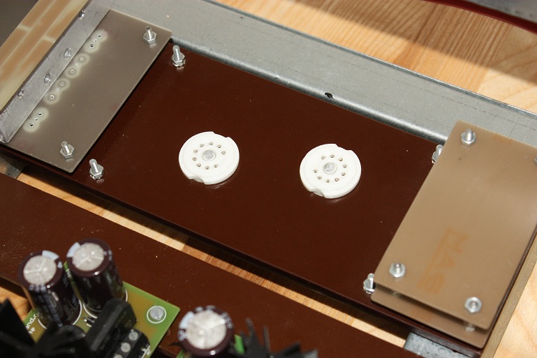

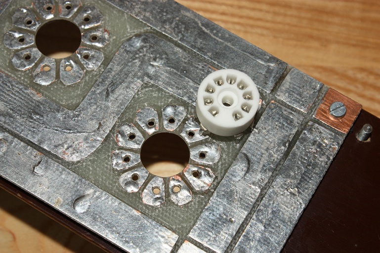

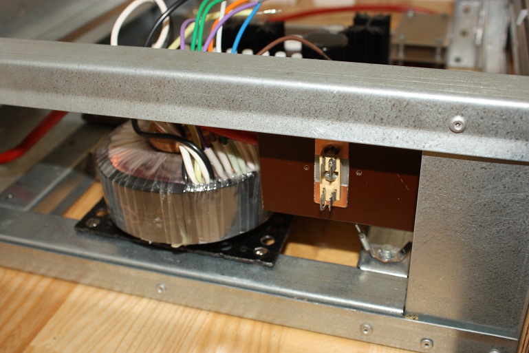

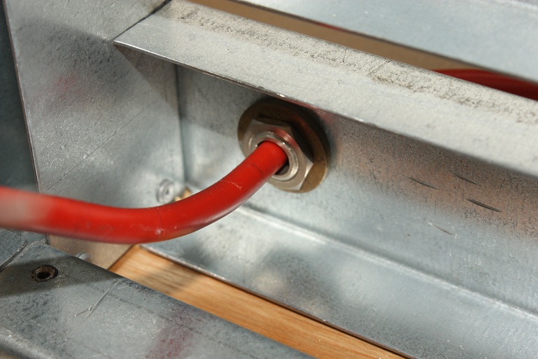

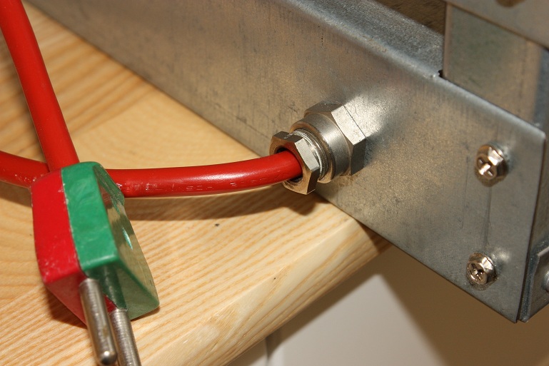

anyway, a few new pics
trying to 'exploit' the many possibilities of this kind of chassis

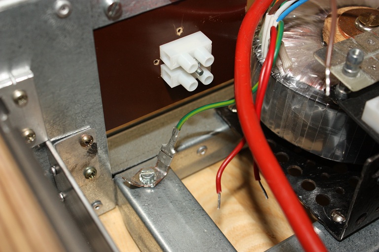

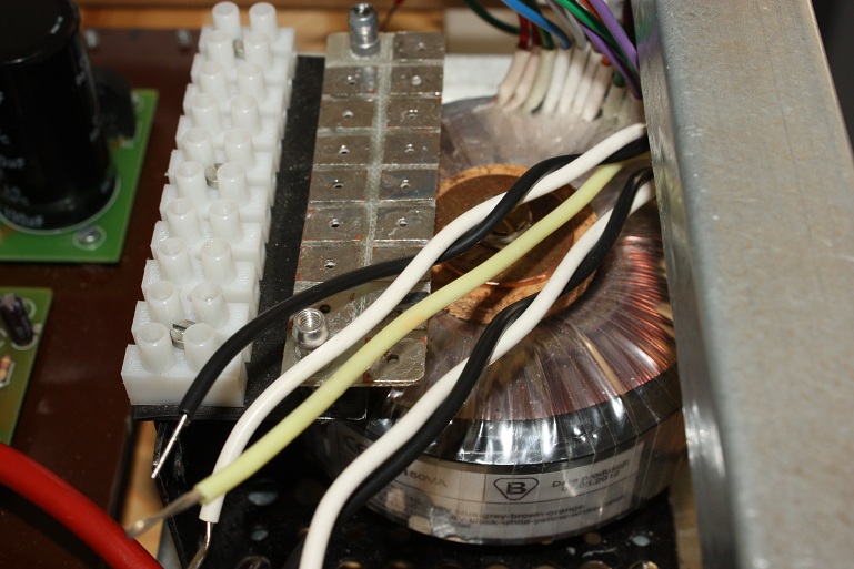

mounting mains wire, fuse holder, and trafo shield wire to chassis/ground
hmm, I suppose I can simply ground trafo CT directly
using 3,3-CT-3,3
and then connect the 0-6,3V DC from heater supply directly between pin 4 and 5
and not ground it any further
would be 'floating', and ok, yes ?
using 3,3-CT-3,3
Or create a substitute "centre-tap" with a pair of resistors, say 330R each. One to each heater connection, the junction of the two resistors to ground, or at least a signal ground via a big cap fed with a suitable voltage through a resistor if the valves whose heaters are being fed by this have Vk too high for the Vkh rating of the valve otherwise........and then connect the 0-6,3V DC from heater supply directly between pin 4 and 5 and not ground it any further would be 'floating', and ok, yes ?
Or create a substitute "centre-tap" .....
and not use the trafo CT at all ? or both ?
ah, I forget that that the CT was 'ordered' for the possible need to use
elevated heater voltage, in case of doing a mu follower etc
though some claim the artificial resistor CT is better 'balanced'
but whatever
and I just now read that elevated heater actually also does have positive effect on lowering hum 'issues' even further
but whatever
