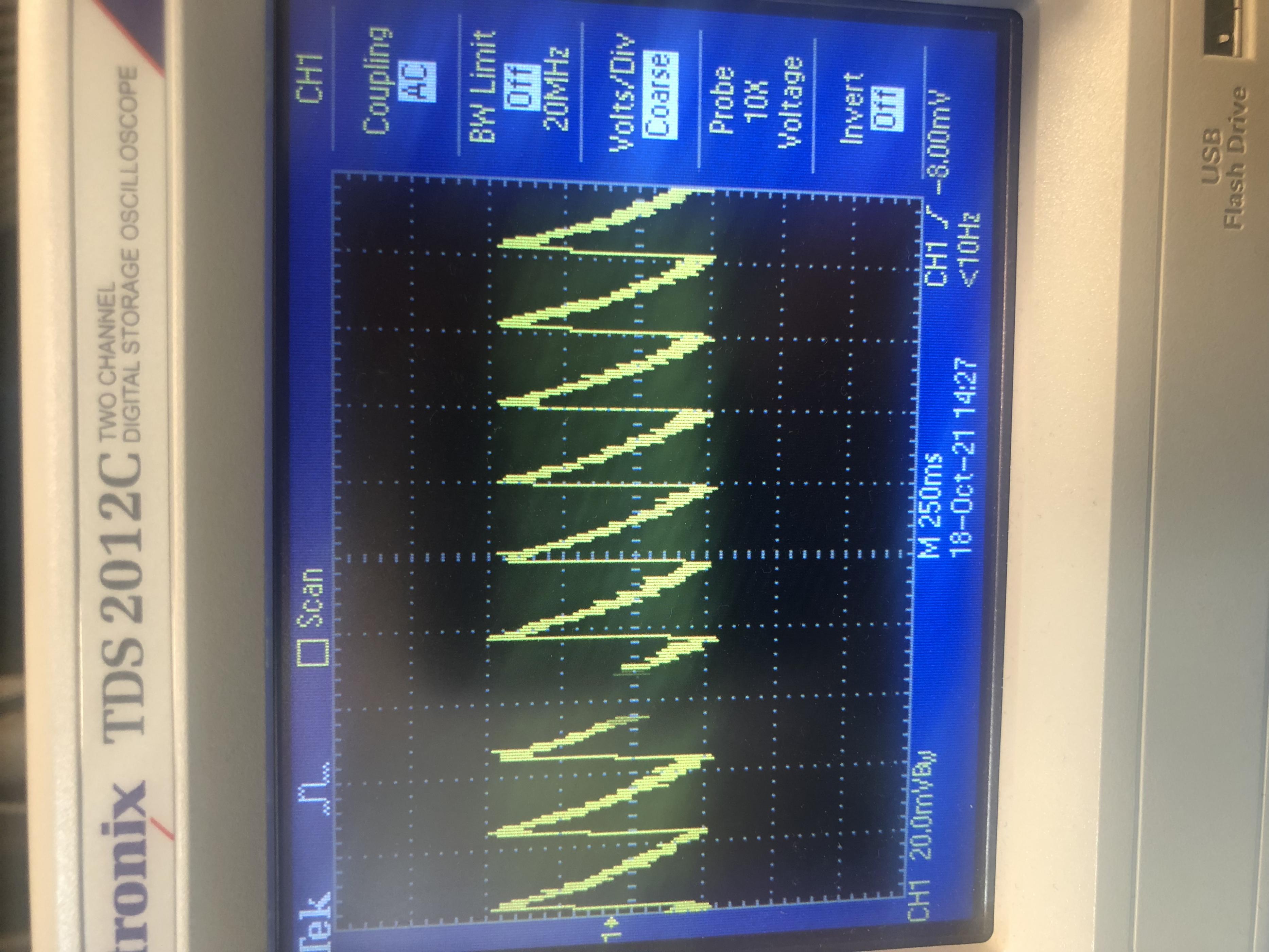

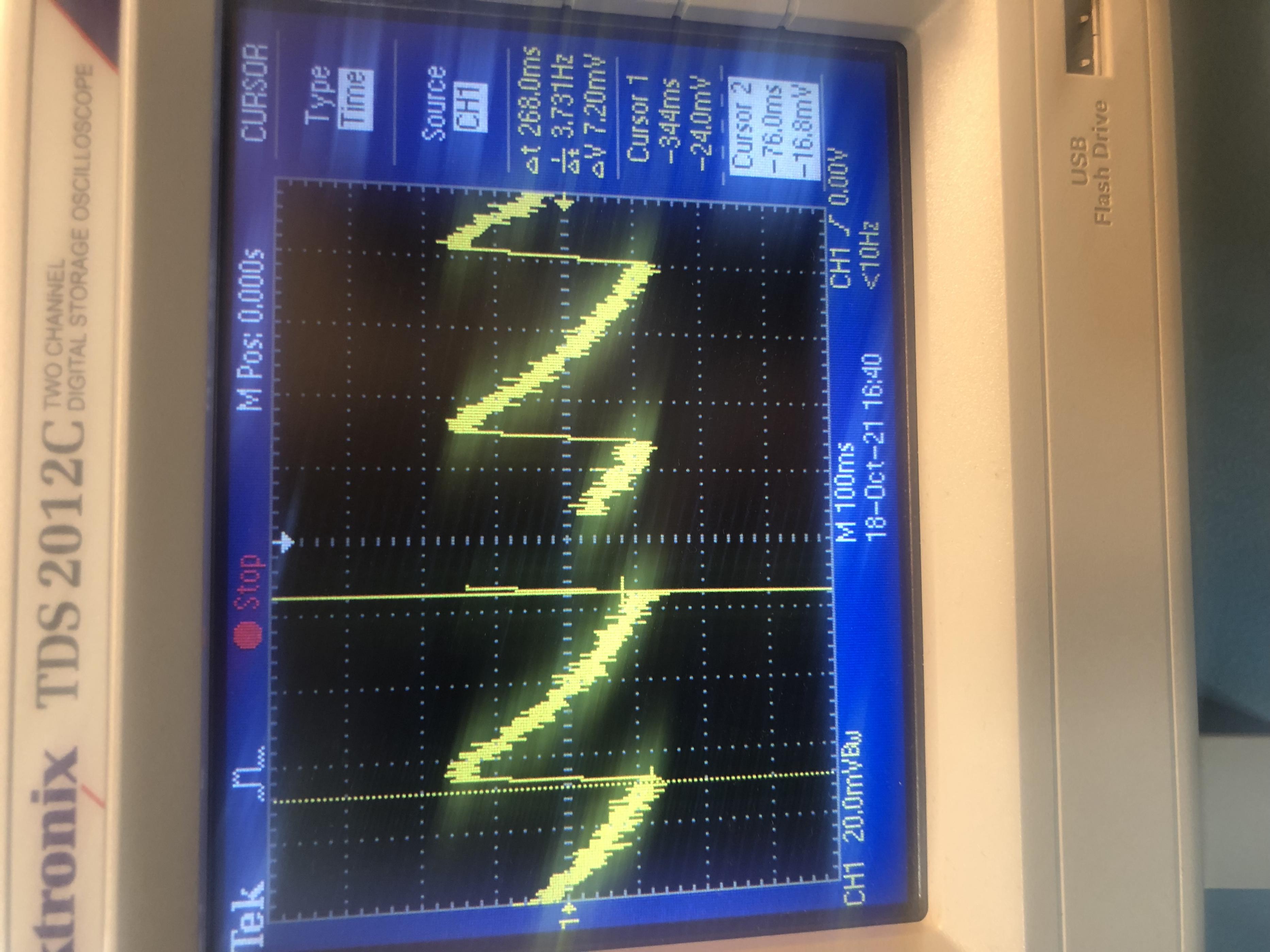

No mine haven't. but I could adjust the cursors so that it measured in x-led instead, see image.
Then it says that the frequency is around 4 Hz, but that tells me very little ...

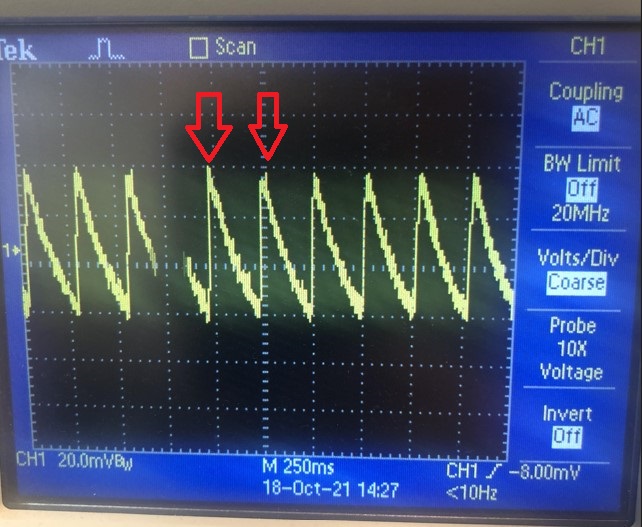

Frequency is calculated by looking at the time period of one cycle. In other words look at any point on the waveform and move along until that same point occurs again. Then read the time off the bottom axis. Normally you would know how many milliseconds or microseconds the timebase is set for per division.
To calculate you find the reciprocal (divide the time per cycle into '1')
So taken at face value you have 250ms showing at the bottom.
Is that per division???
If it were then that would be 1/0.25 which is 4Hz and that kind of agrees with the other reading of <8Hz
So those kind of frequencies would not be related to a switching supply which would be more likely in the 40kHz to 150kHz range.
So a bit of a puzzle what you measuring there.
No you are correct, I'm not sure what I measured.

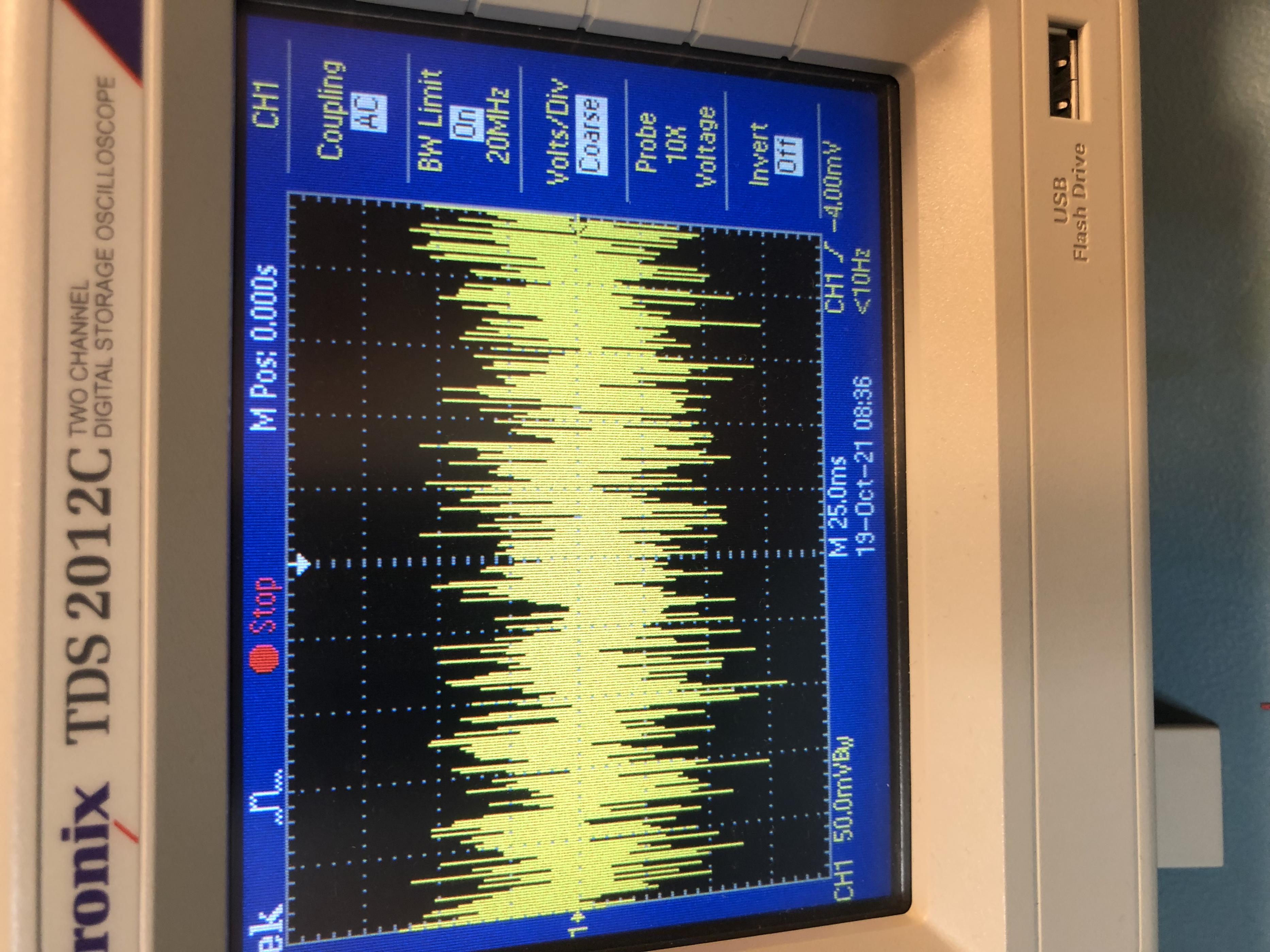

I did a new measurement which I've attached an image on. You can't say on the image but the scope showed around 2kHz when doing the measurements. Does that seem more accurate to what voltage ripple could be around?
So, I tried with new values for resistor and capacitance but I still got no improvement, only a more high frequency noise.
I'm going to try to create a LC filter instead. Hopefully that will work. Still confused though if I'm measuring the correct thing with my oscilloscope though.
Do you have any recommendations for the LC filter? For example which values of components, and so on 🙂
