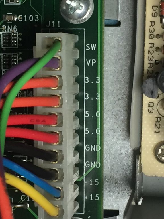

A friend of mine has a EM-U Proteus 2500 synthesizer, its internal power supply shuts off after a few minutes and then tries to turn on again. When turning back on immediately after the first shut-off, the few minutes become shorter each time. When checking the PSU output voltages after the first shut-off, they are lower than expected (+12v and -12v becomes +11.4 and -11.4v). On the pcb right next to the power input connector, it says +/-15V but the PSU only throws out +/-12V. The unit turns on just fine. I don't know if this means anything...

Any ideas?
