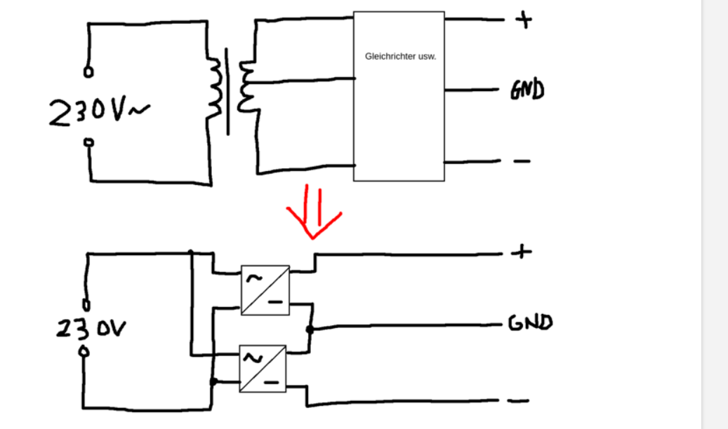

With my latest project amp (Class AB) I started with both channels running off of regular transformers and rectifiers but then switched the left channel to run off of two new economical SMPS as a test. I was expecting it to turn out to be some sort of fire extinguisher class experiment. However it seems to work fine. I am struggling to identify an audible difference. They are cheap 24V 10A 240W SMPS using TL494, drive transformer, NPN switches and regular single LC after the rectifiers. When I opened it up I was a bit surprised how old the design looked for a brand new supply. Clean and neat looking, just old technology. They have an adjustment pot and both are running at 27.6V. (Which is ok for this experiment since I have 4 Ohm speakers.)
Can anyone advise on what to listen for or look for? So far I have not noticed anything from moving back and forth between the two speakers running the two identical amps with the different power supplies.
After the first couple of days I added a second LC. The channel with the SMPS did not change as far as I can tell. And the SMPS channel still sounds like the channel with the regular transformer and 22,000uF of capacitance. My meter reads about half the AC signal on the SMPS output (relative to the old fashioned supply).
I was hoping/expecting to be able to notice something (either positive or negative) from this experiment.
You are testing in essence a DC power supply. You could try using the tip and barrel method to check the noise and ripple of the power supply output on a scope. Perhaps while it's under load (see the method described below). The tip and barrel method is used to avoid the capacitance of the ground test clip on the scope lead. The probe has to be as close to the source as possible.Can anyone advise on what to listen for or look for?
Be careful where you put that barrel of the probe though, it's connected straight to mains earth and will short any power lines directly to ground, probably destroying the DUT. Using an isolation transformer would help prevent this.
Measurements like this are tricky, the noise/ripple is small and will be affected by where you place the probe.
In reality, if both the power supplies are adequate and have comparable output voltages then you shouldn't be able to hear any difference.So far I have not noticed anything from moving back and forth between the two speakers running the two identical amps with the different power supplies.
In order to test it objectively, then using a 4, 6 or 8 Ohm power load resistor (instead of a loudspeaker), and driving the amp using test tones and sweeps, viewing on an FFT, you can check the SNR, THDN, linearity etc. Normally this is done on an audio analyzer such as AP or dScope, but you can get an idea using a standard audio interface and suitable software on a computer. You will need to take care connecting an amplifier directly to a sound-card though, some interfacing or protection for the sound-card inputs will be required (the AP can handle the higher voltage, so there is no such protection shown in their diagrams).

One thing I should point out - an SMPS generally has closed loop feedback to regulate the output voltage. Loop crossover frequency will generally be on the order of 1kHz or greater. This, and the higher refresh rate of an SMPS (>60kHz as opposed to 120 Hz), will result in less bass sag, and can enable using moderate local bypass caps at the amp PCB rather than a huge bank of filter caps.
Where as a capacitor doesnt care how much current you take from it an SMPS will. It has a current level where it will shut down.
If you configure the output regulation characteristic as constant power (it's easy to do a rough approximation of this), the output will sag rather than shut down if presented with an extreme overload. Of course you also need to properly size the power supply for the output to be delivered. For instance, if you are shooting for 100W RMS per channel, you will actually need 140 X2 or 280 watts from your power supply to handle the sine peak power.
I do this all the time, just need to make sure the ground on the mains and ground on the supply end are not connected.
Hello, do you mean the ground from the AC side with the ground on the DC side?I do this all the time, just need to make sure the ground on the mains and ground on the supply end are not connected.
Or do you mean the combined ground of the two smps power supplies with the minus rail of the DC side?
