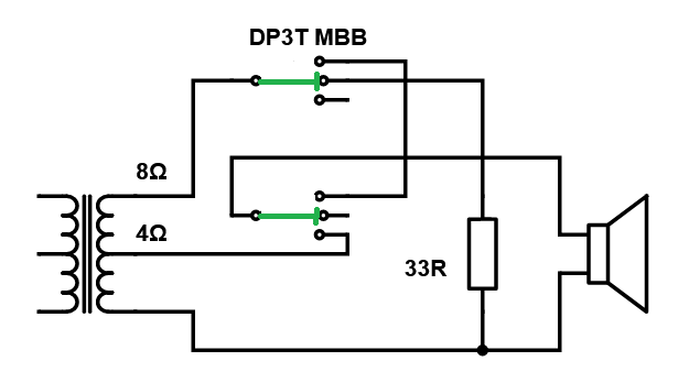

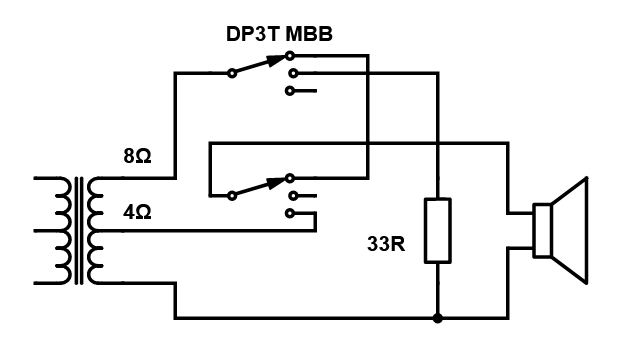

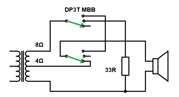

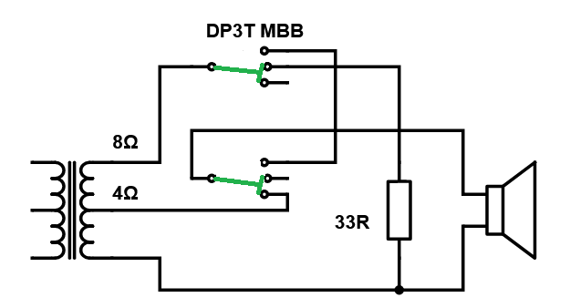

This is based on calculations by @6A3sUMMER. Not sure if 33Ω is too low, when switching from center to 4Ω tap before the contacts open, the speaker is connected to the 4Ω tap, while the 33Ω resistor is still connected to the 8Ω tap.

Since I don't change speakers much, I connect the speaker directly to the amp's output terminals. Problem with a switch is that at the low impedances involved, any contact resistance can have an effect on system performance.I have found a few threads that briefly address this issue, but they are not entirely clear. My output transformer has 3 different speaker taps for different impedance speakers. I notice that Decware sells amps with such a switch and further they recommend switching the impedance "on the fly" to see which sounds better with any set of speakers. Is it as simple as using a make before break switch? The threads I have seen appear to make the issue much more complicated, but they all seem to be using break before make switches. Can anyone give me assurance that a make before break switch on its own is sufficient? Or tell me what I need to do to make it safe to switch output taps "on the fly"?
Thanks for any suggestions.
No, When switching from center to 4Ω tap before the contacts open, the speaker is connected to the 4Ω tap, while the 33Ω resistor is still connected to the 8Ω tap.A potential problem, as you go from center to 4 ohm aren’t you temporarily shorting the 8 and 4 ohm taps?
Center position
Make-before-break
4Ω position
