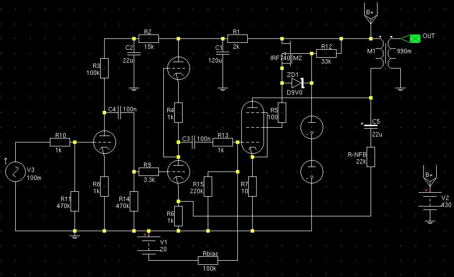

Hi and congrats, I have the GU50 version but the principle is the same. It's a re-design though:
http://www.diyaudio.com/forums/tubes-valves/163459-trying-make-sense-sweet-peach-17.html#post2273390
You can't just reconnect the output tube in pentode mode, the bias changes dramatically (and for the better!) and the output impedance drops.
My new circuit uses pentode mode for power and gain, and has high linearity without loop feedback going across the output transformer. This is achieved by having a very low impedance drive from the output stage. A good alternate would also be Schade feedback here.

That's a great amp you made, how did you manage to get Edcor transformers in the UK? That's an issue that has puzzled me for ages!
The Peach has an inductor for the PSU already which is neat.
As it is it's fairly nice once you replace the coupling capacitors.
The weaknesses are the 6N3 input tubes (of which only half gets used) and the driver tube circuit design. I used a Mullard ECC82 in there (re-wired heater) that sounded good, the ECC82 is an ideal tube for the voltages and currents at that point, but not as linear as some.
For a redesign you have much scope but many compromises. For me the factors I needed were:
1) Pentode mode - full power and easy to drive
2) No feedback over the OPT
These two fundamental requirements led to the design I posted up. The reason for taking the OPT out of the feedback loop are:
a) It adds phase shift and non-linearity
b) At frequency extremes the loss is so high NFB fails anyway
c) It will work as designed anyway with a low impedance drive
so this leads to needing a low impedance output from an easy to drive pentode, something usually associated with a mosfet 😉
So I used a very tight feedback loop between the output tube and the driver tube, the whole thing being driven by an SRPP with 6N2P (high gain ECC83 equivalents) tubes.
As noted above perhaps a better design would be to load the SRPP (to reduce distortion to optimal design levels - SRPP works best into one load resistance) and then to mix that output with the output tube anode like the Schade feedback design. As it is I have a 22uF feedback capacitor - not ideal but it is bypassed, and it gives the driver feedback (not just the output tube) - thus lowering the impedance driving the OPT.
People think SRPP stages are a trendy fad, but having worked with them I view them differently. I view them as resistor free (the top tube sinks that heat), capable of driving difficult loads with huge voltage swing, and tweakable as required to very low distortions (by resistor loading). It was also the only topology that really opened out the dynamics of my SE, perhaps because of that potential to drive a big voltage swing.
I'm sure people listening to my Peach would swear it could not be a single ended amp, the terrific bass, dynamic power is larger than you'd think possible. Of course the total smoothness in the silky midrange may give it away. Anyone near Cambridge England PM me if you fancy a listen!
