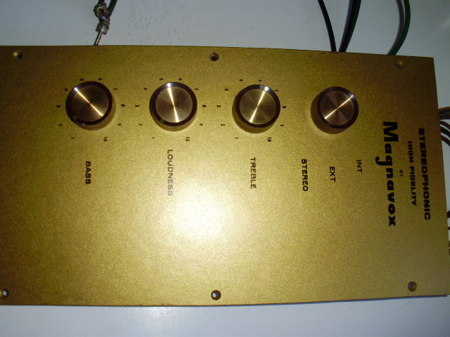

Here's the question,,, I was thinking of making the 2 channel Maggy a stand alone amp, and putting the Motorola amp in the Maggy cabinet,,, How can I convert the Maggy controls to the Motorola amp? I figured I could hook mids and tweeters to the Motorola L-R channels/speakers and the 15" low range speakers to the third, bass channel, with a separate VC for the bass channel....

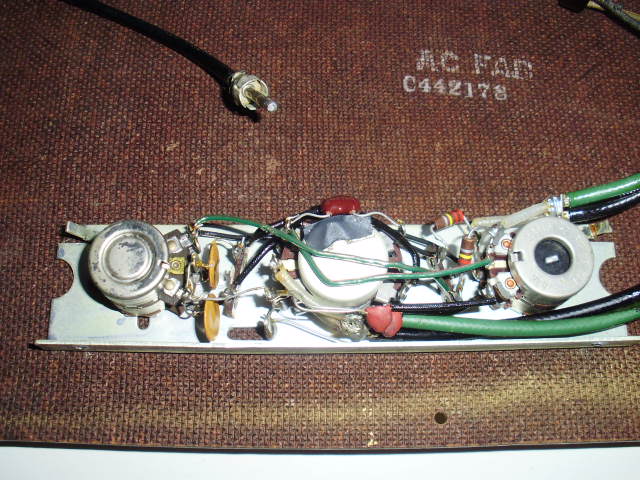

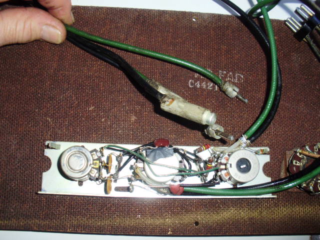

Isn't this a passive preamp?? It plugs into the Maggy chassis,,,,
Sure looks like it. HOWEVER, I see nasty ceramic caps. and other music killing stuff. You can try that "kludge", but ... I strongly suggest you simply buy a pair of inexpensive 10 KOhm log. taper pots. from either Mouser or "Rat Shack". Use those parts to control the volume/balance of the signal originating at a CDP. Add additional resistance in the "hot" lines leading to the controls, if a "hair trigger" condition rears its ugly head.
