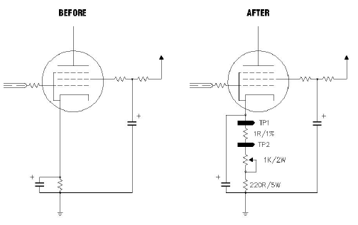

Yup, it looks like a Chinese-made hi-fi amp, so unless you want to drill some holes and install more parts, it might be easier to drive it with a preamp with tone control. I don't think you want to overdrive the output stage to get more "crunch" which is a term commonly used when talking about guitar amps.
But if you are good with DIY, you can try the variable bias scheme as shown below, which allows you to set the bias for the output tubes accordingly:
