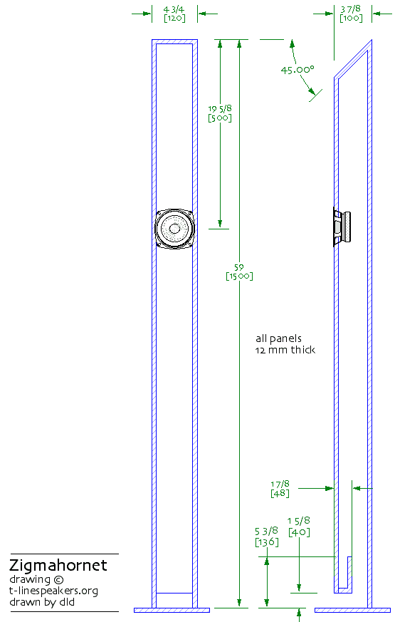

If you feel like trying a TQWT; I'd say go for it with the HPD; my guess is that they'd be a better match than the earlier types. I'm limited for space, which is why I didn't pursue it with much vigour using my Golds, nor did I tune the dimensions properly using Martin's MathCad sheets as I was just fooling around for a bit of fun -I just went with a So=Sd, Sm=4Sd which I use as a starting point for most TQWT projects as per Bob's suggestions for a generic starting point with suitable drivers. It worked; the sound was huge, I'll give it that, and you could tell there was some potential there, but you really do need that 8' height if it's to be a straight pipe. A folded cabinet might be a better bet, but it would end up being seriously (i.e. large horn) deep.

Using them in a TQWT would be interesting I think, but I'd probably go for a folded pipe instead the tall one. Or I might end up with the biggest and tallest Zigmahornet on the planet.. he he.
