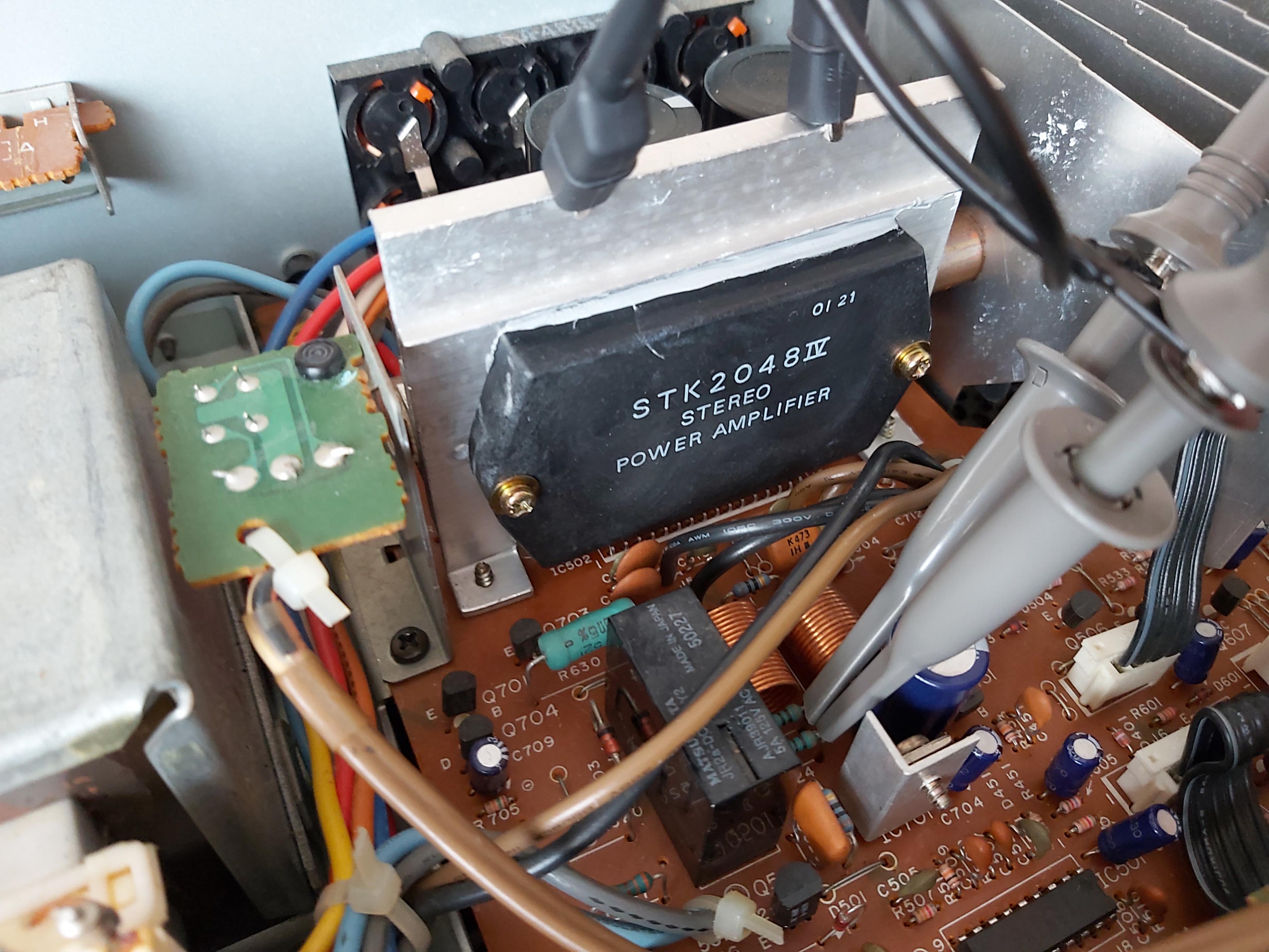

Got another Technics amp to play with a failed STK2048IV. I wonder what that one will do 🙂
I know the 2048IV well.... much better setup 2ch DPP (Often faults are with pre drive transistors (2SA1123/2SC2631) or dry joints on them (often on a daughter board w/ AN7062)
Looks like the 3206D you got was used (probably cooked before pulled out of previous unit)
At least my 2048IV actually worked and listening to it as I type 🙂

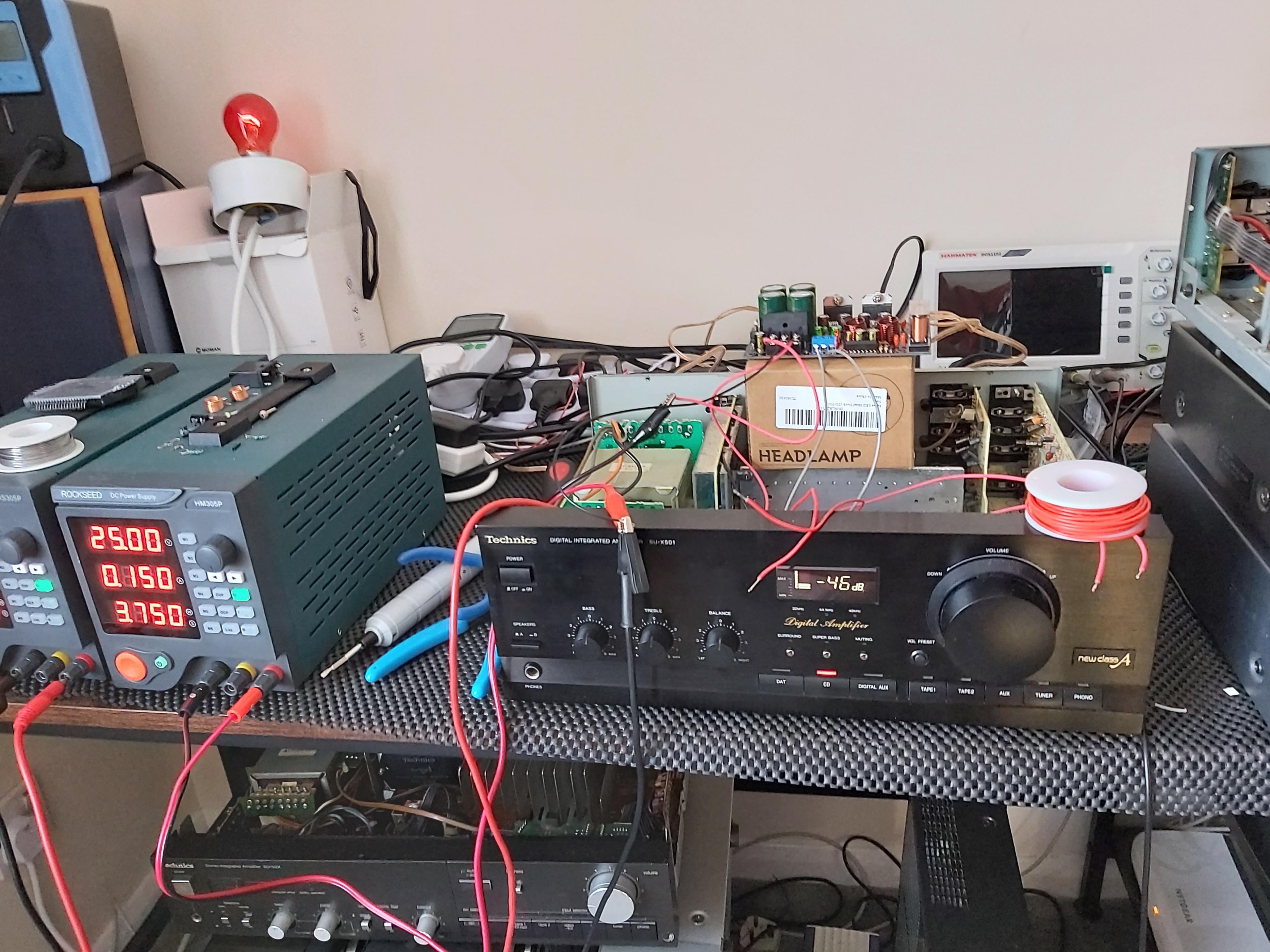

Back to my sick amp...
I got my refund and just got a used SVI3205 (removed from another Technics amp).
I also made myself one of those dim bulb gadgets with a 60W lamp.

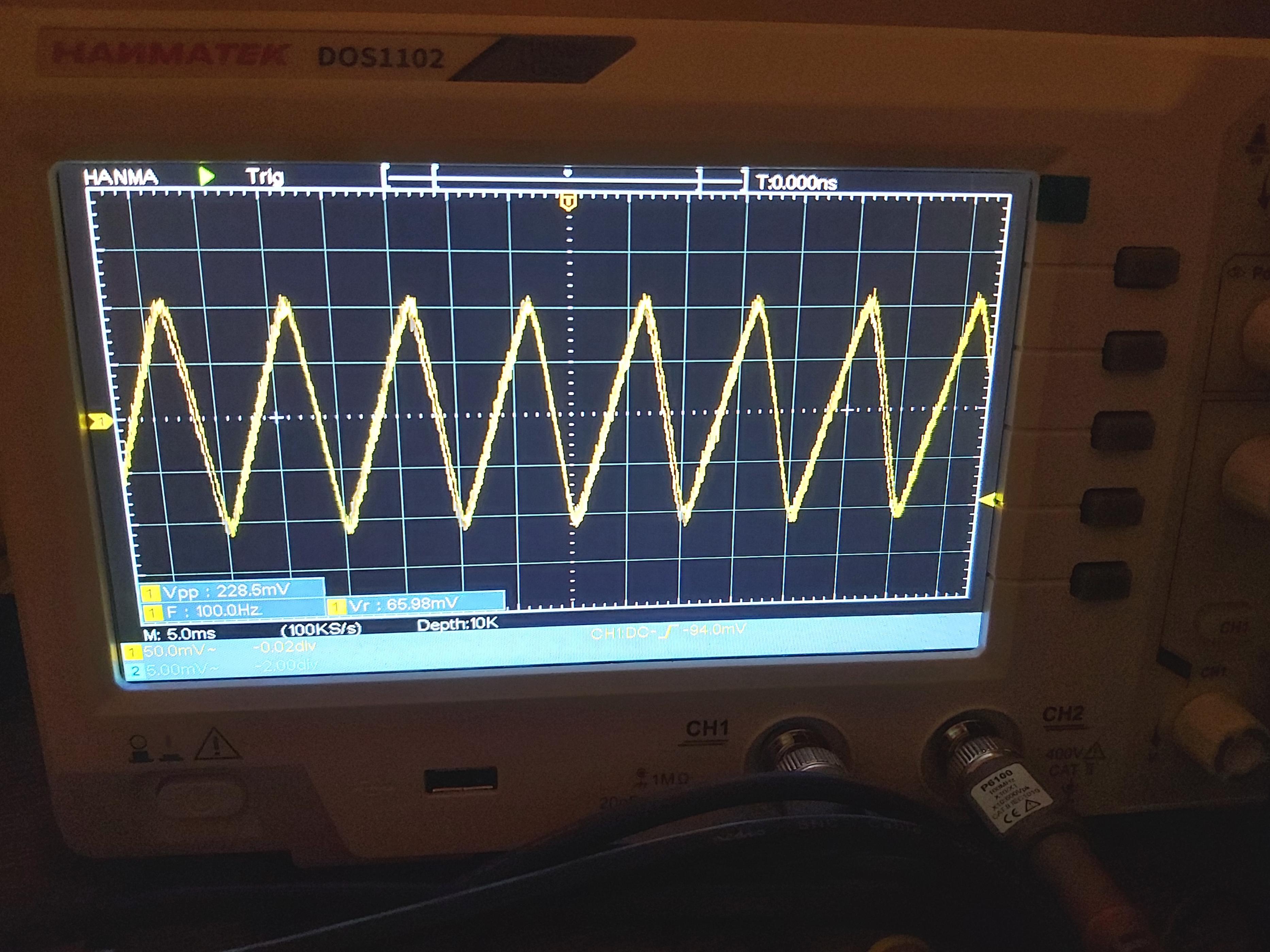

Anyway, it powers up, display works, protection relay operates but also now the fan runs.
On the output inductors I am getting a perfect 100Hz sine wave.
On R525 440mV PtoP and on the other channel R526 222mV PtoP.
SU-X501
No input signal and checking the main supply rails with a voltmeter on AC no apparent voltage.
Is this because the dim bulb is messing up the other power supply rails or something else?

Tried it without the dim lamp and no better. As soon as the protection relay operates the fan starts and still 100hz sine wave on output.
+14.8 volt rail shows no AC but -15v has 50mV of AC voltage.

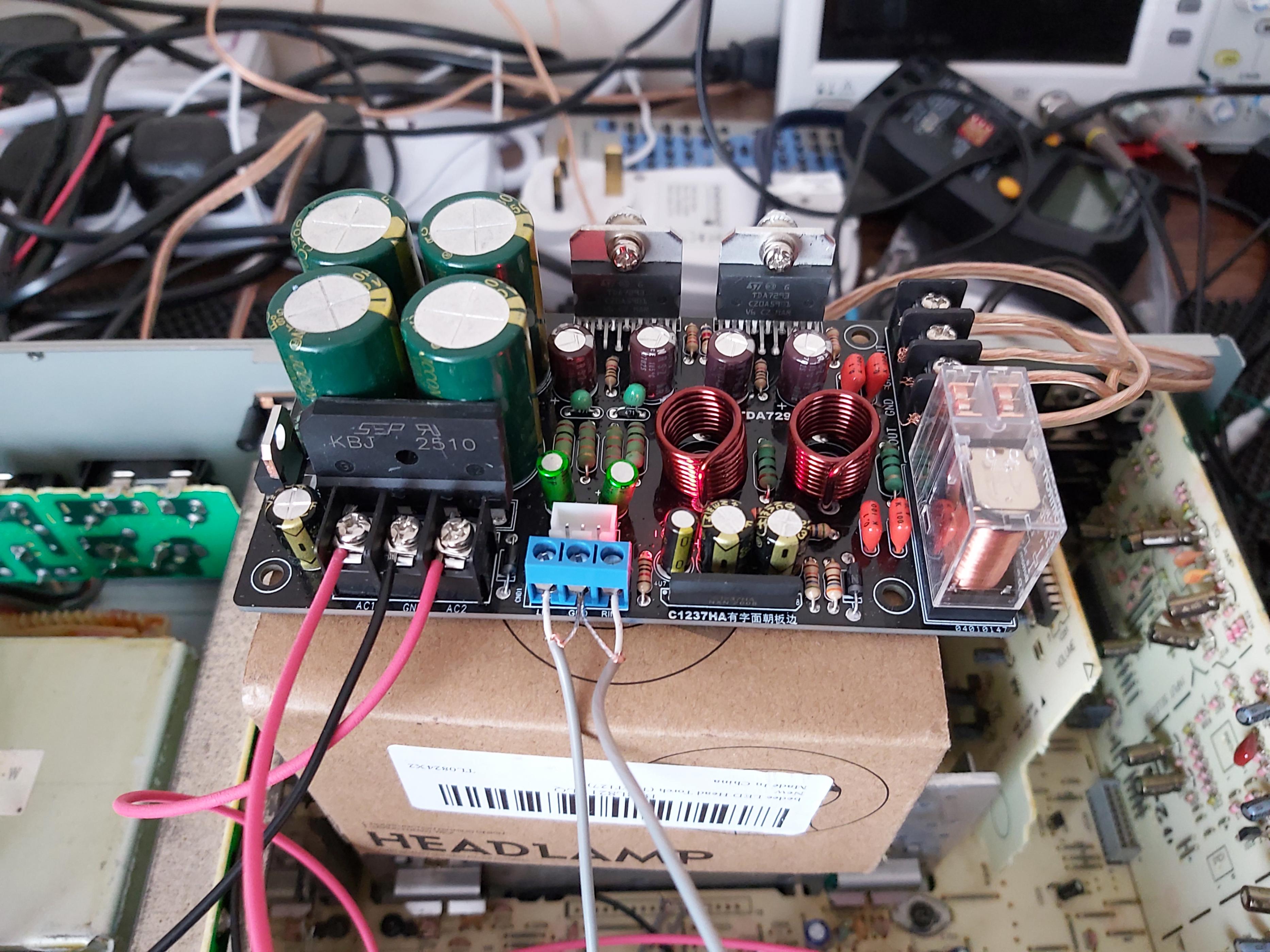

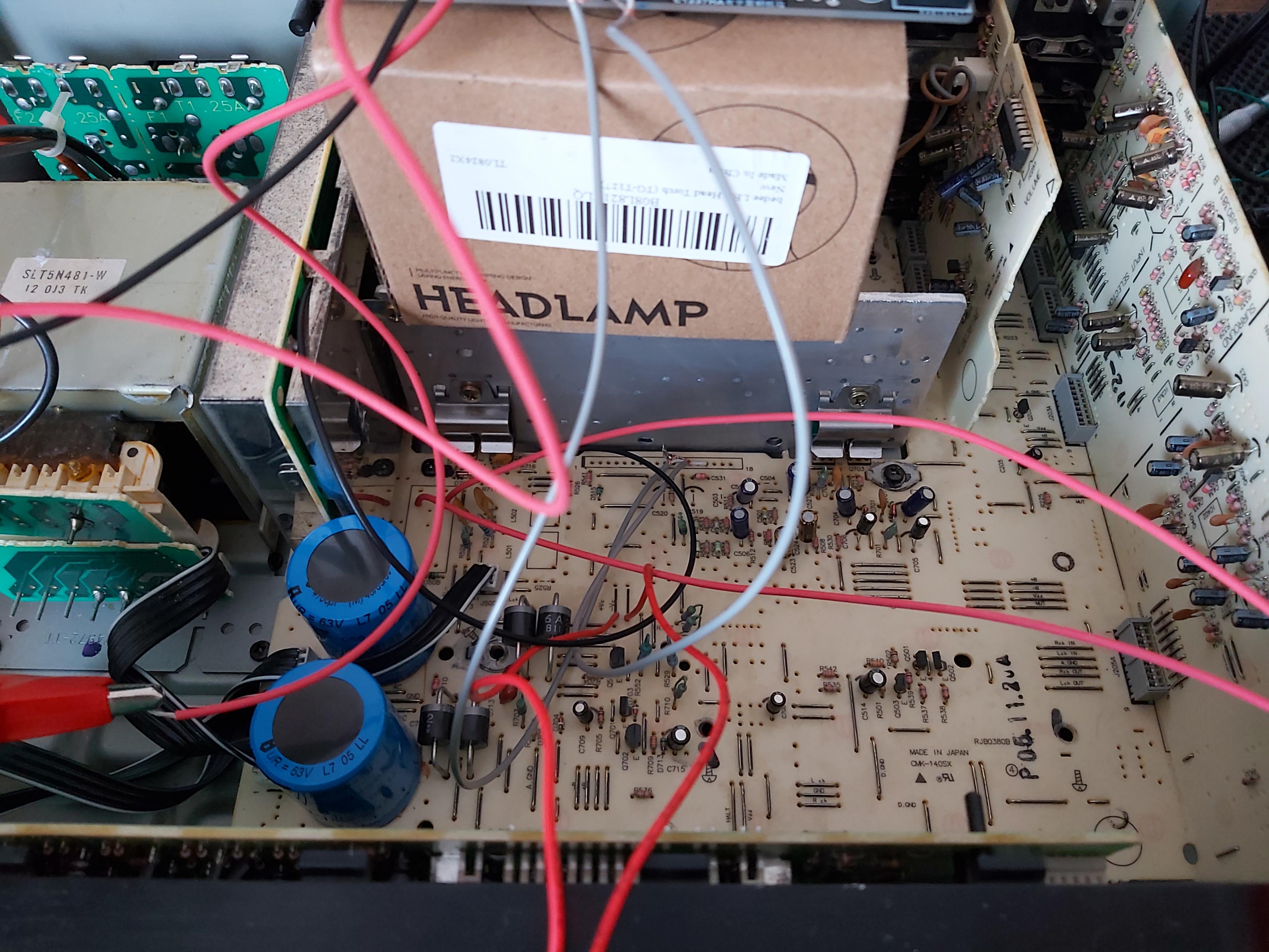

I can only assume I have yet another duff module and thus plan 2, try and replace the module with a modern alternative.
And yes, it works 🙂 The heat sink In the amplifier will need some work and the fan should still work as it seems to be controlled by speaker voltage on this model.
The module uses 2 x TD7293 amplifier chips and includes speaker protection.
As you can imagine, there must be a lot of people in your shoes 🙂
Can you share any kind of schematics or better, a project detail on your work? That would be of extreme value!
