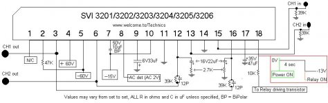

My old Technics amplifier went dead. I suspected the power IC SVI3205 may blown.
How can I determine?

However, I can only found the chip diagram from the following website but no resistance value found:
http://www.geocities.com/technicshifi/SVI3206.jpg
Could someone kindly provide me the resistance value I want?

Dear Sakis,
Thanks very much for your information.
I had performed voltage test on the IC pins. From the diagram found on the net, the output pin should be pin 3 and pin 6.
On pin 3, I got 0V but in pin 6, it was 51.3V.
Also, the diagram shown pin 18 should have 0 to 13V within 4 sec. The test result is only keep -0.1V even held longer than 4sec.
I think the chip was already GONE.
Now I have to look for the replacement, but it is hardly to find on the net.
Thanks again for your help.

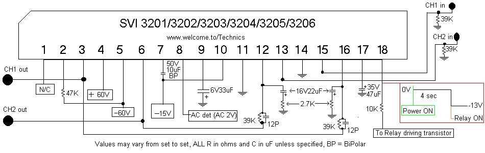

I have a Technics eBay amp SU-X501 with the SVI3204 chip.
No sound.
Protection relay operation okay
Audio input signal on pin 13 and 15 (checked with scope)
Only a few millivolts on the output pins 3 and 6
Most voltages are correct but only -0.027v on pin2 and pin9 -4v
I can't find and information on what those pins do and was wondering if the module is in mute rather than failed.
Is failure like this also normal?
Anyone got a diagram with Information on what all connections to this are for?

Many thanks but alas like many of the drawings it does not say what all the pins do.
Pin 2 and Pin 9 seem to be a mystery 🙂

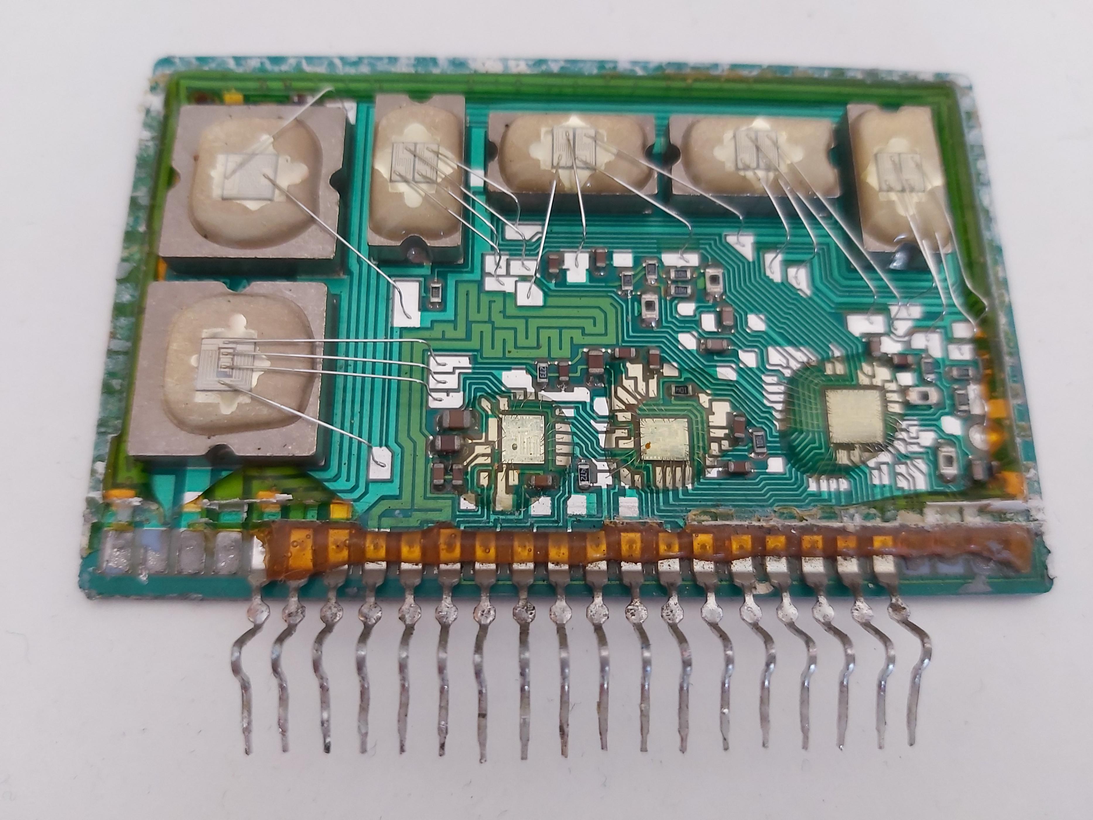

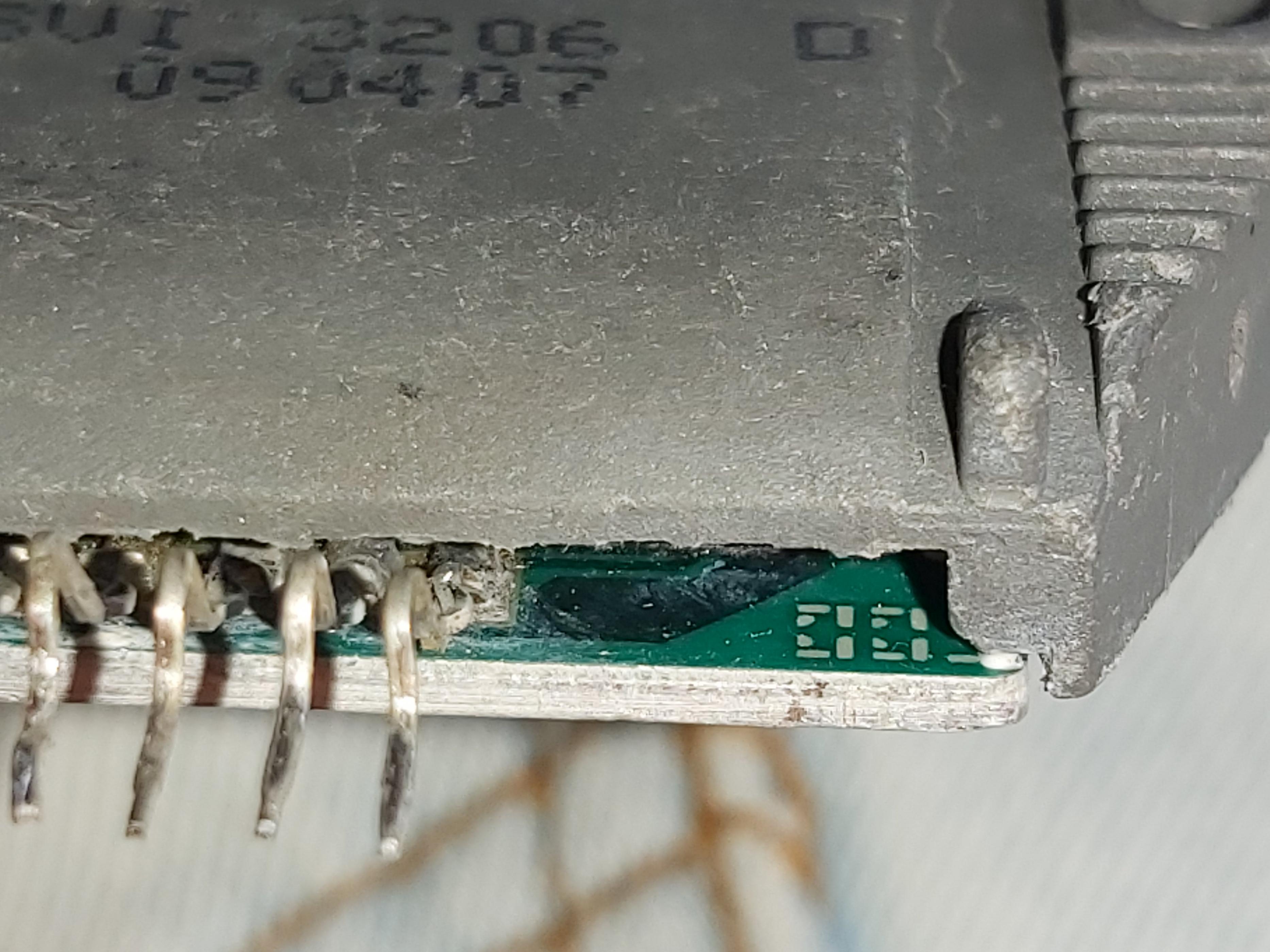

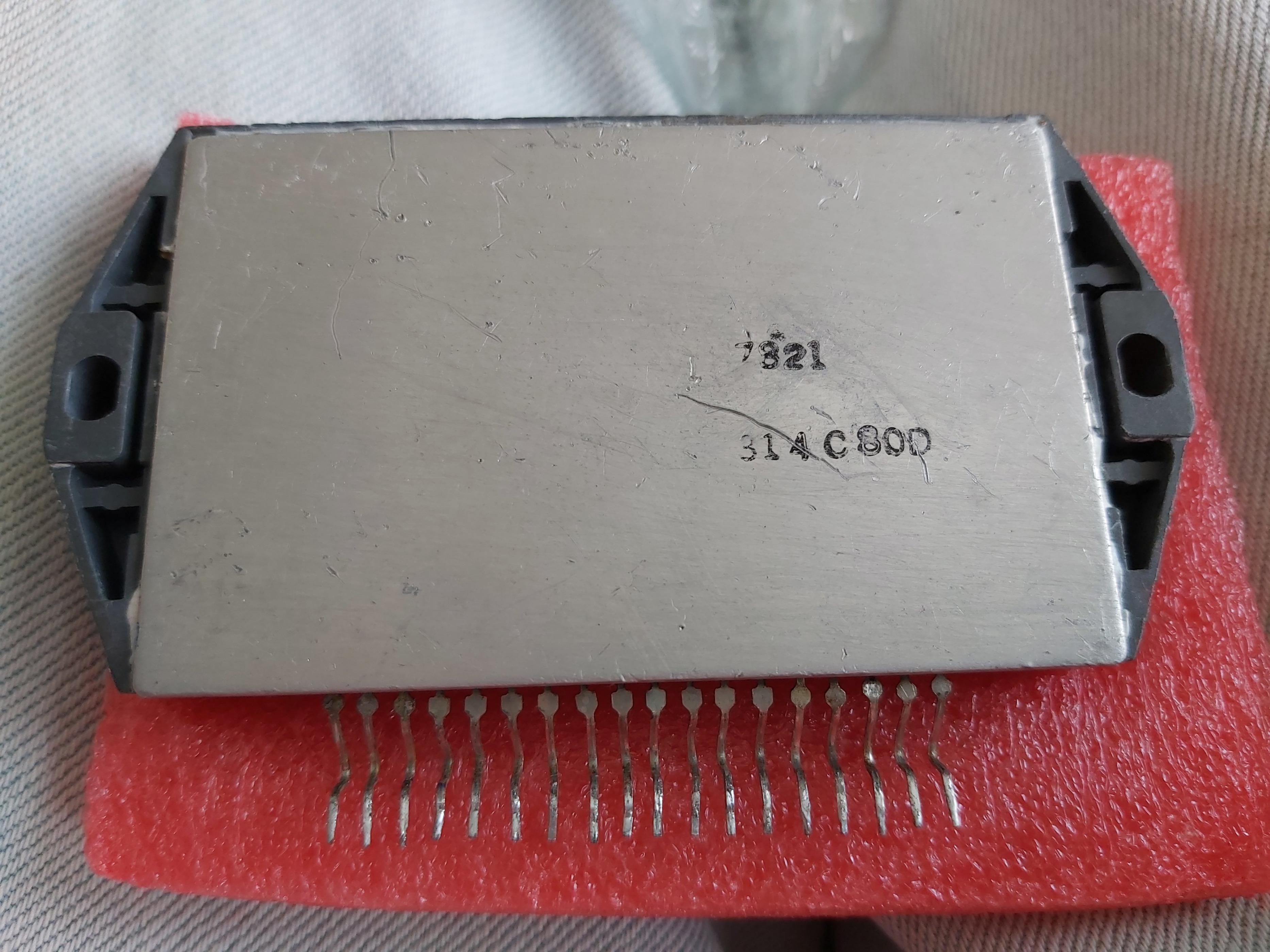

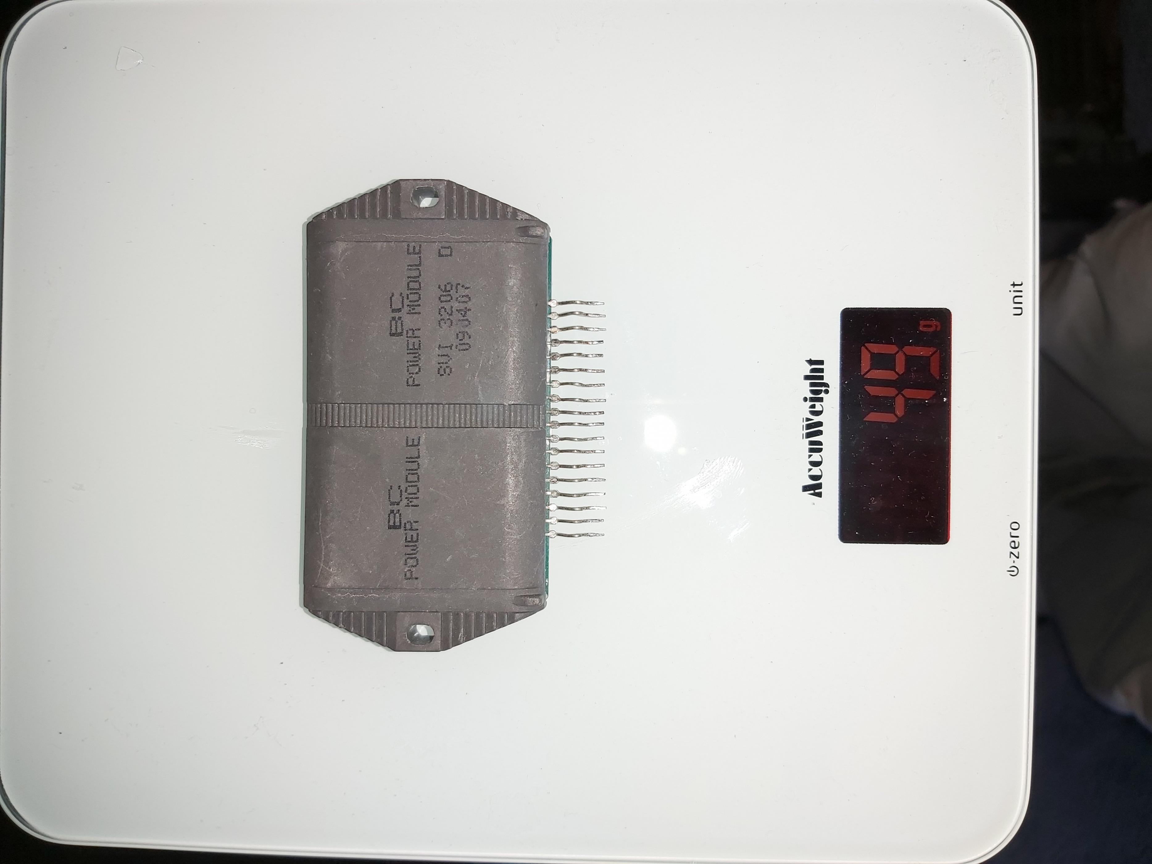

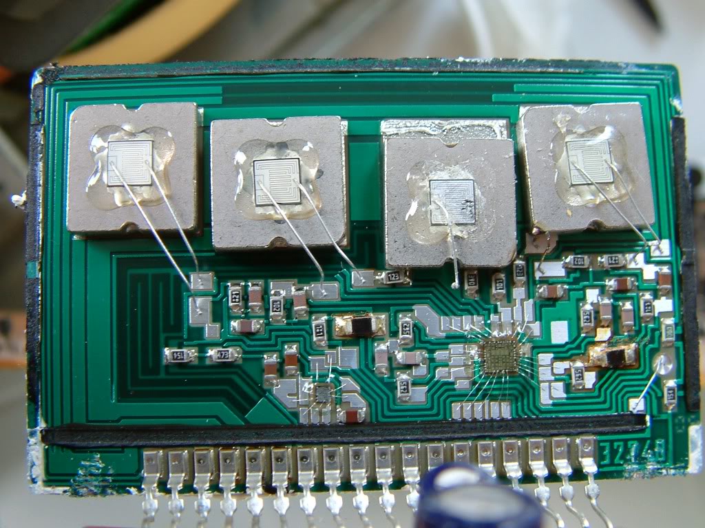

Back in February I ordered a SVI3204 which finally arrived (actually a SVI3204B).
Fitted it an powered on and much as I expected it did not work and actually smoked from the top right side.
When removing the old module the cover fell off which revealed the internals and it looks like similar pictures of the device.

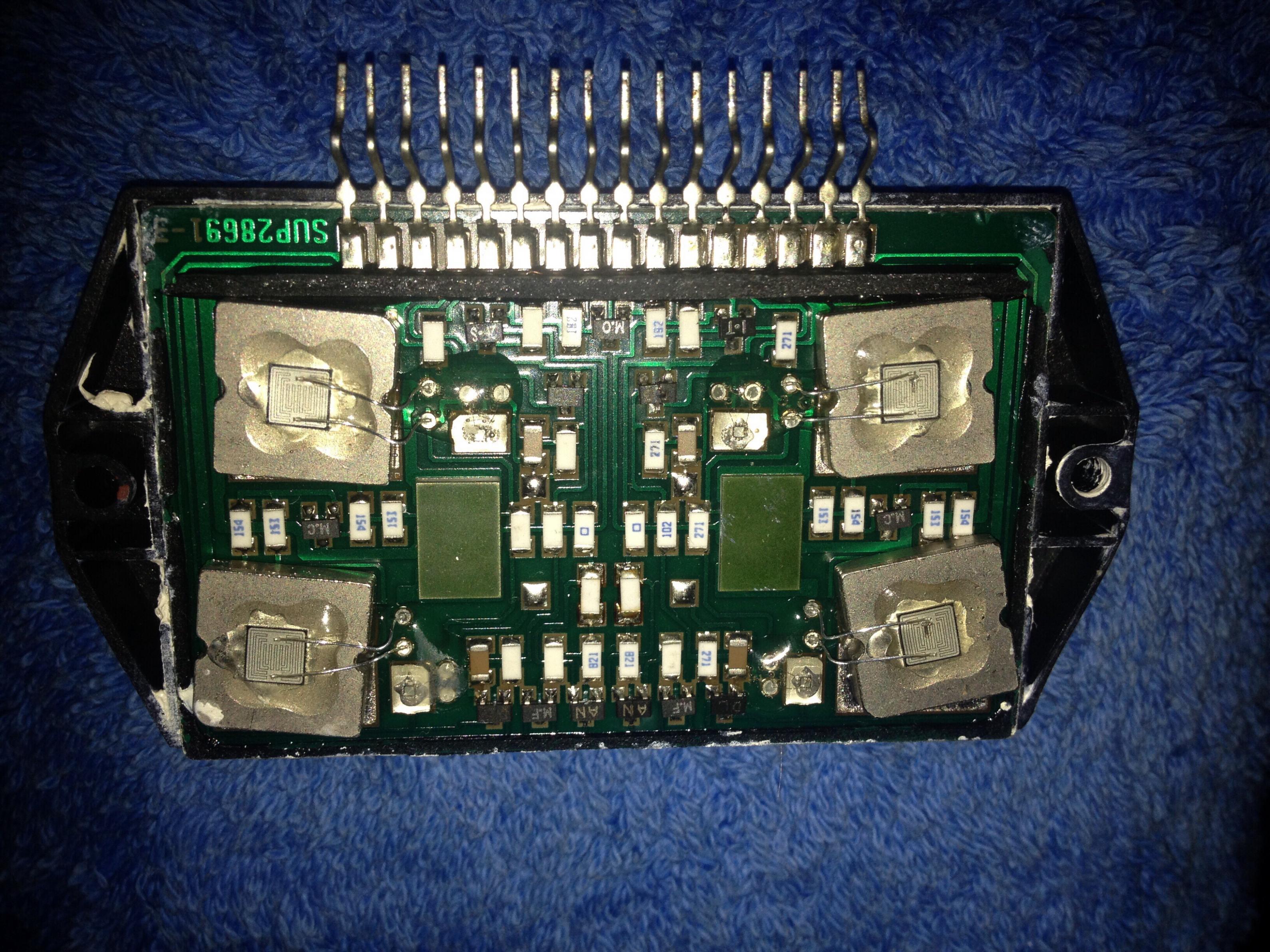

Got the cover of my new SVI3204D and it is very different inside.
3 X small IC's 6 X big devices, two square and four rectangular shape and five of them with four wire connections on front.
On removal I also noted the back heat sink surface was not flat as no compound I put on the device was left on the amplifier heat sink.
Should a SVI3204B have worked? Is it just best to skip any amplifier that needs a new one of these modules?
Seems likely that IM35461 got a fake IC replacement.
Because technics/matsushita has stopped manufacturing them years ago.
Also, the regulators mounted on the heatsink and their associated parts should be thoroughly checked, regulator outputs re-soldered, etc., because the SVI chip relies on those for proper operation.
If that was not done, and there was faults with them, then no SVI is going to work properly.

IM35461
The 2SA on Lch had burnt out, and likely has gone open.
Unbelievably some putrid turd had de pinned a Class H+ RSN module And popped a 3204 cover on it.....
IM35461
You're good.
How can you tell?
I've never opened up one of those SVI chips, when they went bad, I'd simply replace them. (with original Technics stock)
I remember way back then, they cost $30-60, but that was charged to the customer of cource.
Matter of fact, my own receiver uses a SVI3205 chip (60/60w), but with fan mods, replaced caps, I'm not worried.
Indeed, found a YouTube video showing the provided fake chips real identity.
No wonder my amp did not like it.
RSN309w44 inside hybrid ic matsushita - YouTube
You're good.
How can you tell?

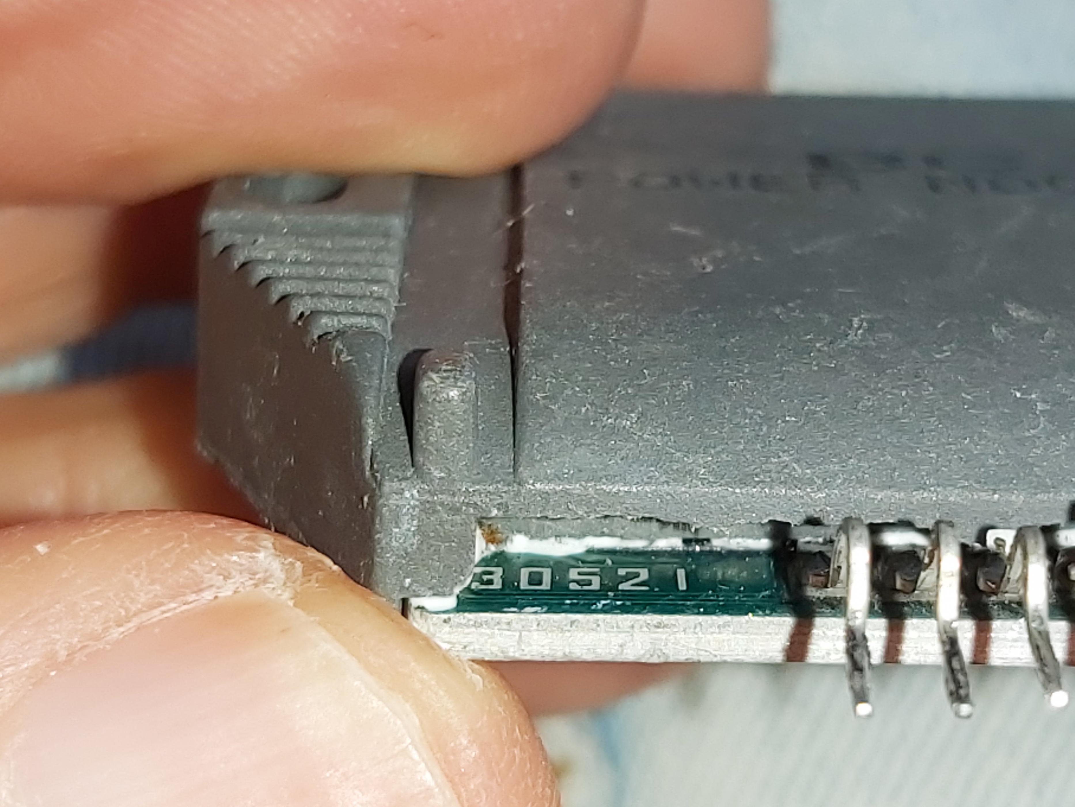

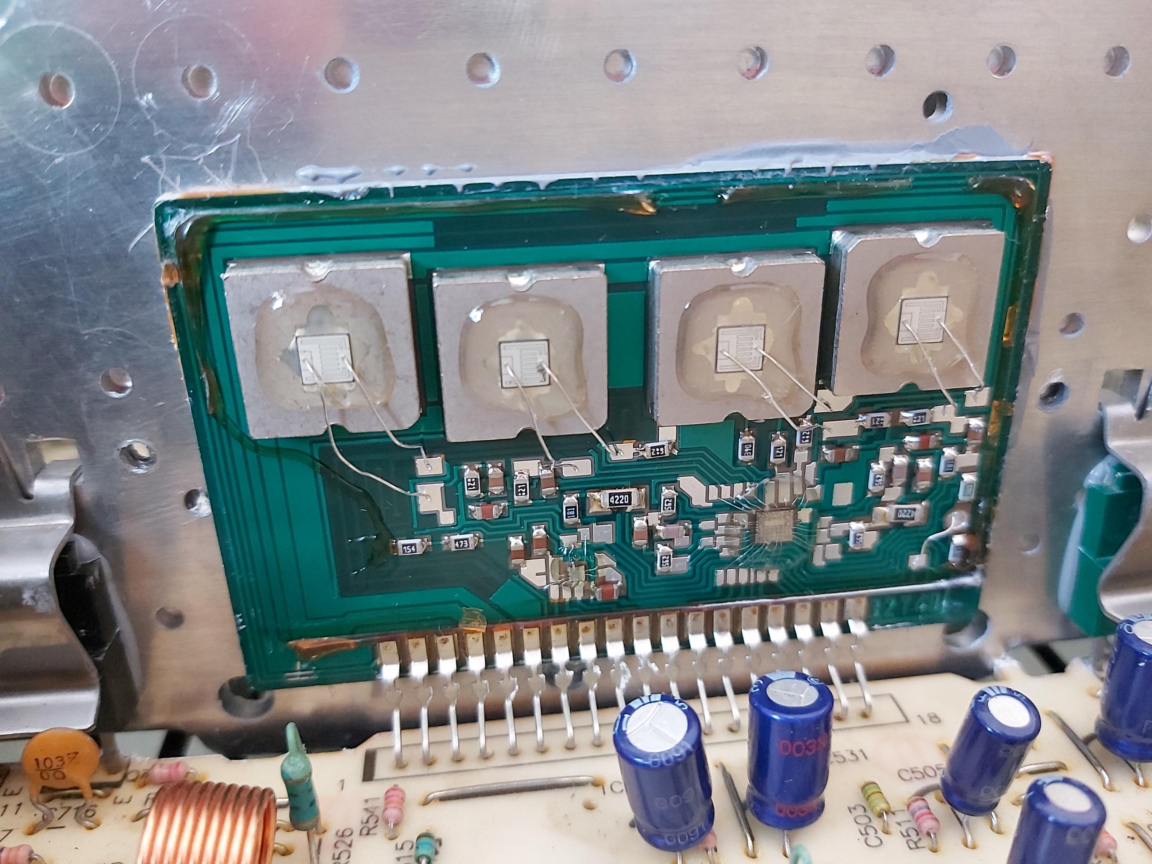

Look closely at the silicon dies on the blocks... on the 2nd one you can see the blackened area right where emitter wire connects
Usually with SVIs it’s Blockslide that causes havoc
See pics - this happens if cooling fails

Anyway, today my SVI3206 D from an eBay seller and this one looks different and hopefully real.
Any thoughts?
Any thoughts?
