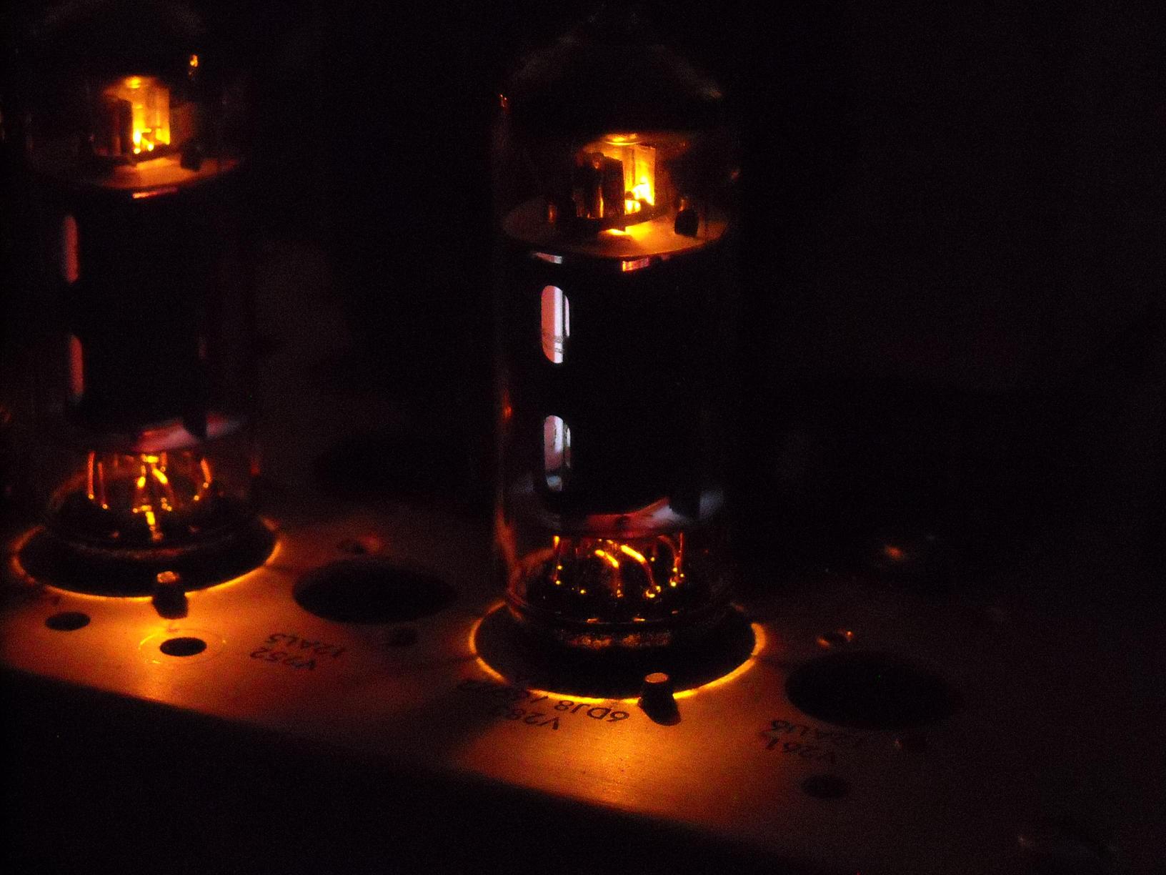

Thanks, good to know you enjoyed your design, at least for my observations the tubes only needed some 2 - 4 minutes to behave good, baking tubes can be a good alternative, I have seen lots of pictures of 6p1p´s with some thin blue beams of light, also mine do so, maybe thay are contaminated with oxigen or a kind of gas, but they seem to do well.

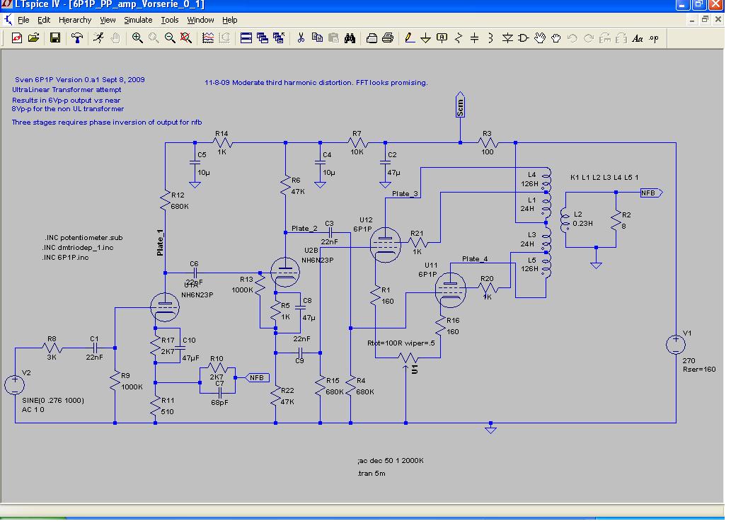

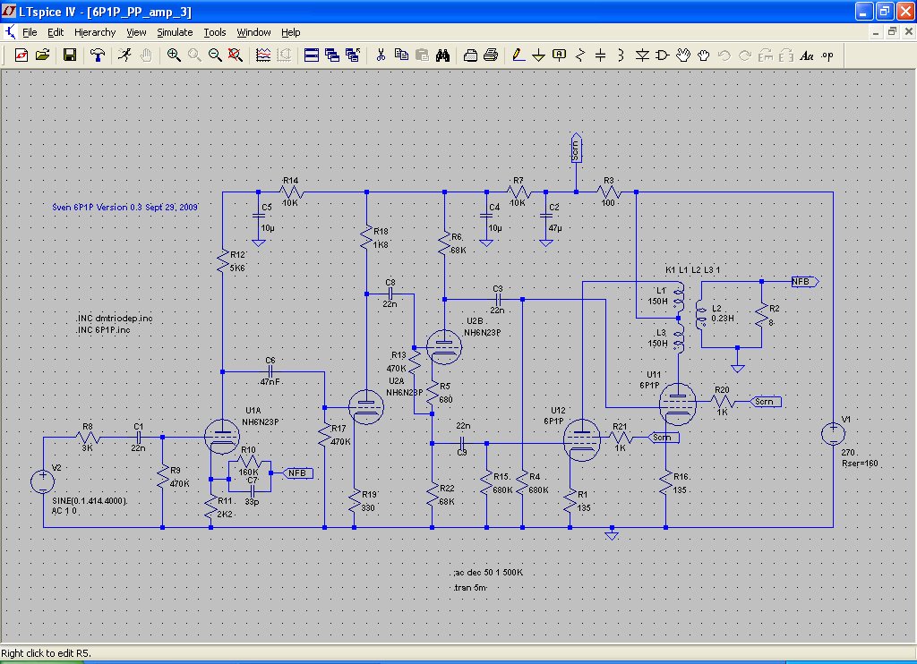

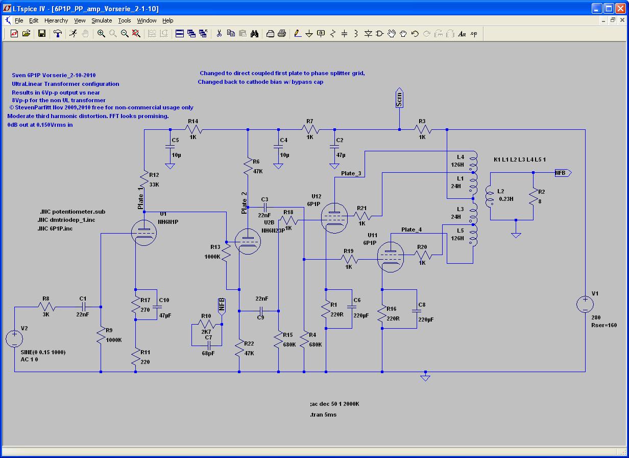

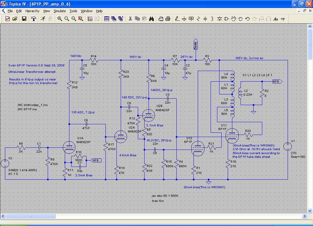

Could someone repost the latest schematic for the Sven 6n1P PP amp. Post #41 seems to be the last one posted but a correction was mentioned (R3) later and I couldn’t get to the imageshack schematic. AARGG! I wish people would stop linking to external items that go away on diyAudio.
My notes show I changed R3 from 2K2 to 1K.
I am unable to find the LTSpice files, but do have printed files. I will try to gather what I can and upload the files in the coming week.

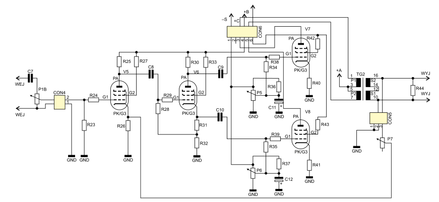

The concertina phase splitter is a pentode. The resistances in the cathode lead (24K + 1K) and the anode lead (24K) are almost equal, but the screengrid current only flows through the cathode lead and, if I'm not mistaken, fluctuates with signal. How does this phase splitter give balanced signals? Maybe it's explained in the article but I can't read Polish.Very interesting AVT5889 ... I am attaching a copy
The grid resistors of the power tubes are 1M. The datasheet for the 6P1P states 500K as the maximum value for the grid resistor.

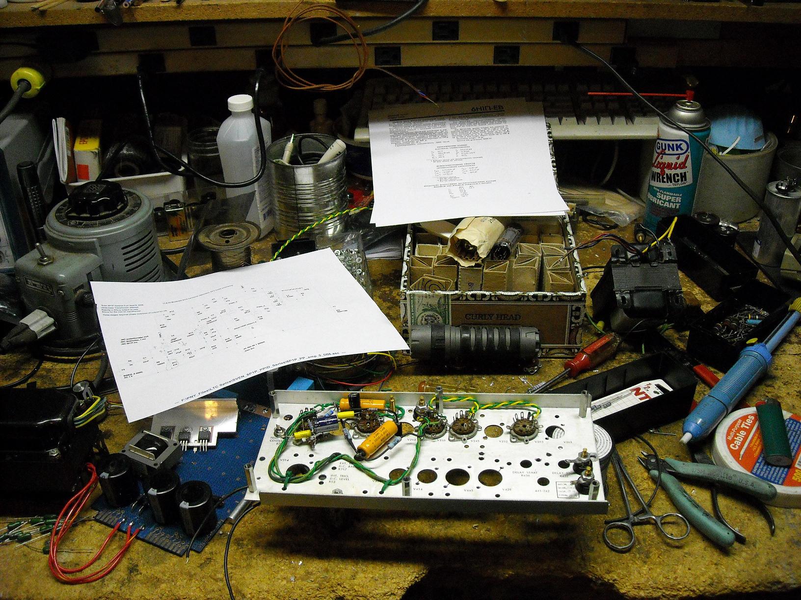

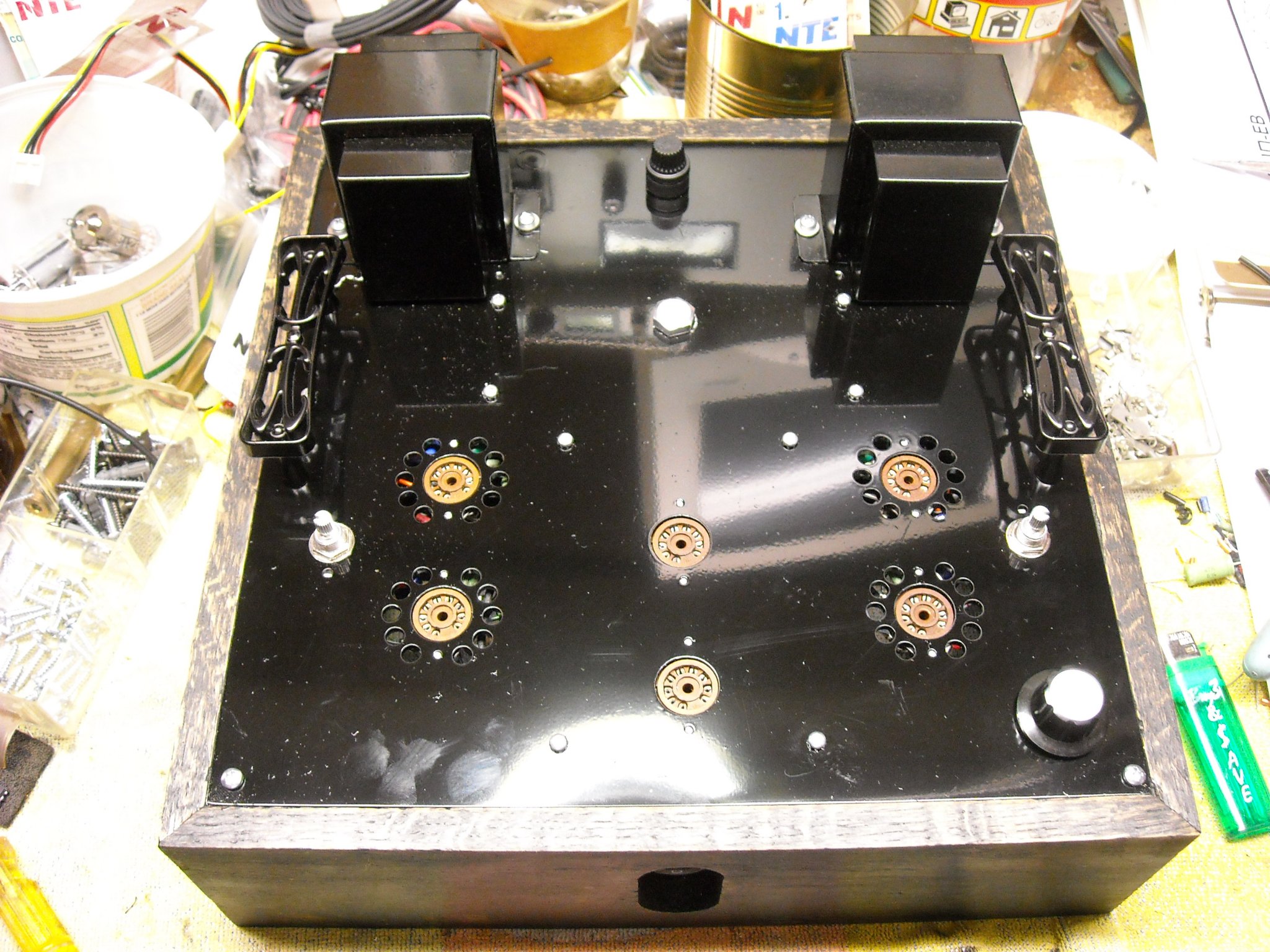

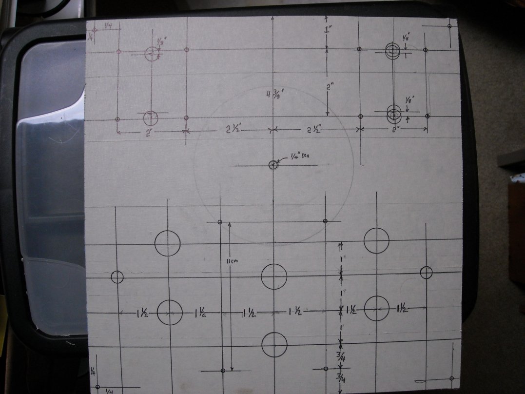

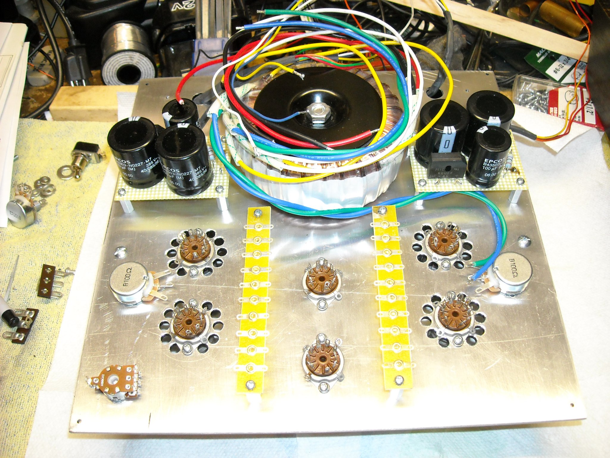

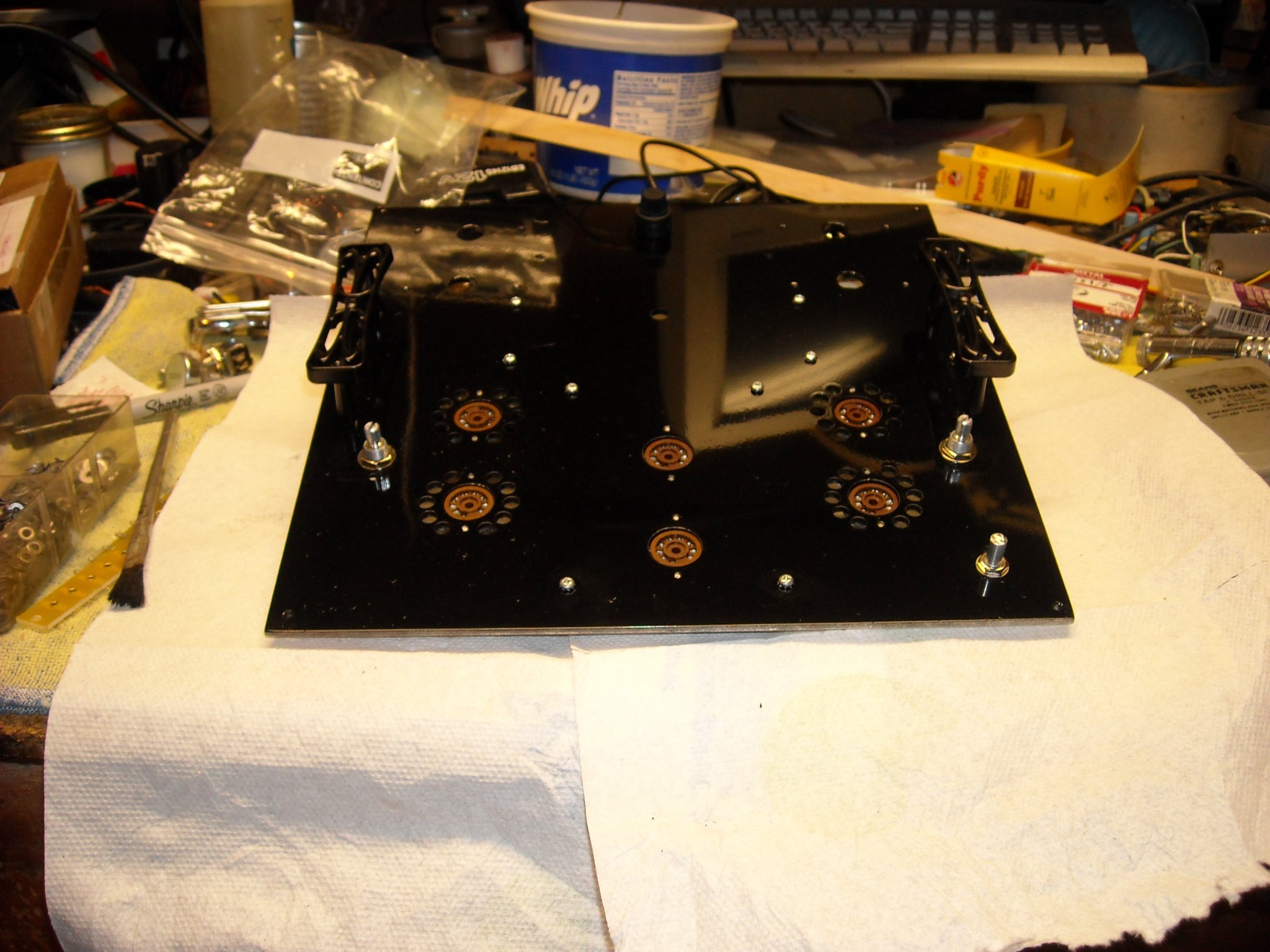

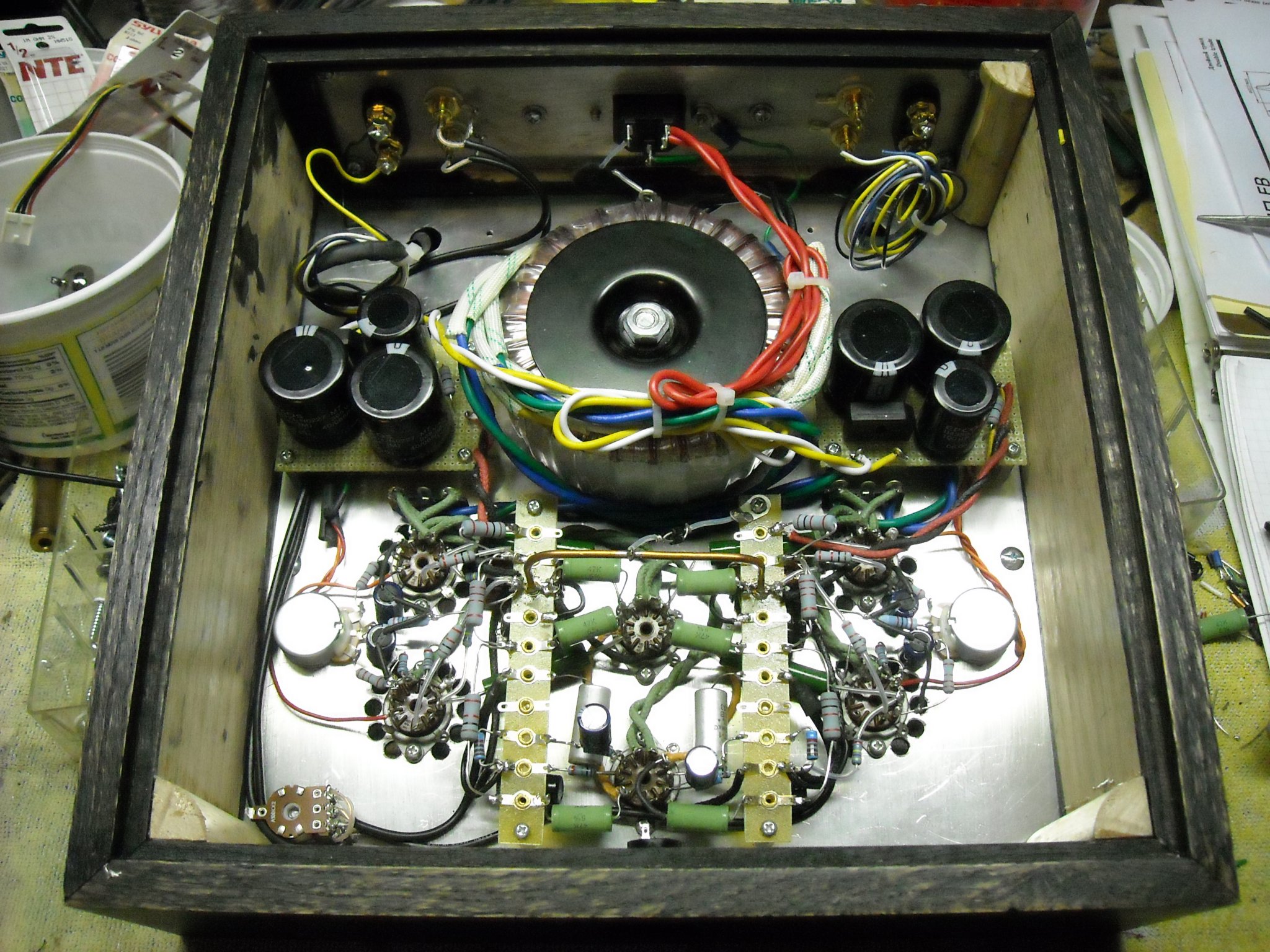

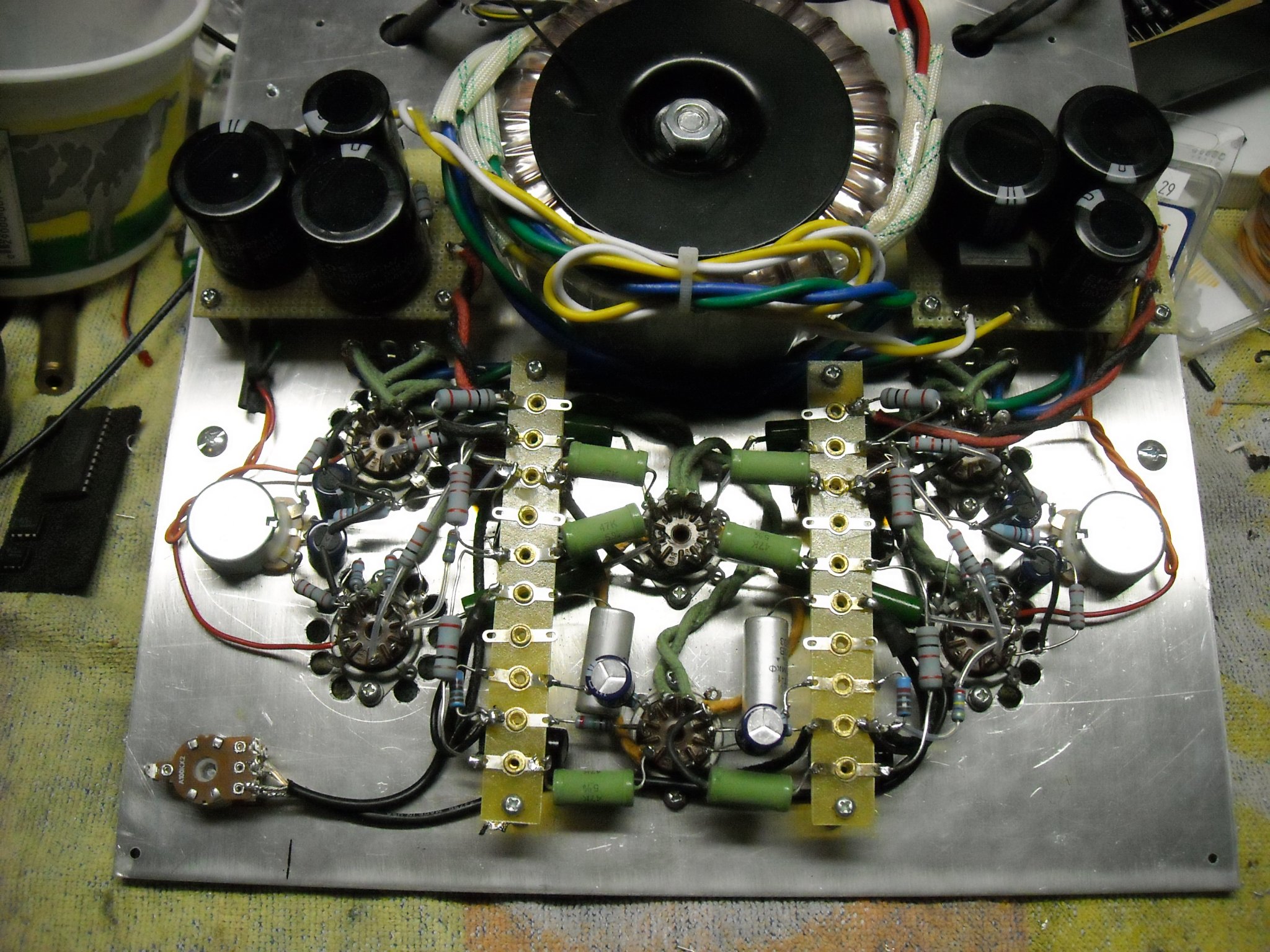

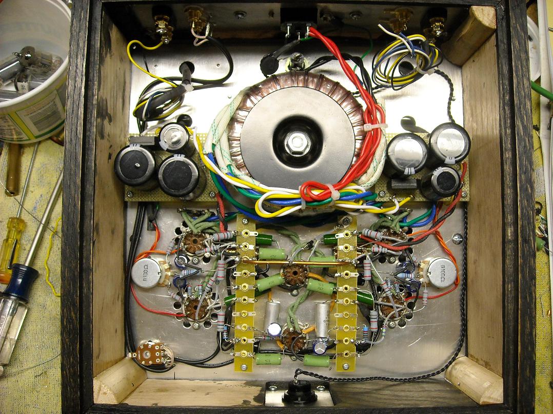

Here are the files I found. I hope this is helpful.
Thank you for posting the schematic and other files. Looks nice. Any feedback on how you liked its performance?
I guess I’n trying to assess if it is worth the effort of building it. Please let us know if you have any suggestions for improvements.
I have not had the amp for the last 6 years. I will see if I can get it back temporarily to do some listening and testing.
Last I heard it I liked it. Not as much power as 6BQ5 but very similar.

I have pushed a pair to 15W in a guitar amp, so the 8W I got out of the PP amp was running them conservatively. I think 12W would not be pushing them badly (maybe 300 to 325 Vak vs the 250 I ran them at). I am running Svetlana 6P1P-EV tubes. I had several go Blue Flash on me with cathode stripping. I ended up baking the rest before using them. I think there is reference to that in this thread. If not I will try to look up what I did. I believe it was about 175C for a couple of hours. After baking them, I didn't see any more Blue Flash events.
No problem. I will still try to get the amp back to look at if I can.
Thanks! Also good to know you had success against “Blue Flash” after baking them. I assume that reactivates the getter to re-evacuate them. If you can track down your notes on it please let us know, it would be good to know what temperature and duration was your bake. Else I will search for it on diyAdio; I know I have seen it before.
