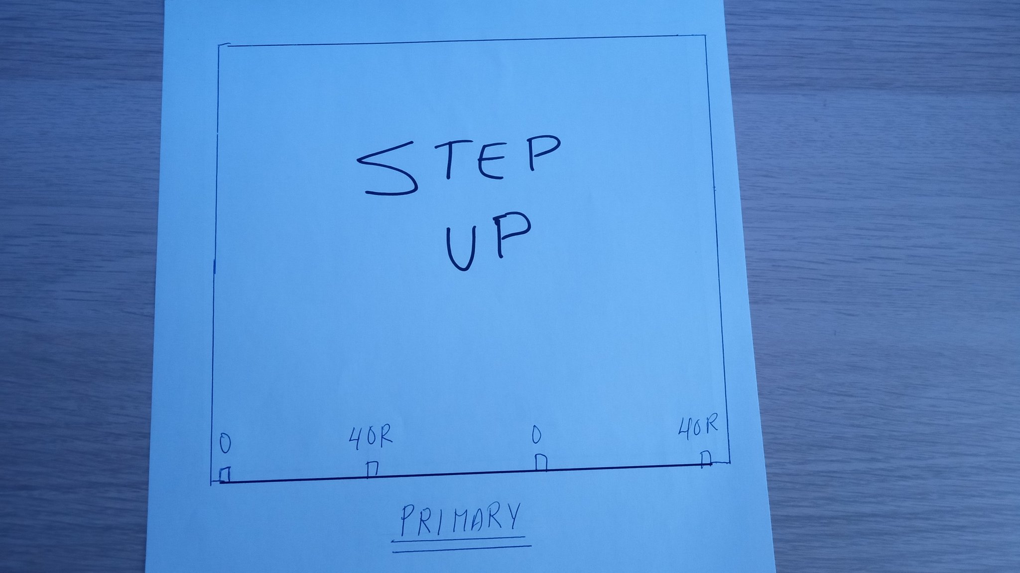

I own a SUT with two primaries 0-40R parallel connected, to do the calculations for loading what's the primary value 20R because are connected in parallel?

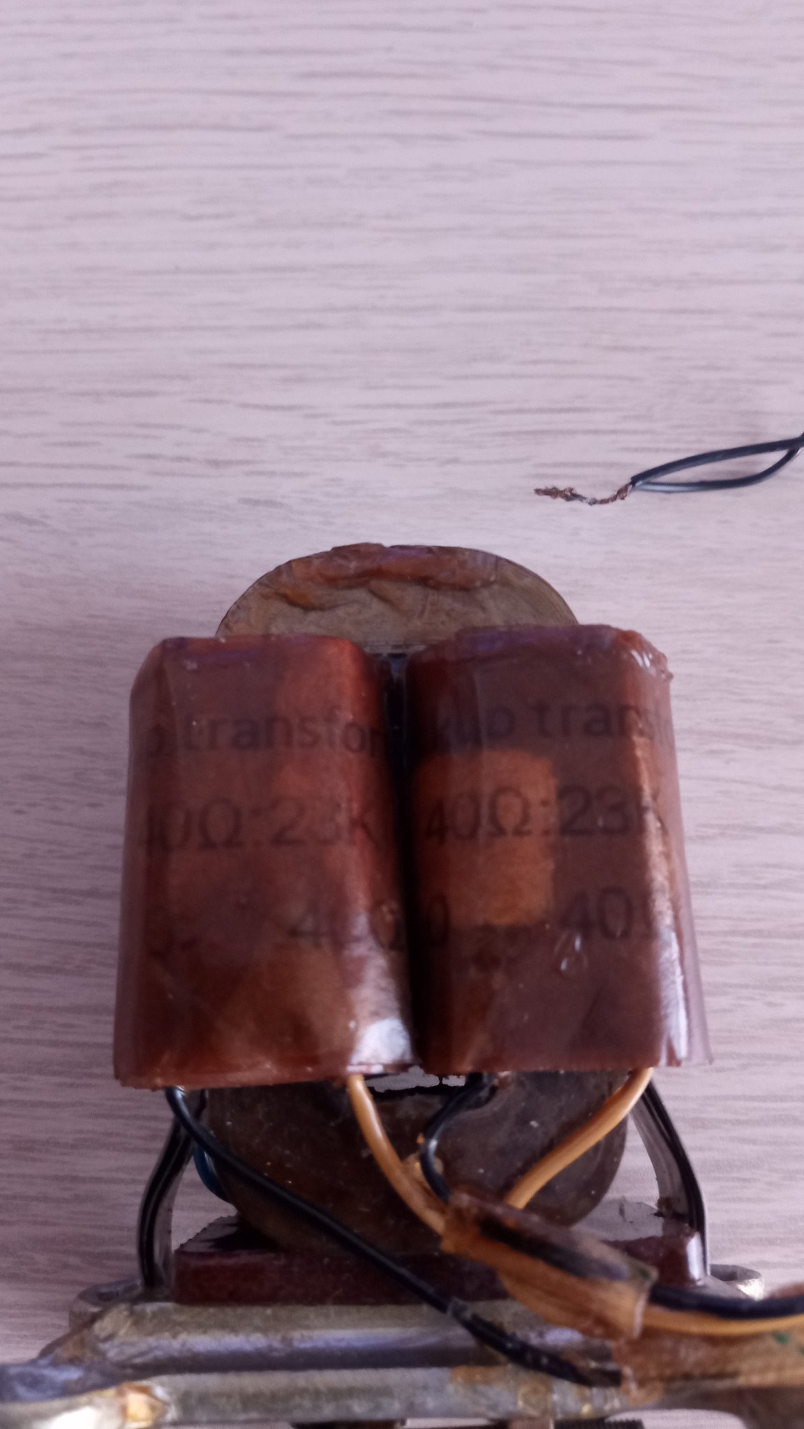

Sorry I cant read the writing on the SUT very well from the picture can you write it down? Also what make is it and what are you trying

Having a closer look I think it says 40R -23K on each coil. If so I think that means each coil is 1:24 ie the square root of 23000/40.
So if you parallel them up you would get 1:12. So with 1:24 a 47K secondary load will look like 82R to the cartridge
(if thats the application) and with 1:12 it would be 376R. Does that help ?
ps the 40R -23K doesnt mean that the primary coils dcr is 40R it means that the load seen on the primary will be 40R if the secondary
load is 23K and vice versa. So if you do parallel up the coils the load seen will be 20R. Is that what you meant ?

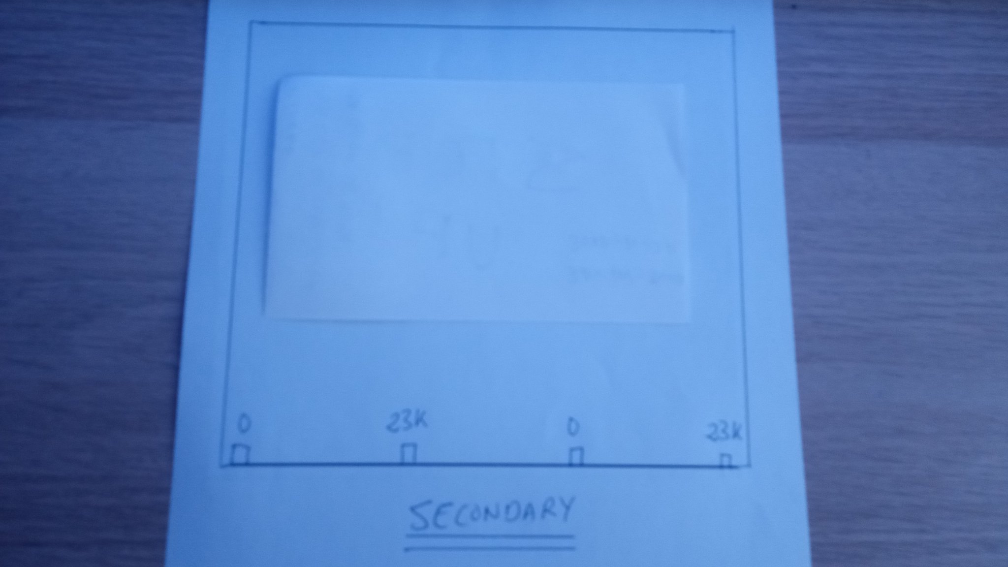

I see that the end of one coil is connected to the init of the other so they are in series, right?
Can you draw a schematic?
Walter
Walter
Primary connected in parallel, secondary conected in series joined 23K and the two outputs 0
I own Denon DL103 0,3mV load 100 ohms & Linn Arkiv 150uV load>50 ohms
it is not right.
You have to connect 0-23-0-23 it is ok, series.
you must follow the direction of coil
Your connection is antiseries, the output is zero volt

If you have a MC until 20 ohm as impedance the the primary must be parallel
If you have a 40 ohm MC as Denon DL103 you can put them in series.
Leaving in series the secondary
In the two cases the ratio changing and also the reflected impedance seen by MC ( if the Zin of the phono stay fix at 47 kohm as usual)
