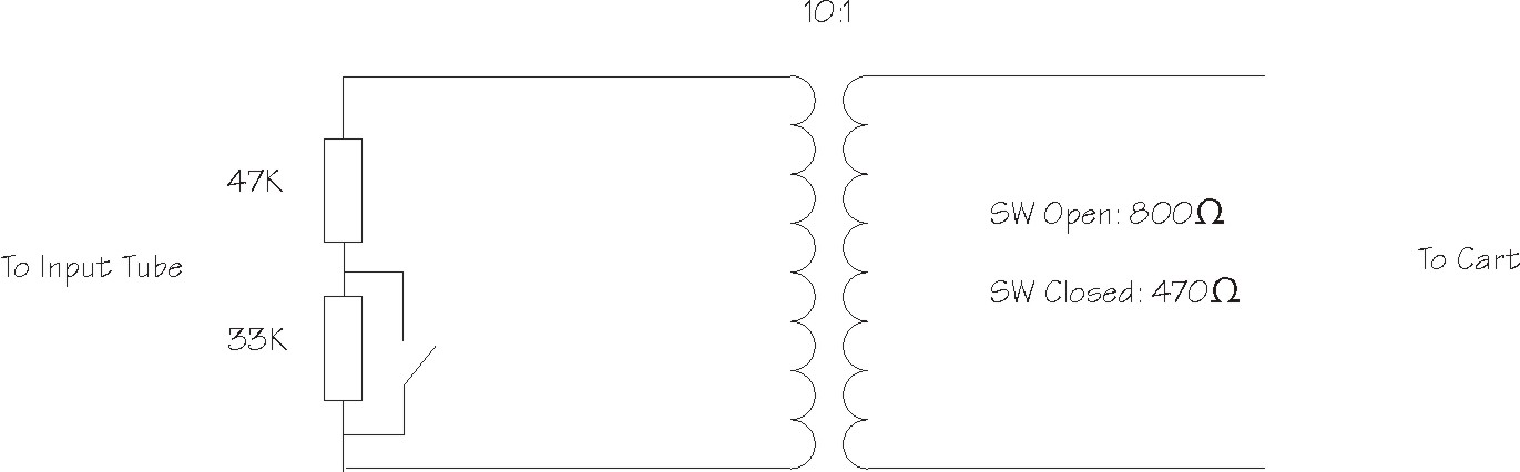

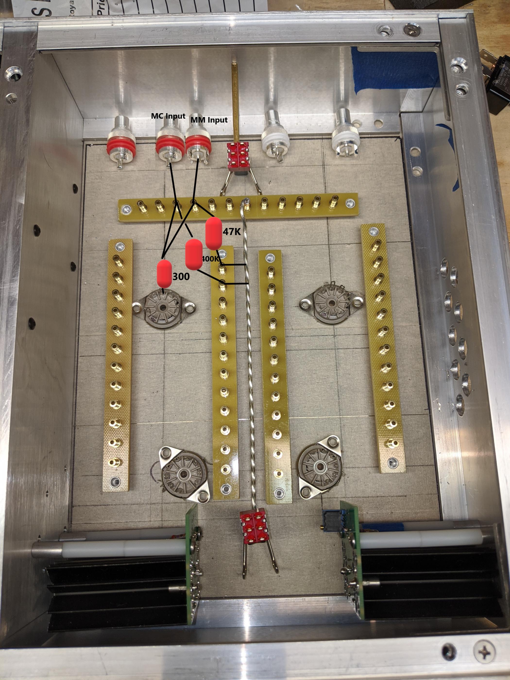

I can easily swap the 47K resistor for the 400K ohm resistor but I thought I might run two sets of RCA inputs so I could have flexibility to run a HOMC or even a MM. Thoughts on this as well would be welcome?
Can I wire the inputs as I've drawn them below?
Not what you want. Trace with your finger. Both inputs are tied together at the 300r. Both inputs will see 42k *in parallel with the other cartridge!*

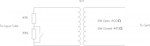

The output levels for both carts are close, so assuming the gain is enough with a 10:1 SUT, what if you used a switch to change the input impedance from 800 to 470?
If instead you use a 20:1 SUT, the 47K becomes 188K and the 33K becomes 132K.
The statement from the xfmr winder that the 47K is not needed is incorrect; while the secondary of the SUT does provide a ground reference for the grid, without a termination resistor it does not provide an impedance that is transformed to the input side of the SUT.

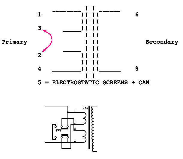

Still working on this but I have a couple of Sowter 1990 SUTs on the way from the UK. They are switchable between 1:10 and 1:20 but cant figure out how to wire in a switch or switches to accomplish this. Attached is the PDF file with the pinouts and wiring schematic. These will be octal socket mounted within the phono-stage chassis. Sketches would be greatly appreciated!

The key clue is the funny numbering on the primary. This is a conventional way to lead-out dual windings for series/parallel connection. It is *also* used for 120/240V switching, and I stole a diagram for that.
