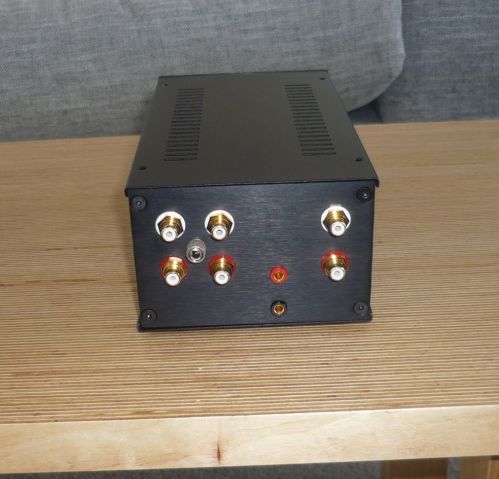

I just read the questions some Stereo.net.au forum members asked you regarding the AKSA Paris. How do you charge the batteries, do you need a wall-wart? Also, what are the black and red slots for?
Aah, that pic is of one of the first Paris headamps I sold - powered by a 12v SLA; the red & black banana sockets are for the battery charger.
On the front of the case is a switch for 'Charge' vs. 'Play' ... and a meter to tell you the battery voltage (plus a switch to turn the meter on/off).
The 2 pairs of RCAs on the left are the input RCAs - 1 pair for the phono cable, the other pair for 'loaded' RCA plugs.
The RCAs on the right are the output RCAs (to feed a MM phono stage).
The Paris is a design from Hugh ('Mr AKSA') Dean; he designed it for a 12v SLA supply - so that is how I first built them. (Hugh suffered a stroke some years ago and since then has handed over construction & supply of the Paris to me.)
However, subsequent to an experiment I carried out on my 'Muse' phono stage (my own design) ... I now generally supply the Paris powered by a 12v linear PS - such as the Sbooster. So - instead of the 2 banana sockets - it has a socket for a 12v barrel connector.
With the Muse, I found (to my surprise) that using an Sbooster didn't give anything away - in terms of noise floor - but delivered a slightly crisper leading edge of transients (than the SLA).
Using an Sbooster means that the Paris can be delivered in a 40mm high case, rather than the 80mm high case shown in the pic. So it looks a bit more attractive! 🙂 Case dimensions are: 124mm wide, 170mm deep and 40mm high.
On the front, there is just a green LED showing power on ... or, I can also provide an on/off switch (I just use the switch on the Sbooster) and put the load-plug sockets on the front, too. (That reduces the aesthetics of the front panel, IMO ... but some people don't have easy access to the back of a component, in their rack.)
