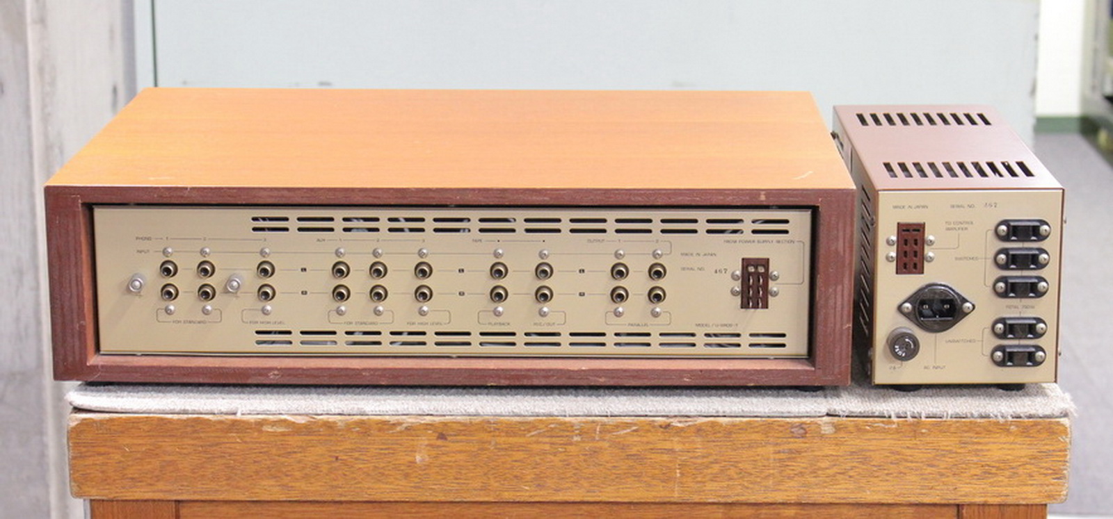

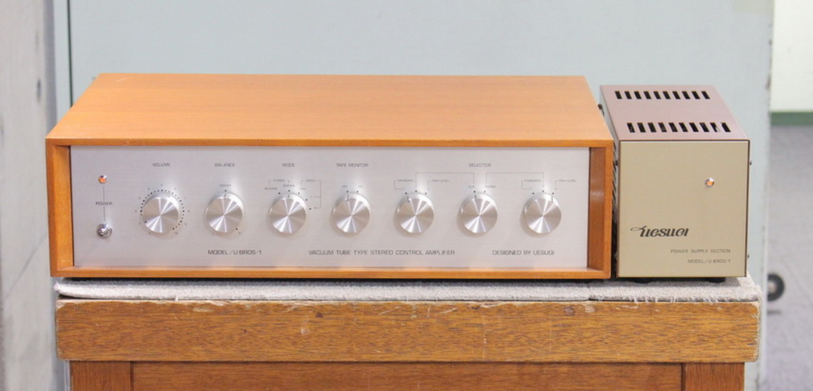

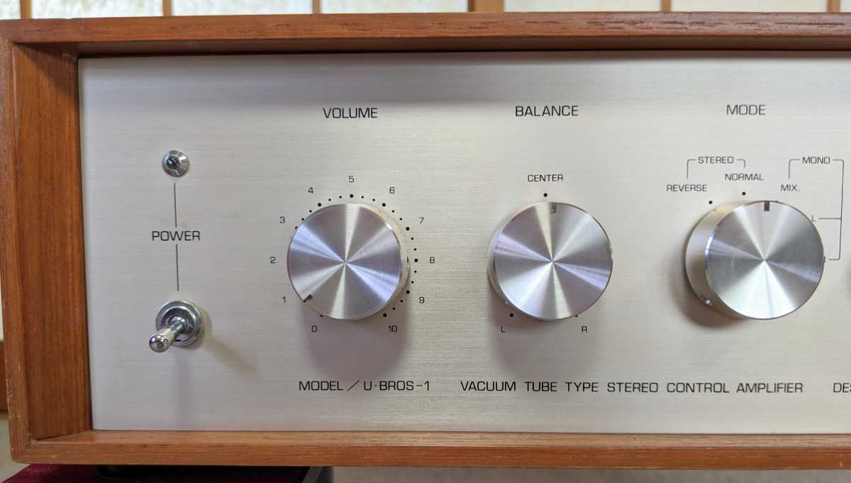

My preamp - Uesugi U-BROS-1 - has three phono inputs 1 and 2 are standard, input 3 is high level, I have no idea what the gain is, specifications are not available anywhere. A while ago, I posted a topic on Stereo.net.au since Australians are more familiar with Japanese brands - Uesugi, Shindo, Kondo, etc. - but still could not find any info or schematics. HiFi Engine only has brochures about Uesugi but no data.
Not well known outside Japan, Uesugi Brothers have a cult following in Japan for their electronics. The ‘brothers’ were instrumental in running tests on a lot of famous Japanese Hi-fi exotica while being employed at Stereo Sound magazine in Japan. The brothers were some of the founders of the Japanese hi-fi we know today. Their designs sat on the shelf to inspire Ken Shindo, Arte Forma, etc, while they were developing their own work. All UBros -1 pre amps were hand built and a piece of Japanese audio history and one of the best preamps ever made! Uesugi designed the pre to be far superior than McIntosh and Marantz. This is what I know so far.
However, the preamp in my system sounds fantastic it is a perfect match for my Berning ZH-230 and Tannoy Monitors.

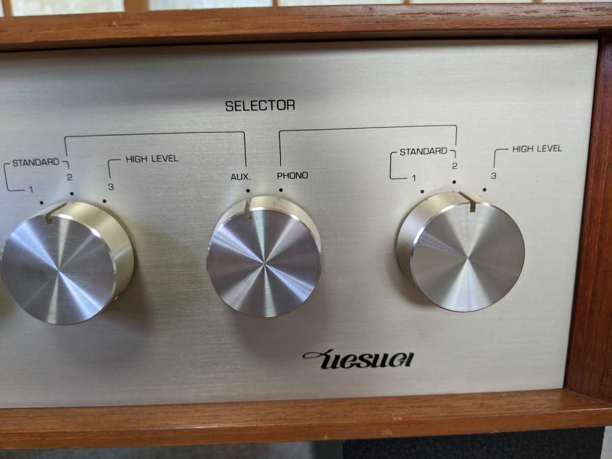

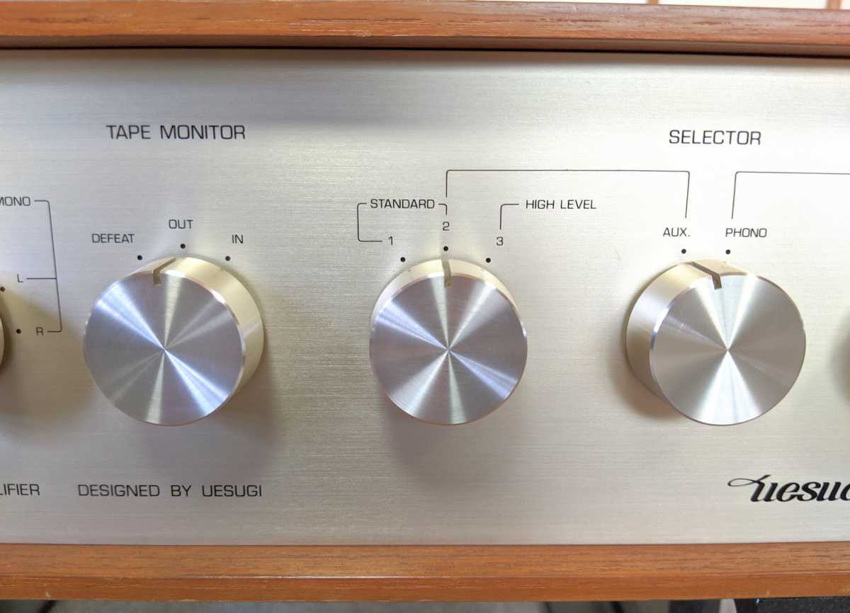

Unfortunately, "three phono inputs: 1 and 2 are standard, input 3 is high level " is not a simple description.
Does "inputs 1 and 2 are standard, input 3 is high level" mean:
* inputs 1 and 2 are for LOMC carts, input 3 is for a HO (MM) cart?
* or inputs 1 and 2 are low gain (for MM carts), input 3 is high gain (for a LOMC cart)?
If you can determine what the loading is Phono 1,2 & 3 ... this will confirm what they are intended to be used for.

And I have to admit, the front panel (from your pic) ... totally confused me! 😀 It seems 'Japanese logic' is different to 'western logic'?

Andy, thanks mate,
Phono 1 and 2: 47.9K; phono 3 High: 49.2 K. So, how do we go from here?
Cheers
NP at all, F1! 🙂
OK, so all 3 phono inputs give you, essentially 47K. That's a lot more useful to you than an input which is fixed on 100 ohms!

It is a full function preamp, please see photo.
SME 3009 S2 non-improved, 1 older model with front and rear rider weights, the other, newer, with rear rider weight only and Garrard 401.

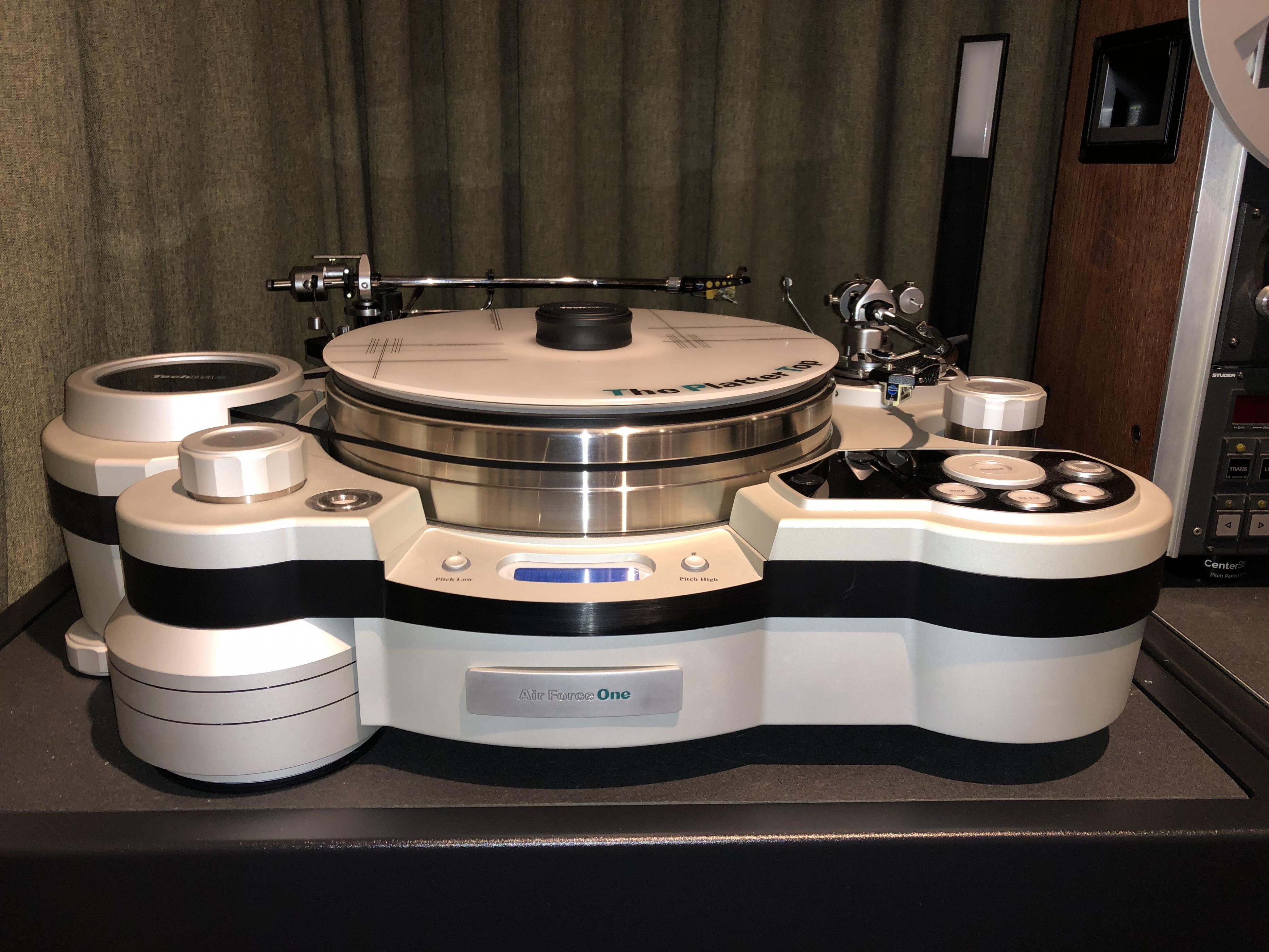

Amusing: whatsbestforum shows the forum's owner turntable/cartridge set-up. A pair of old SME 3009 S2 mounted on an Air Force One £72.500 turntable. One arm has a ZYX Universe Premium £12.800 cartridge, the other a Van den Hul Colibri Signature Stradivarius, £9.000.
