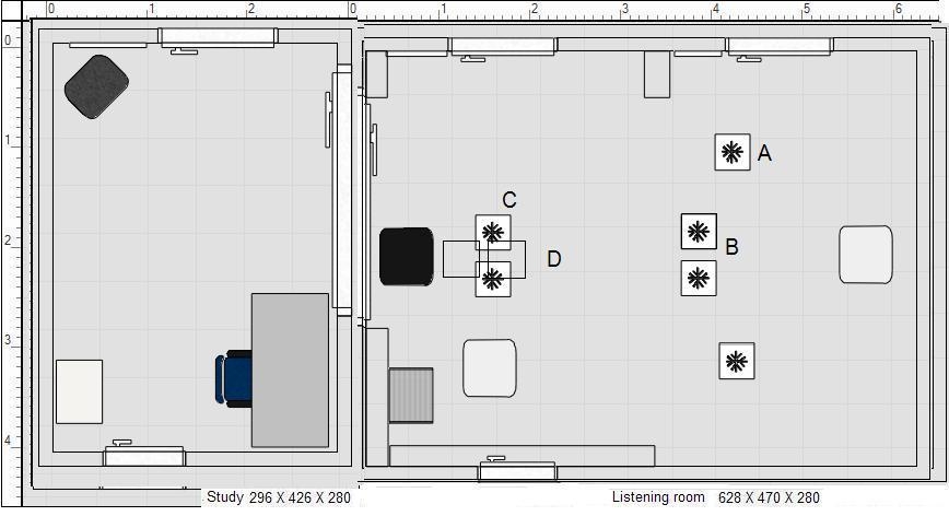

a picture is worth a thousand words, so here go the various positions I have tried over the years.
Listening room and study are separated with an "accordion" type plastic door. I like this open while listening, as this gives a total room length of 924cm, or 30 feet 3 25⁄32 inches - thank you, Google.
A - Stereo 2,2m triangle,
B - Ambio long, 2,2m from speakers plane
C - Ambio long, reversed, 1,4m from speakers plane
D - Ambio wide, 1,4m from speakers plane
(Ambio barier not shown)
I have tried to keep B,C and D close to median plane.
No room treatment except for some 7cm pyramid foam 1m2 slabs at the corners behind the listening seat. When in A,B positions I additionally use 2 diy high-freq absorbers, one behind the listening seat and one at the opposing wall. (treatments not shown)
Apartment was rented for experimentation. Rooms are void of furniture except what is shown, have wooden flooring, bare brick walls, 3 balcony doors covered with very light curtains and 2 doors connecting to the rest of the flat.
Hope this helps.

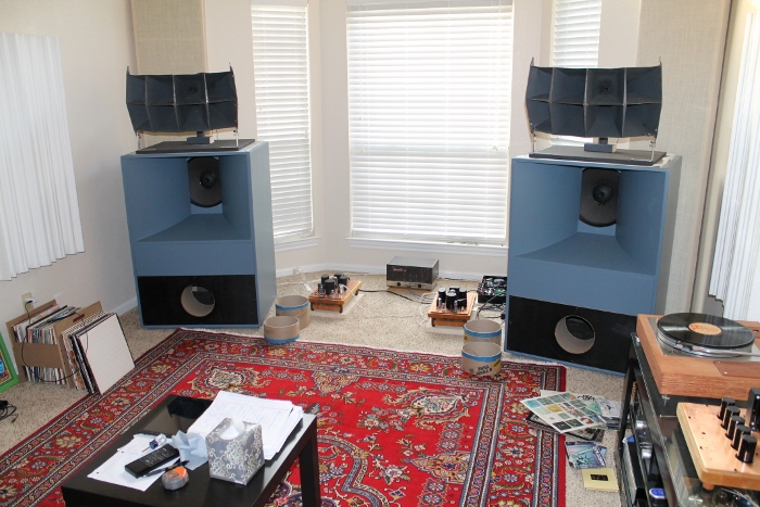

My room is 13 feet x 17 feet x 10 feet tall. The rear wall is a window that kicks out about 3 feet (Included in the 17 feet)
Room treatments are bass traps full height all corners and front at ceiling.
Diffusers at 1st reflection of wall and two on rear wall.

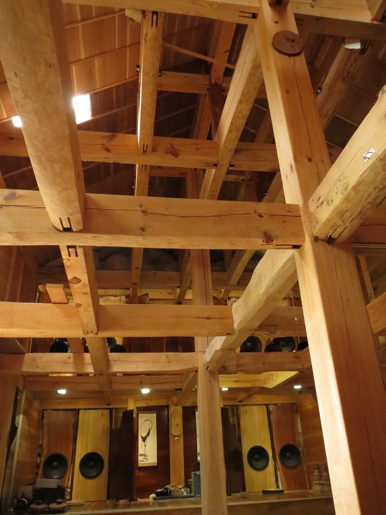

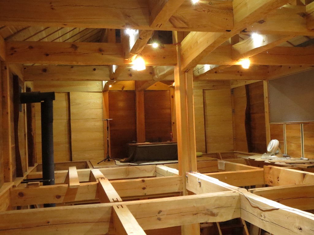

My three sizes is a little bit different from woman's.🙂
Depth 10.8meter
Width 5.4meter
Height 5.0meter (average)
post and beam. japanese traditional style.I have almost finished to build by myself.It took 7 years.
The opposite side of speakers is my listening position.About 10meter away from speakers. Height is at 2meter from the floor.I sat on the floor two or three years.On one occasion,I found the middle point in height is better than on the floor.
A ceiling shape is same as a roof.I think it's better for audio performance rather than usual flat plate.From the viewpoint of self-making,It eliminates cost and labor.
