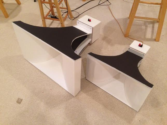

You can't beat a conventional cone driver paired with a mid horn for low distortion as the horn loading is so efficient that only tens of micrometers of cone movement are required for 100dB. This very low movement (for a driver with order 2.5mm xmax) translates to very low HD.
Here is a 5in PRV 5MR450-NDY driver coupled to a tractrix. There is not a compression driver that can achieve low HD like this. The clarity and sound of vocals is amazing.
The data below is from the bigger horn (30in wide mouth and 3.75in square throat):
The smaller horn with 2in square throat can use 3.5in cone drivers like the SS10F and also achieve similarly low levels of HD.
What kind of horn is this? Custom made?
I got the dimensions from Volvotreter's spreadsheet. It's made of foam core but you can make out of wood of course. Plans (scale pdf flat drawings) are in the Trynergy thread. It required some 3D manipulations to convert (or flatten) a curved tractrix onto a flat cut plan.
