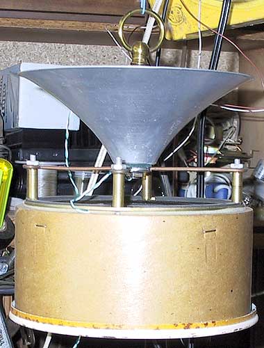

Here is a pic of my latest surround experiment ... these will hang from the ceiling just behind and a bit to the sides of the listening area. They have a 6" FR w whizzer (costing only labour and some ductseal, these are very much Frugal-phile (tm) material.
dave
dave

leadbelly said:
Seriously? Ouch on the SAF....
The "whizzer" looks like it is mounted to the enclosure and not the cone. (?)
Seriously... the wife like the way they look (they originally came with a cylinder enclosing everything. They are small (about 7" in diameter ... that isn't the whizzer, it is the deflector. The driver fires up into the delector, giving a 360 degree radiation pattern.
dave
