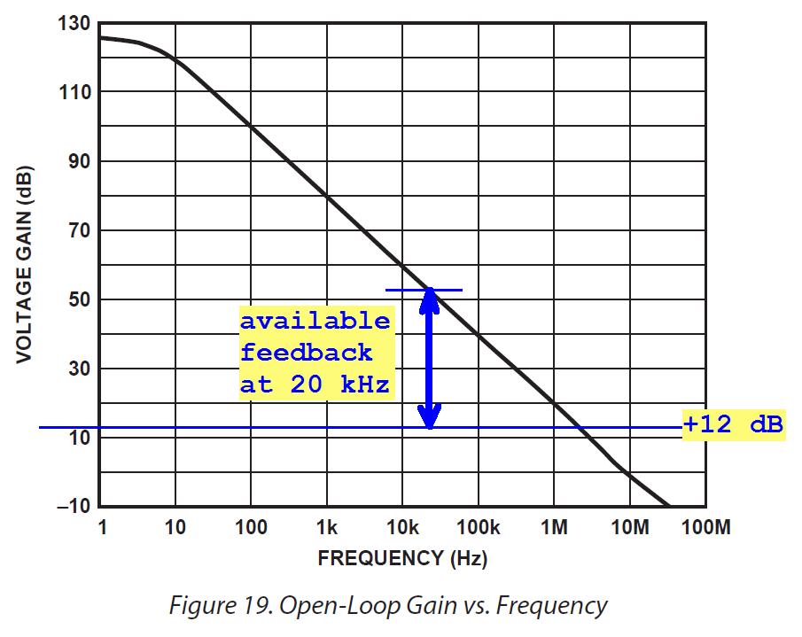

"Also, for audio use, I see no benefit to having [opamp frequency response] out to 10 MegaHz"
A lot of people want this because they want to maximize the amount of feedback available at the top of the audio band, 20 kHz. More feedback means more "error correction" / distortion reduction. Which means lower distortion. Which is their goal.

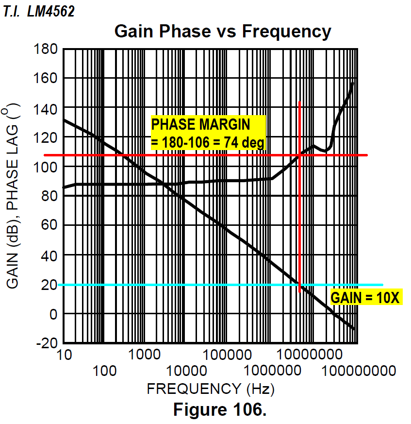

That's why lots of engineers have abandoned the Sallen-Key active filter and embraced the Multiple FeedBack active filter instead. MFB gives much much better results with nonideal opamps.
Or, for stubborn traditionalists, stay with Sallen-Key BUT use Emitter Followers with constant current source loads as your unity gain elements. You can get 100 MHz bandwidths from jellybean parts in TO-92 packages.
