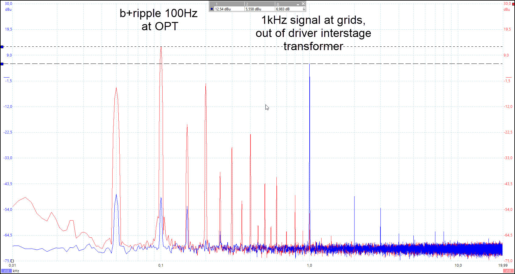

Surprising amounts of rectifier intermodulation
This is an instrument amp, but the topic I think is relevant here in 'tube section' as well...?
To be clear, this amp sound absolutely amazing. I actually believe it has something to do with the NOS late '60s carbon comps - but lets not go there...sorry.

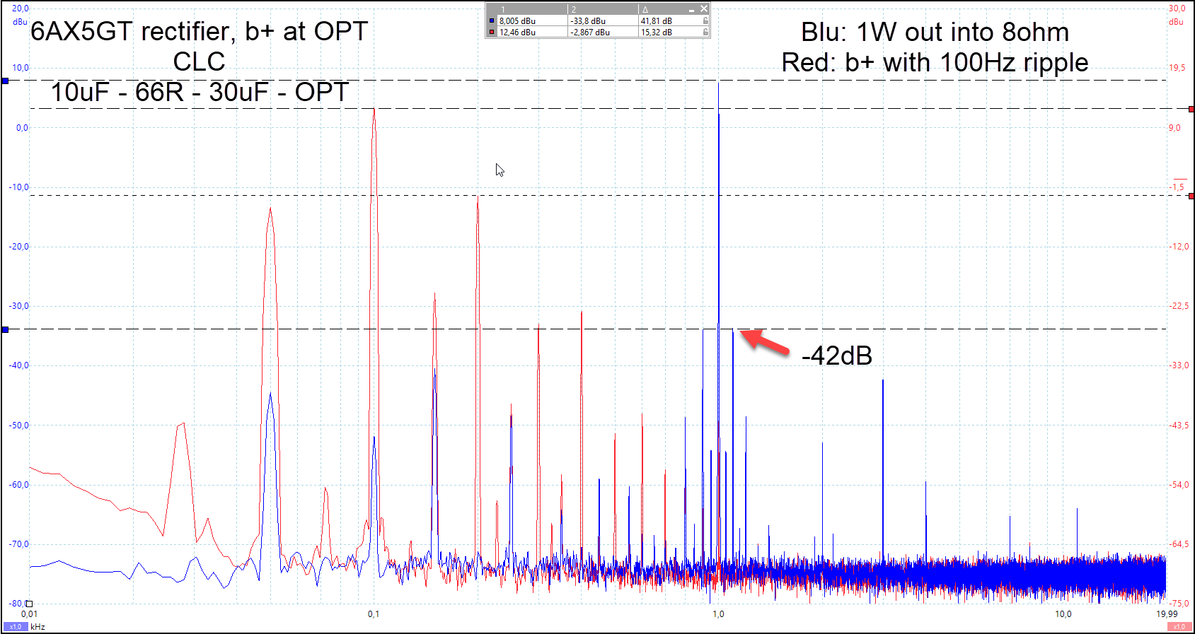

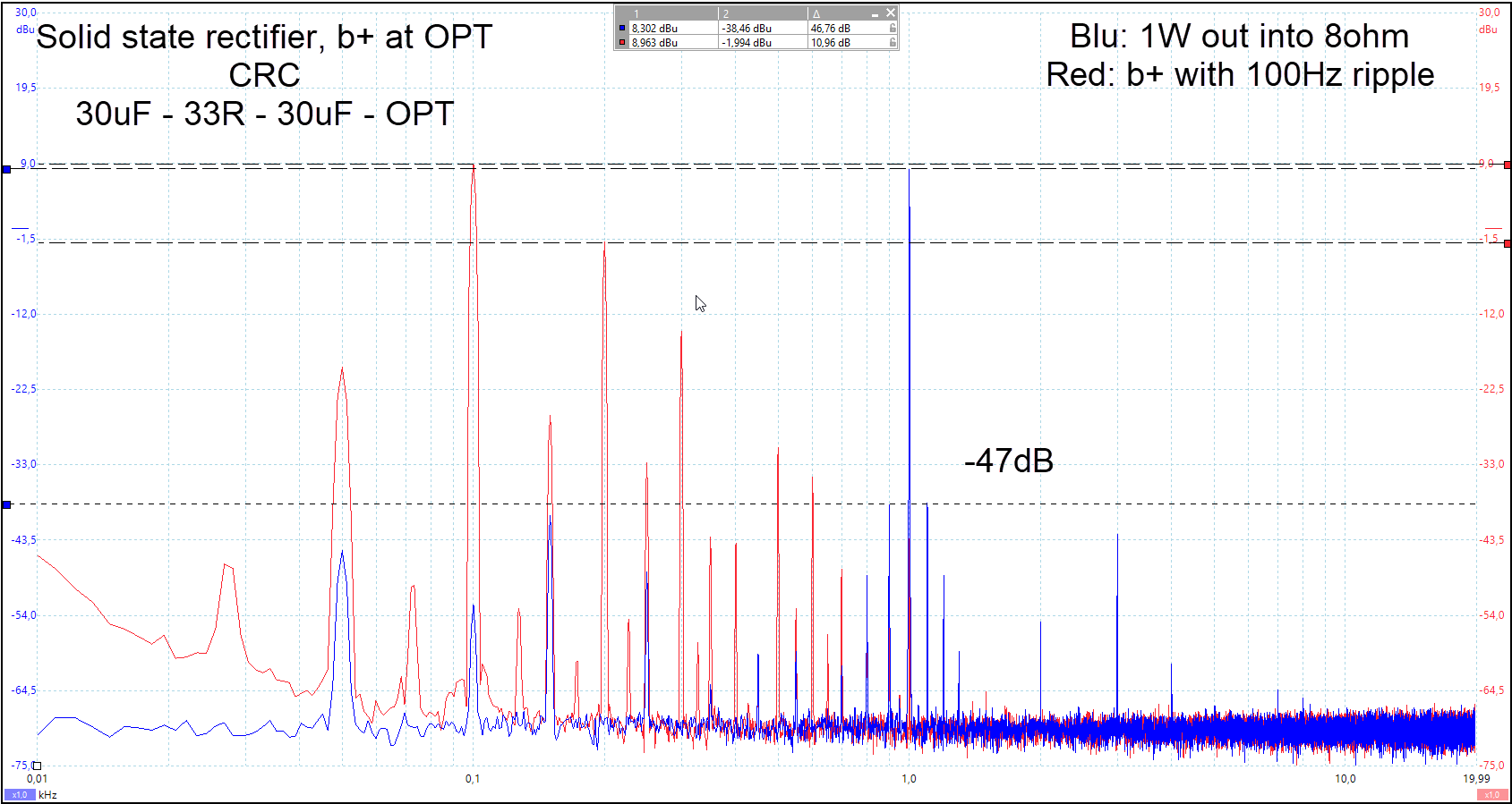

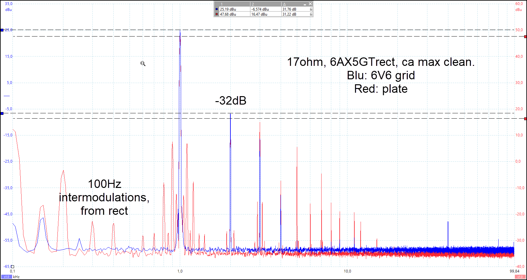

The point here is I am a little surprised at the amount of rectifier (100Hz+) intermodulations. Look at the 1kHz test signal and the harmonics around it, they are 100Hz apart. The first +-100Hz are only -40dB down.
This is at max clean power just below clipping. With 6AX5GT rectifier this is ca 12watts and with solid state it is ca 18watts.

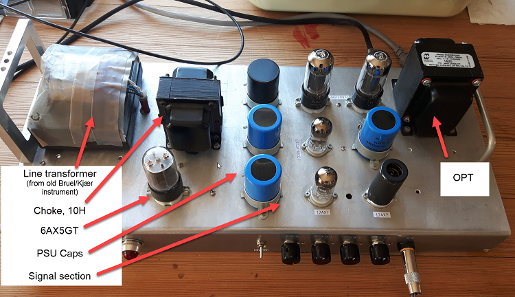

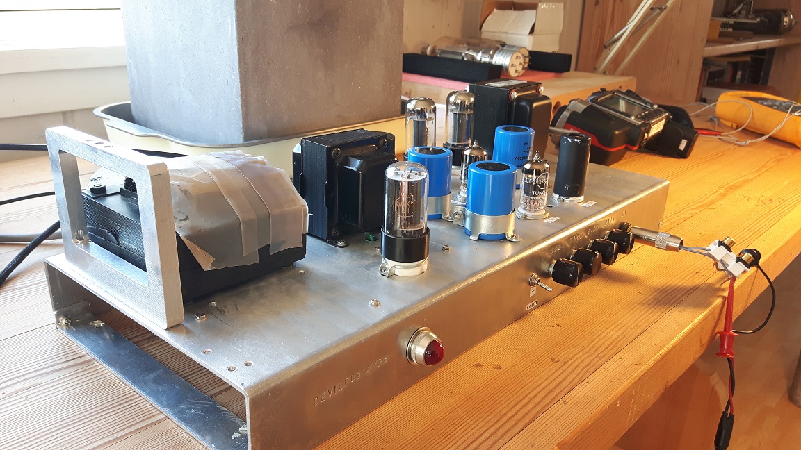

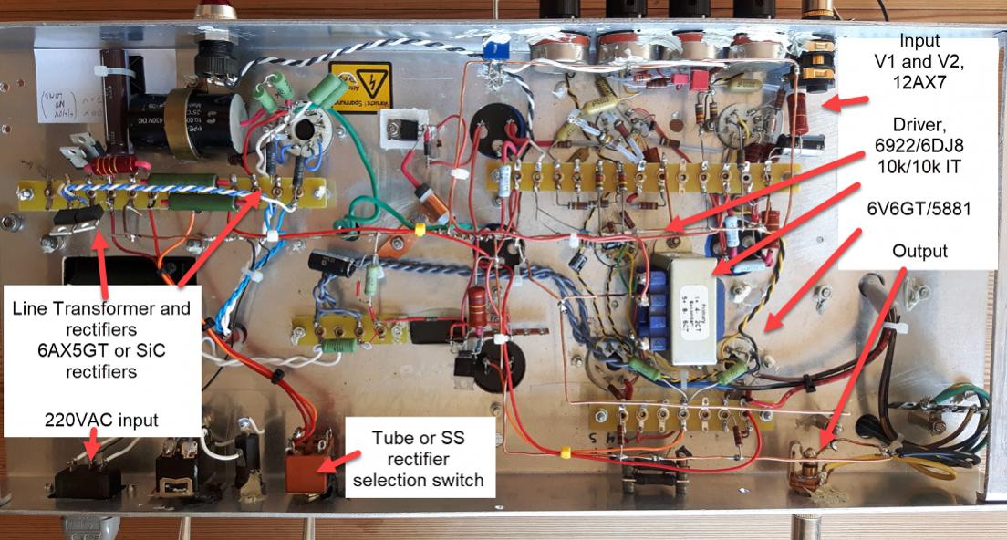

I think I have the layout and routing ok. The power supply is at one end, the first cap is really close to the rectifiers. The b+ wire (red) is routed close as possible to the GND copper bus. The loops should be farely small and tight.
I have seen this when the magnetics (power supply) is close to the OPT or IT, but here I was expecting a little better.
Any comments?
Is this just normal?

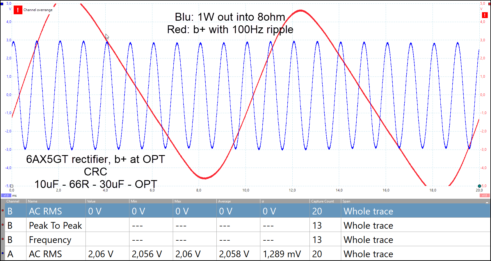

It makes a wonderful output. Clean to 12watts in 16ohms and just over 15watts into 8ohms. I am very happy with that rectifier. I can also use 5Y3.
But this thread regards the rectifier intermodulation. Not rectifier types please.

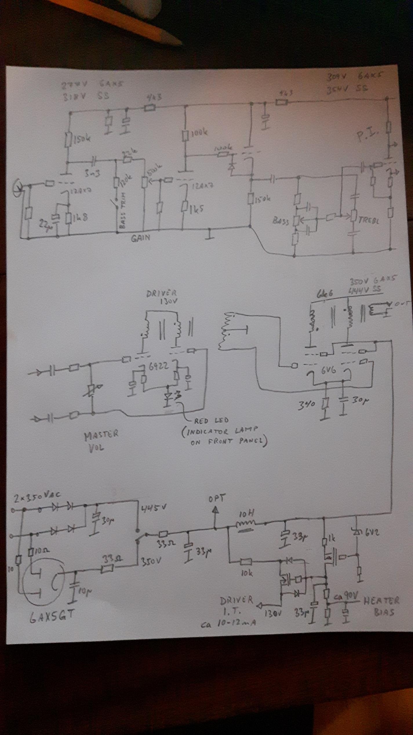

Will try and post schem. But I rather dont think that is critical for the subject.

So the reason is the high ripple at the OPT. Guitar amps of mine have minmal filtering on the b+.

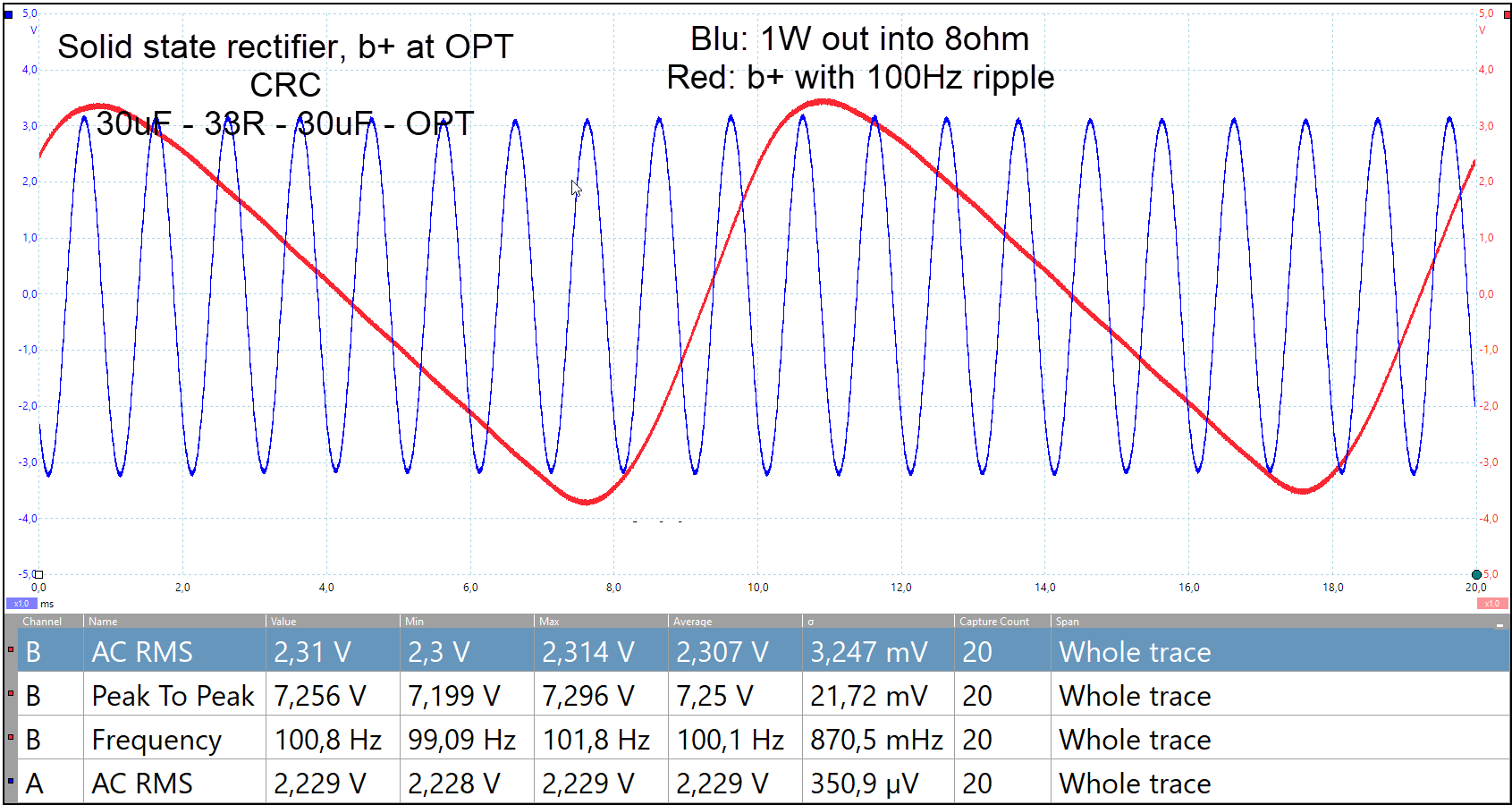

solid state is 30uF - 33R - 30uF - OPT.
Tube is 10uF - 66R - 30uF - OPT.
The slightly higher ripple on the tube shows in the fft, higher intermodulated 100Hz.
This does not worry me, the amp is silent at the 99dB/W speaker. Now that I know what is going on I can deliver it...

Hi, do you use elevated heaters? I remember I've read time ago someone solving this issue by elevating the heaters + placing snubbers on the diodes.
May I ask you to share the schematic of that amp? Nice to see you use low filtering on the amp, I've played very good sounding amps with low filtering.
No, it is after the SS/tube rect first cap, so it's relatively DC.

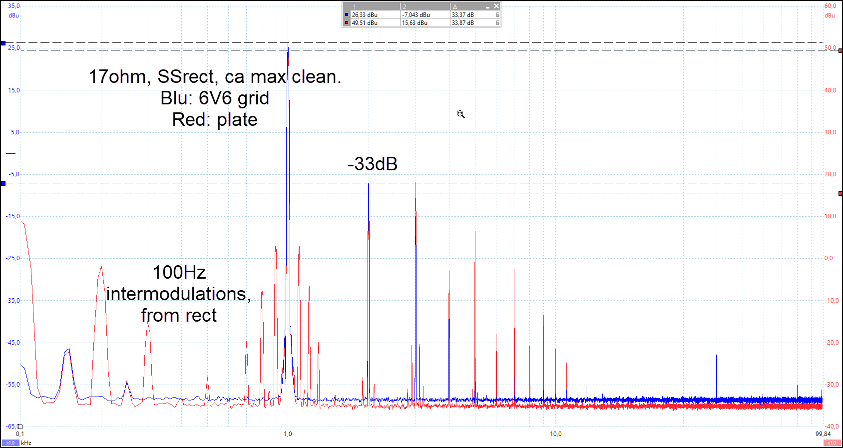

But problem/mystery solved, see post number 5, the fifth post. I think it is to be expected when the plates get a 'signal' at 100Hz at that magnitude. The plates are electrodes after all, just not as effective as the grid or cathode. One hopes they get cancelled via the PP topology, but here nothing is that well matched.
The signal at the grids is 7dB lower than the 100Hz at the OPT. The output has less than 1% of the 100Hz into the 1kHz signal, so that is not bad actually.
Yes. elevated as always. Thnx for tip anyhow, thats a good one.
I will try to draw up the schem tonite. Time...
If it is "near clipping" it *will* intermodulate, no matter what small-signal cancellations (push-pull, NFB) you apply. This limited the nice-number ratings on SWTP's Tigers, dead-clean solid-state amps with marginally sufficient power caps (looked big at the time).
Not having that IM is reported to make the amp sound "dull, dead". Some German students put a super-clean supply in a 5F6A. Anybody remember that paper?
