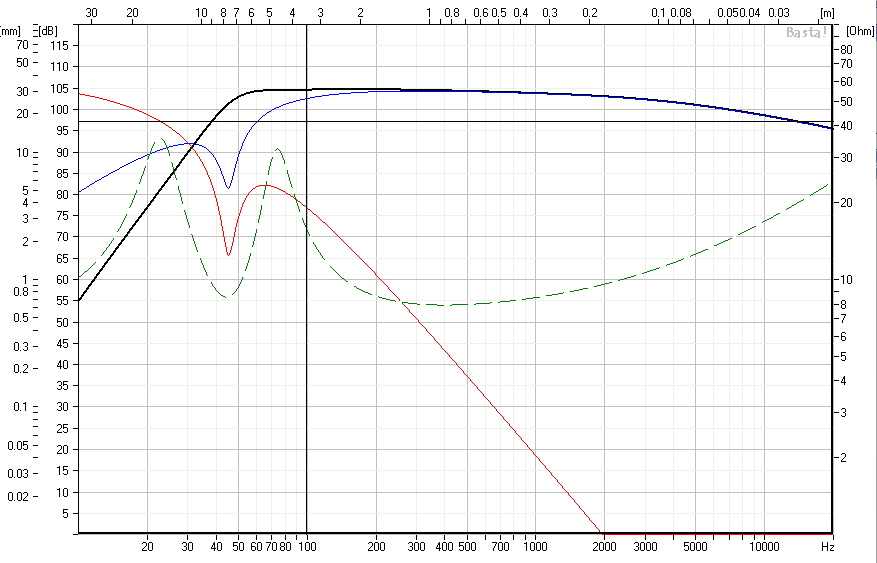

Basta! pretty much agrees. 17.9L tuned to 46Hz

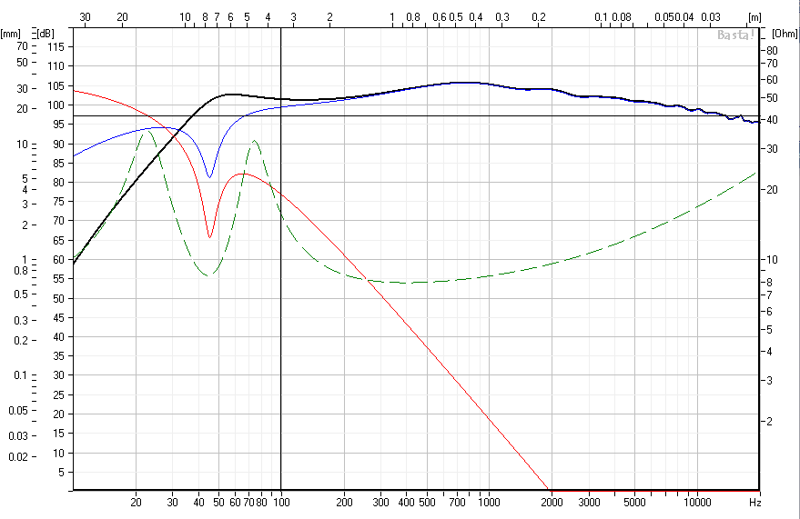

But, also allows for an approximation if room and baffle are included:

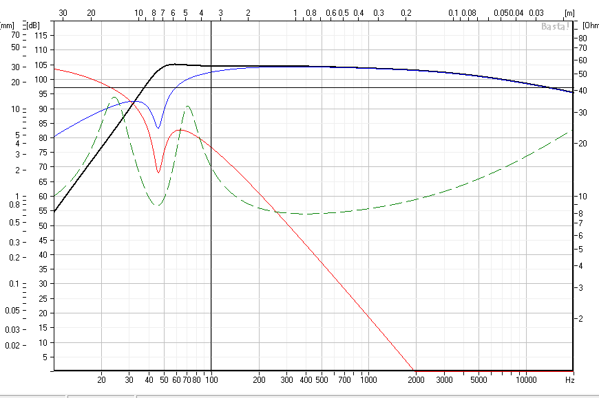

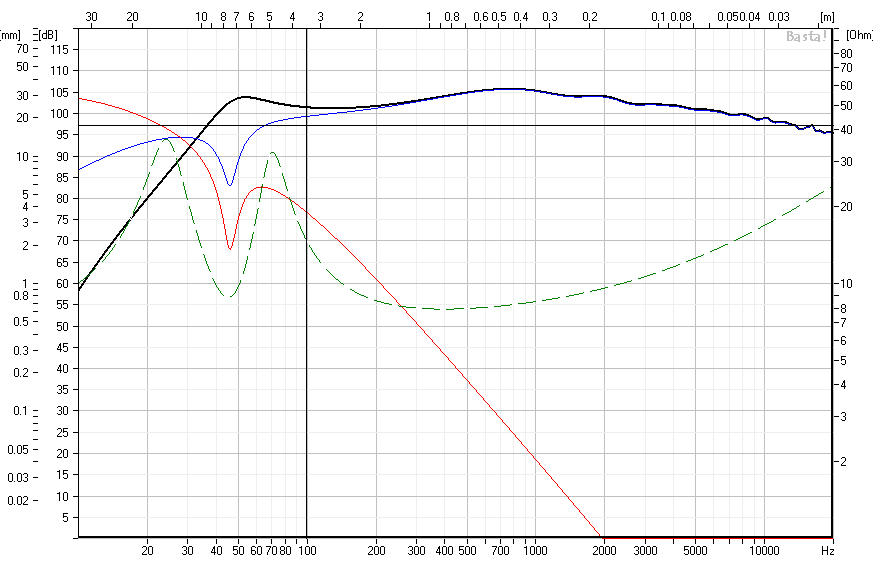

If the cab is reduced to 15L and tuning dropped to ~45Hz (still including room and baffle):
Noticeably less peaking at 50Hz.

I've built many (too many) speakers over the years and I recently found Basta. The ability to include room and baffle effects has accurately predicted issues I have had with previous designs.
Basta also allows you to specify and include notch filters in the predicted responses which have proven to be very accurate when I went on to measure their impact in the room (TBF, maybe WINISD does this too now?).
Anyway, sorry for the hard sell on Basta. It's free, it's available for download and, for me, it has been an even more accurate tool than WINISD. Maybe helpful to some people.
