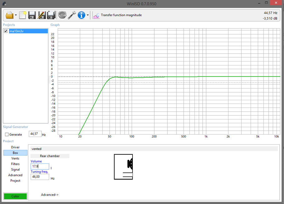

Ever impulsive, I went ahead an ordered some MarkAudio 10m drivers. Or, at least I think I have. There's an ebay seller selling Unmonday branded drivers quite cheaply. These are known to be MarkAudio 10 speakers and the seller claims they are definitely the 10.3 model. They certainly look identical and many have bought them from him and provided good feedback. So, taken a bit of a chance, we'll see...
My plan is to build something very like these:
http://wodendesign.com/downloads/simpleReflex-103-10p-plan-100214.pdf
However, in Covid lockdown, I'll be somewhat limited to what I have in the timber pile in my garage. So, volume will be ~17L but some dimensions may need to change based on what I have to hand.
Using Basta (my preferred speaker design software), it looks like a 15-17L enclusre tuned to ~45Hz should give a really nice response down to ~50Hz. Out of curiosity, what lead you to an 18L enclosure? Simulations in Basta suggest bass may get a bit peaky if the box is much larger than 15L (inlcuding room and baffle effects). Obvs, simulations are always an approximation, just curious what tool/assumptions you are using.
Lastly, I think I may build a switchable ~100Hz HP filter into the enclosure. I have some nice 150V 200uF caps so I can add those quite easily. Hopefully this will make integration with the sub a bit easier but allow allow me to use them stand alone or with an active xover.
So, that's the plan. Thanks for everyone's input. Hopefully they'll have the same 'magic' that they tiny Tang Bands have along with a bit more SPL capability.
