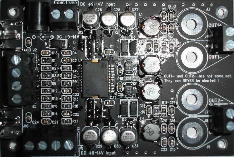

audio1st said:Here is the alternative input Cap mod. It is more difficult and you are limited to what Caps will fit. I used the EPCOS MKT 2.2-MFD Cap's as tested in the Tripath Input Coupling Caps thread..
Hi 1st, on your picture w/ the EPCOS capacitor, the right leg is on a pad on C21 that is gone on my board. What would be an alternate location for mounting this leg of the cap?
It will be R14, the end nearest the input block.

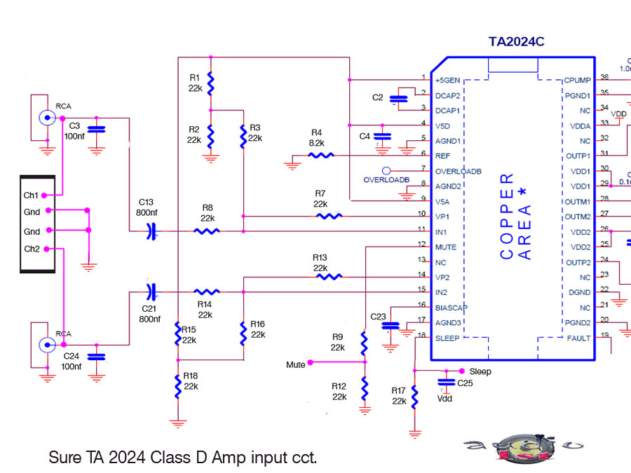

R3 and R16
Audio1st on your sureonboard2.jpg picture it appears that R3 and R16 are removed. Is this necessary to changing the input caps? If the new input caps are place off board, incorporated into input, can only C21 and C13 be bridged?

Re: R3 and R16
Hi nbrophy, no you don't have to remove them, but they do cause 500mv of dc offset at speaker terminals (on my boards). This is regardless of whether you change the input caps or not.
I think removal of these resistors ( R3 & R16 ) and caps C3 & C24 is more important than changing the 0.8uf input caps ( C13 & C21 )..The SI T-Amp had 0.33uf input caps, less than half the value. Please try the amp before changing the input caps, it may have enough bass for your speakers as stock..
PS, all the mods described here assume that the boards have not been changed and have the same value parts as the boards I am using..

Hello audio1st,
Having thus far removed only C3 & C24 (to address the relative 'dullness' I perceived, as per your suggestion), I find there is ample bass (with the speakers that I use), but still find the overall sound considerably softer in the higher frequencies, when compared to a stock S.I.T-Amp.
Would the removal of the resistors R3 & R16 change the sound, and if so, what kind of change can be expected?
Are there any other obvious candidates (for removal or modification) that may be softening the higher-end output?

Hello Robert_S,
Reading back over the posts I see you have tried both 4 & 8ohm speakers with your amp with the same results. With these amps they usually boost or roll off the high frequencies depending on speaker resistance, this is due to the output filter.
As yours is rolled off with different speakers you could try removal of R3 & R16 . If you can just lift one end of each so you can test and replace if you want. This part of the cct is not on the SI amp, so if removed it will more closely resemble the SI.
Please check that the two resistors are the same value as on my board (223, 22k).
Let me know how you get on...

Just want to say thanks to all who contributed the "good stuff" to make this little guy sound great.
Received mine 12/24 so no fun until today. So far I have;
Shorted C-13,C-21
Removed C-3, C-24
Removed R-3, R-16 (this reduced the offset from 350/368 mv to 5/6.9 respectively!!
On my board, the correct location is the other side, nearer to the outputs.
I have also removed the resistors suggested, DC offset came down from about 600mv to 30mv per channel.
I also removed the rogue 100K resistor that was across the inputs of the channel I was having problems with and it appears to have solved the problem of 4.5VDC ocassionally appearing on that channel's output.
Sorry, my mistake 🙁 glade your up and running thou😎
