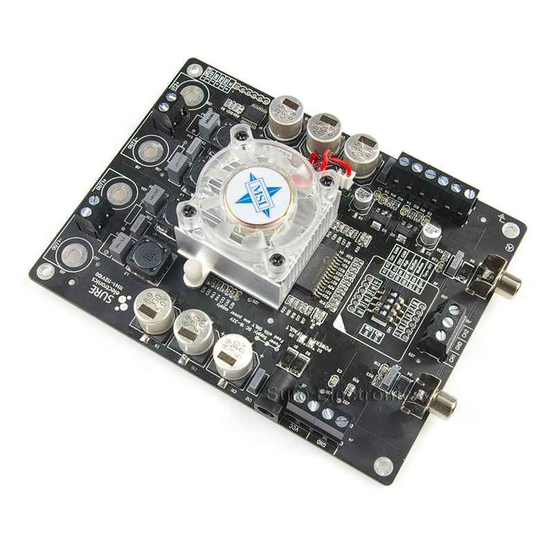

Sure Electronics New Tripath Board tc2000+tp2050

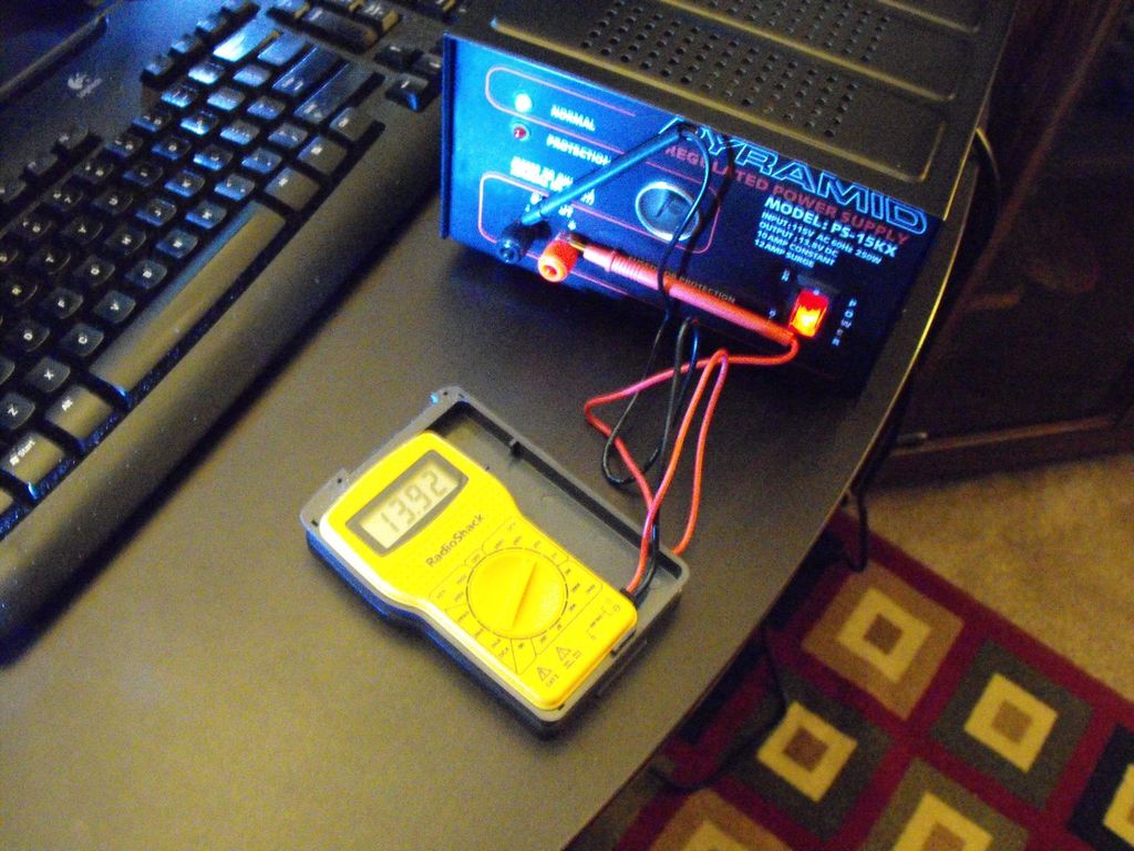

OK now, so after numerous Zep Pressure Tests it would appear that this Amp wants more than 3A. It tries to draw more than that from the HP P/S and causes the Adapter to go into momentary Shutdown..That in turn causes the Sure Amp to go into Under-Voltage Protection Shutdown. But, even so, at 3A it will still play 'Neighbor Annoyingly' Loud..

I've attached a page from the new manual which shows the board layout.
What do you make of this?

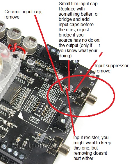

I agree with using the same upgrades. Since this board is different from the original, can you tell me from the picture which resistors need to be removed and which caps need to be bridged if I'm going to add new input caps?

Attached some drawing of the board
Do the same for the other channel
The film cap can be bridged or replaced. If bridged, make sure your source has NO DC ON THE OUTPUT, it will fry the amp. If your source HAS dc, and you still want to bridge it, add some caps at the rcas (take a look at audio1sts drawing)

So, I figured out the P/S ShutDown Problem...The Amp does indeed want more from the P/S...So, I just screwed a Nippon 50v 2900uF Cap across the Power Inputs. Now the Board will Easily cross that Line between Way Too Loud, and Distortion...I now find myself having to turn it down..It seems Too Easy a Fix..
It just passed the 'Zep Test' and I'm expecting to either see Smoke, or have a Knock on the Door...
remove input resistor
The text in the drawing is not quite right. If you bridge the stock cap and use your new cap in a different location than the stock one, such as on the way from a case mounted rca to the board, you must remove the input resistor or else you will be shorting the 2.5v dc bias that sets the output offset trim. You may install a different input terminating resistor before the cap or just leave it out. My dac sounded better with a 20k terminating resistor.
