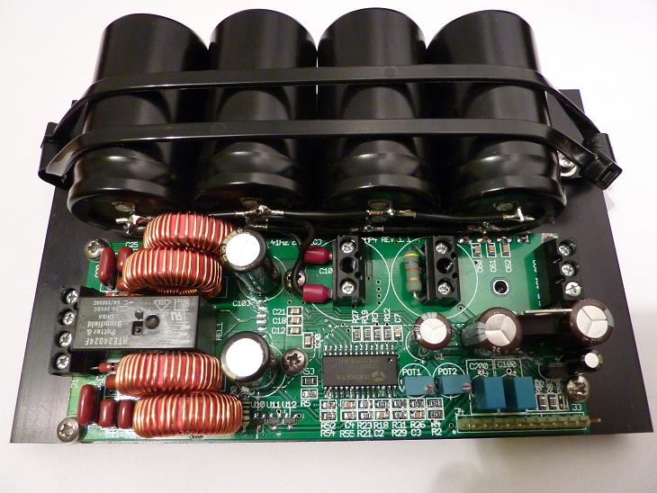

I have dared to mod a 41hz AMP4 to work up to 52Vdc and so I would dare to mod a Sure board to handle this kind of voltage, no problem. If you know what you're doing it's not half as scary...🙄
Here's my 52Vdc AMP4:
attachment.php
This amp is roughly 160W/ch at an 8 ohm load and 50Vdc supply voltage. The AMP11-HV is a mono amp and is roughly 275W/ch.
