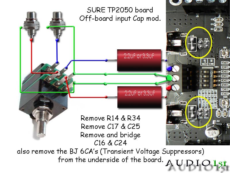

The input caps have 0V dc on one side, and +2.5V dc on the other. You really do only need 10V working (or even 6.3V working) voltage rating for these.

BTW, there's nothing magic about the 2.2 uF value. As a general rule, as you drop below 2 uF you may hear some bass rolloff depending on your system and your ears.
Tripath recommends a high pass corner of less than 10 Hz. 1.5 uF gives you just about 10 Hz. 2 uF gives you about 7 Hz. So anything larger than 1.5 uF should sound fine.
You can pretty much go as large as you want. Larger values generally cost more and are physically larger, but they work just as well. The Sprague PIO (paper-in-oil) caps I'm considering going back to are 10 uF.

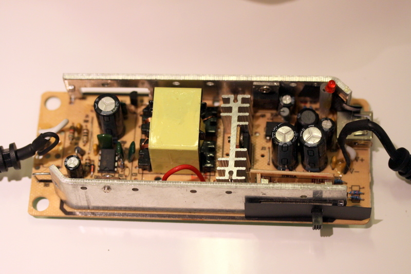

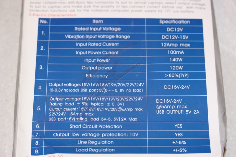

Hi all, I want to use this board in my car, the 2*100w version.
I considered connecting it directly to the car battery, but I read in this thread that sound is a good deal better when it gets 24v.
I have a car laptop charger that can supply 24v 5A, I have attached a few pictures of it. Will this manage to supply the amp with enough power?
The amp will drive five 2" drivers on each output, connected in a bessel array, so it wont go much below 150Hz.
Is there perhaps a easy mod I can to to the DC converter to make it more suited for the task?

The power supply should be fine.
I don't know if anyone one this thread has used the Sure 2*100watt at less than 4 ohms. The board is rated for 4 ohms and I would be cautious about letting the Bessel array drop below 4 ohms.

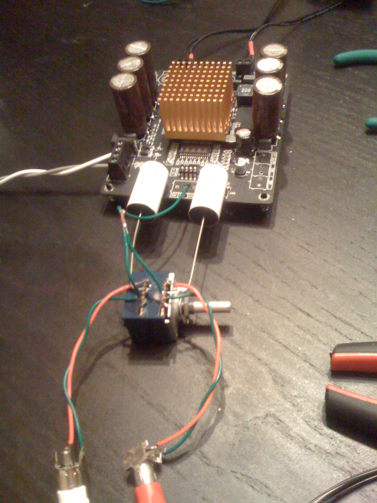

pot touchy
That should work fine if it is indeed connected as per the photo. Your source must have a very high output level to make it so loud, so soon. Changing the value of the pot shouldn't change the touchiness of the control although 10k might sound better than 50k into the remaining 22k input impedance of the Sure. I would have also soldered the caps, or their wires, to the vacated pad on the board rather than screwing into the terminal. Reinstalling R14,34 would also help drop the level so that you can turn up the pot a little further.
I used a alps 50k "blue velvet" pot. Why is it that a very small turn increases the volume alot? Is there another value pot i can use that will make it not so aggresive? Thanks.
