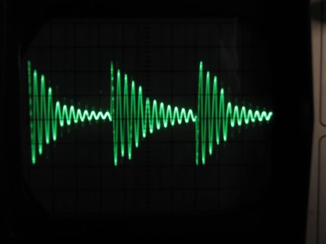

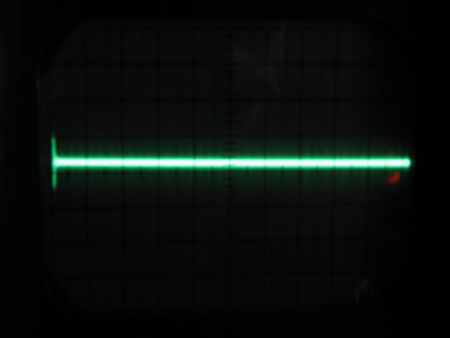

I thought I share this with you:
Mean Well S145-24 with some 10mF and a 0.39 Ohm resistor in series with floating COM, picture taken at 20mV/div and 5us/div compared to COM tied to GND, at 5mV/div and 5us/div.
And I can hear this with a B1 buffer in front of the amp.
A few people earlier in this thread were bad-mouthing using battery power. After seeing this, I wonder. I was using a battery to power the updated SI amp, and the improvement in sound was dramatic. Right now I'm using a 15V 20A linear P.S. favored by ham radio operators. It has a low level mechanical hum in the transformer that drives me crazy when the ambient noise level in my room is very low. Back to the battery, methinks.

When operating at their best, The MeanWell power supplies paint a pretty picture. I don't think a battery would look much better than your second screenshot.
