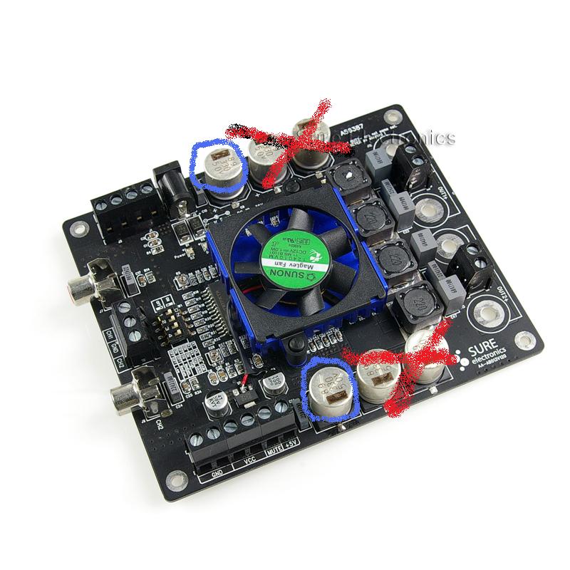

So you replaced the 6 power caps with 6 of the Panasonic?
Did you use these?
I use Panasonic FC series as per digikey, but in US you can get better quality caps refer to Nelson pass Thread, go to his forum look under Capacitor, he recommends using Elna Silk type he said good value and excellent sound, also you can try using Panasonic FM series also very good, you can buy from Digikey. Replace all the Sure caps(6units) with 2*1000uF(one on each end) Elna silk cap. Your sound will be transformed, I guarantee it.
thanks ttan. just to clarify (I am very new to working with the power side of things) - I Just need to order 2 of the 1000uf Elna's. And when you say to place them on each end, do you mean like in the pic below?

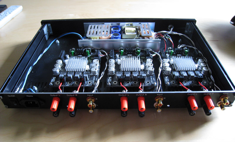

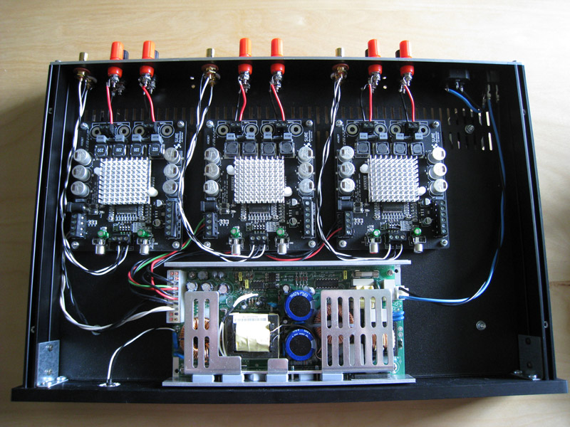

Finally managed to finish my 6-channel amp based on the Sure 2*100W. I am still waiting for the Zobel components which I need to install, but so far I am pretty happy with the sound. The boards are unmodified except for a Nichicon Muse 4.7uF bipolar input cap. i'll spend some more time listening before I consider further mods.

Looks really nice nisbeth, but how does the case and amps handle the heat generated by 6 channels with stock passive cooling?
Is it a modushop case you have use and if so which? (more pictures from all angles is in my wish list 😉 ).
How did you write on the back of your case? Do you have some sort of silk screen stuff?

You're out of luck because I've just finished rearranging and recabling my system and there's no way I am going to take the amp out of the rack to take more pictures of it 😛 :smash:
As for your other points:
- Heat: No issues to report and the top panel is just warm to the touch after a whole day of listening. I do tend to listen quietly though and there's quite good ventilation around the amp so you may get different results. Before I cased the boards I measured the heatsink temp. after about 30 mins. idling or quiet listening to about 55-60C so it's quite hot in there 😀
- Case: Modushop Slimline 1U/280. Two boards and a PSU (this PSU) would fit in a GX348 and one board + this PSU (which is then overkill...) would (just) fit in a GX248.
- Writing on back: Easy, I cheat and get these guys to make them for me: http://www.schaeffer-ag.de. Not the cheapest way to do it, but so nice and easy I am never going back to drilling holes manually on my kitchen table 😀
/U.
/U.
Can I ask what a backside like yours cost? Did you send them the enclosure or how does it work?
Did you just mount the stand-offs through the bottom plate or do you have an inlay in the case?
IIRC it was about 45 EUR less VAT and postage, so it is comparable to the cost of the cabinet 😱 The mill and engrave new alu plates based on your own drawings. You can have them work on your own chassis parts as well but for this there's no real point.
Stand-offs (8-10mm) are mounted directly on the chassis.
