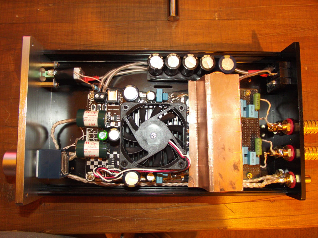

What I have done with this board ( Ver. AB32186V220 ) :
1- Replaced all electrolytic capacitors with panasonic FM and FC.
2- Replaced inputs caps with 2.2uF mundorf ( keep legs short ) .
3- Added 550uF electrolytic to the tc2000 .
4- Added a separated board for the output filter;

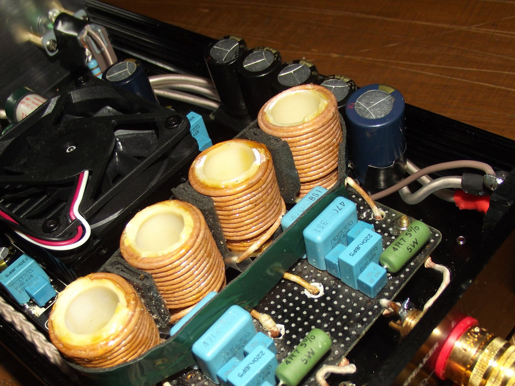

- Low pass Rifa PHE 426 ( I love these caps ) .47uF and baked air cored Litz inductors of 10uH ( Will replace inductors with wurth 7447709100 ) .
- High pass Rifa 0.56uF and MOX 4.7 Ohms 4W .
5- These new boards even have the pads for the snubber caps and resistors, Go for 300/330pF and for the resistor go for 20 Ohms 1/4W
6- Inverted the fan for better air flow.
7- provided a case, alps pot and all the wiring was done in Litz because I had these around and someone said that I could avoid proximity effects by using it.
attachment.php
The look is good but the overall sound quality is solid, with a ridiculous funny and tight bass. Built for under $ 200,00 .

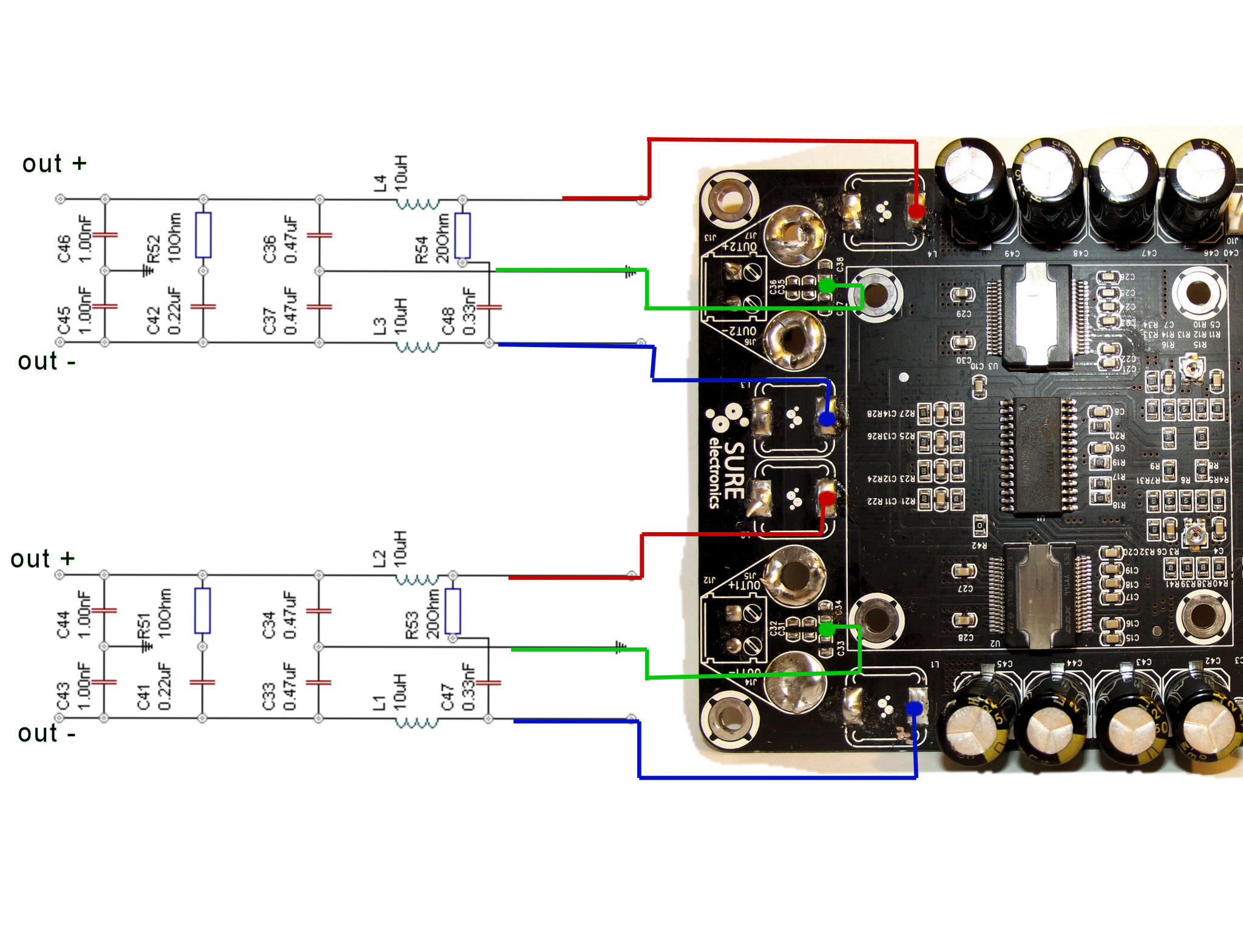

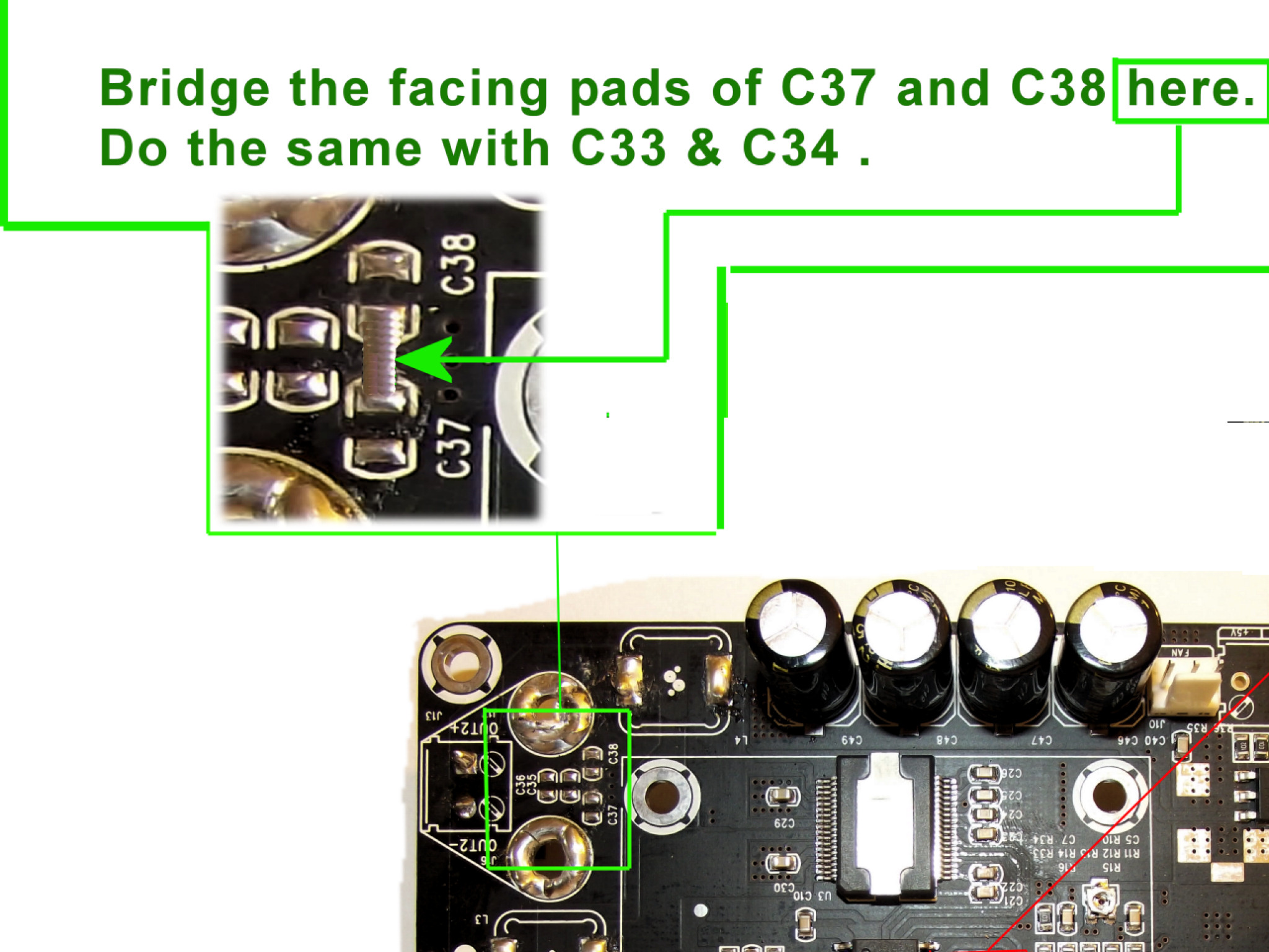

Here you go !
This guide is for 2x100 board version 210. I will do the v220 guide as soon as I can get another board since I am not in the mood to take mine v220 out of the case. Do it at your own risk.
Notice that you should remove ALL the ouput capacitors c31, c32, c33, c34, c36, c35, c37, c38 and also inductors L1, l2, l3, l4. You can optionally cut the traces for the part of the sure board that will become useless.
You are basically making an extension of the board and In the pictures attached schematics you can check the areas wer you should connect this new board with ease. You can do this mod in many ways but that is the more say "easy and friendly way".
The third Picture shows wer exactly you need to bridge the pads on C33 and C34. Only the pads facing each other like in the second picture. all the other pads should be open. At this point If you bridge anything else along with these you will have problems.
The first two pictures have the schemathic for the output filter board and it's realitive connections to the sure board. The first is for a full filter and the second is the basic with only hi and lo pass.
I liked the idea of selling these boards with mods or only the filters board. Ill ebay these in a few days

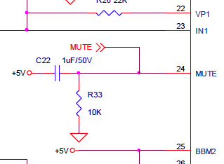

Hi there,
anyone to explain how Sure has done the Mute on their board ? Cap, 5v and R... can't figure what it does.
Anyway, Mute pin not connected mutes the amp and Mute pin to ground un-mute, right? Or +5V to Mute pin to mute?
Having a terrible thump at power off (nothing at power on, not that big 2uF input caps) I hope muting the amp prior to power off the amp can save my speakers and sanity.
