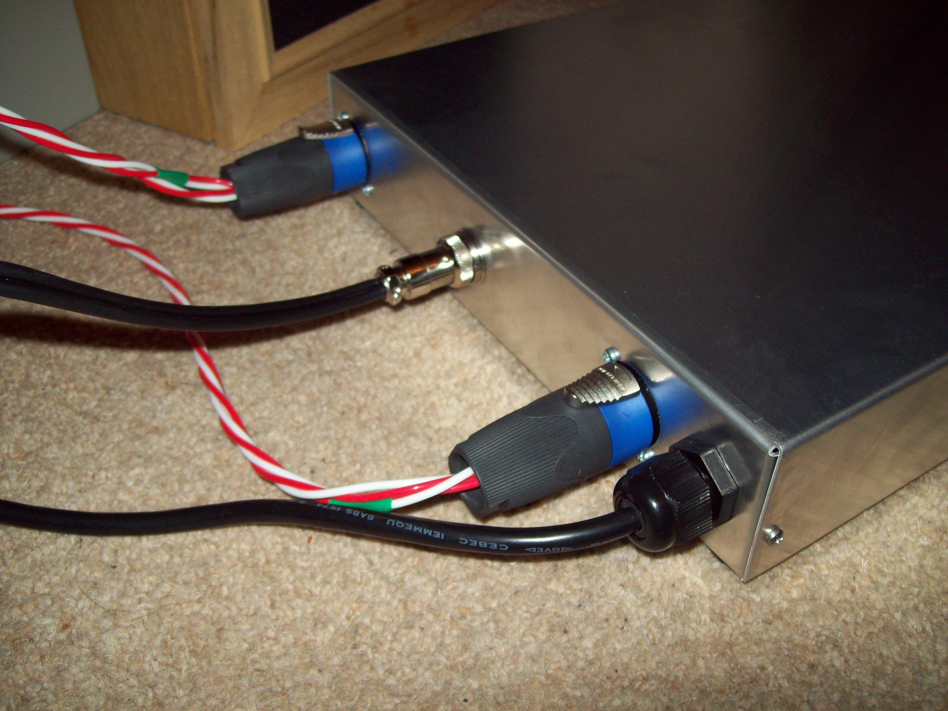

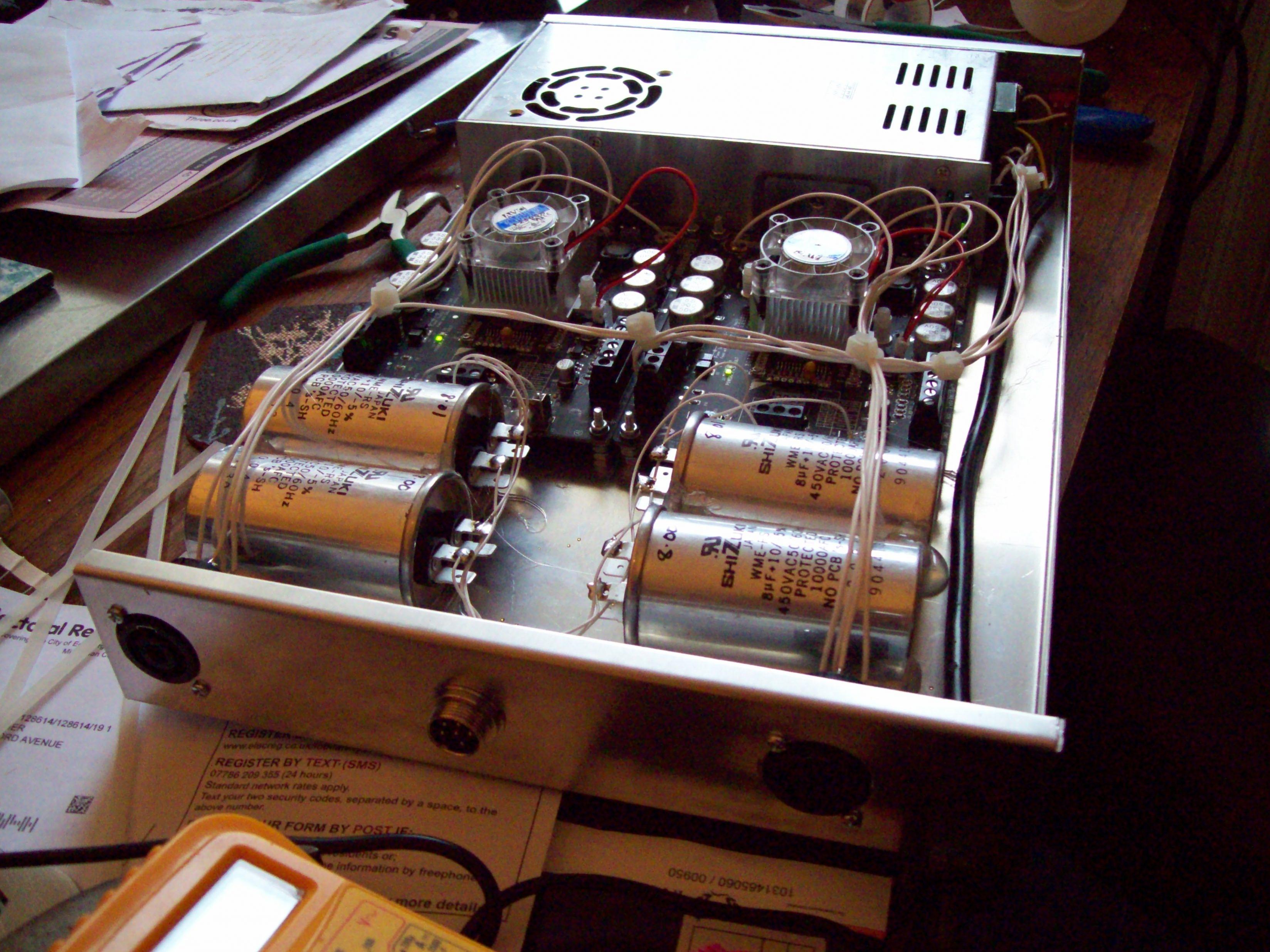

It's all inside my PC but here is a better explanation.
The USB DAC I listed earlier for £12, insert a USB cable and peel back the sheaf wherever you wish. Cut the black and red and wire these to the Sure +5v and Gnd connector. This solves the PC noise issue.
The USB DAC has a 3.5" output socket and good but large low-ESR capacitors. I soldered two 3.3uF Nichlon MUSE capacitors in parallel to boost the quality in the mid-high.
Take a 3.5" headphone style lead and cut the phono sockets off. Wire the ground to the Sure GND and the red/white into the +in on the 6pin or so interface on the board. This bypasses the sure boards decoupling section to maximise sound.
I'm using Tannoy 607's and the quality is astonishing. I figure the 609 and 611's would be just as good. I'd avoid the MK2 as the MK1 had a true flat response - Tannoy reduced the upper end with the MK2 as it was deemed too harsh. I prefer accuracy though. 🙂
And accuracy is just unbelievable with this set up. Frankly, I'd pitch this against anything - at any price.
Regards, Andrew

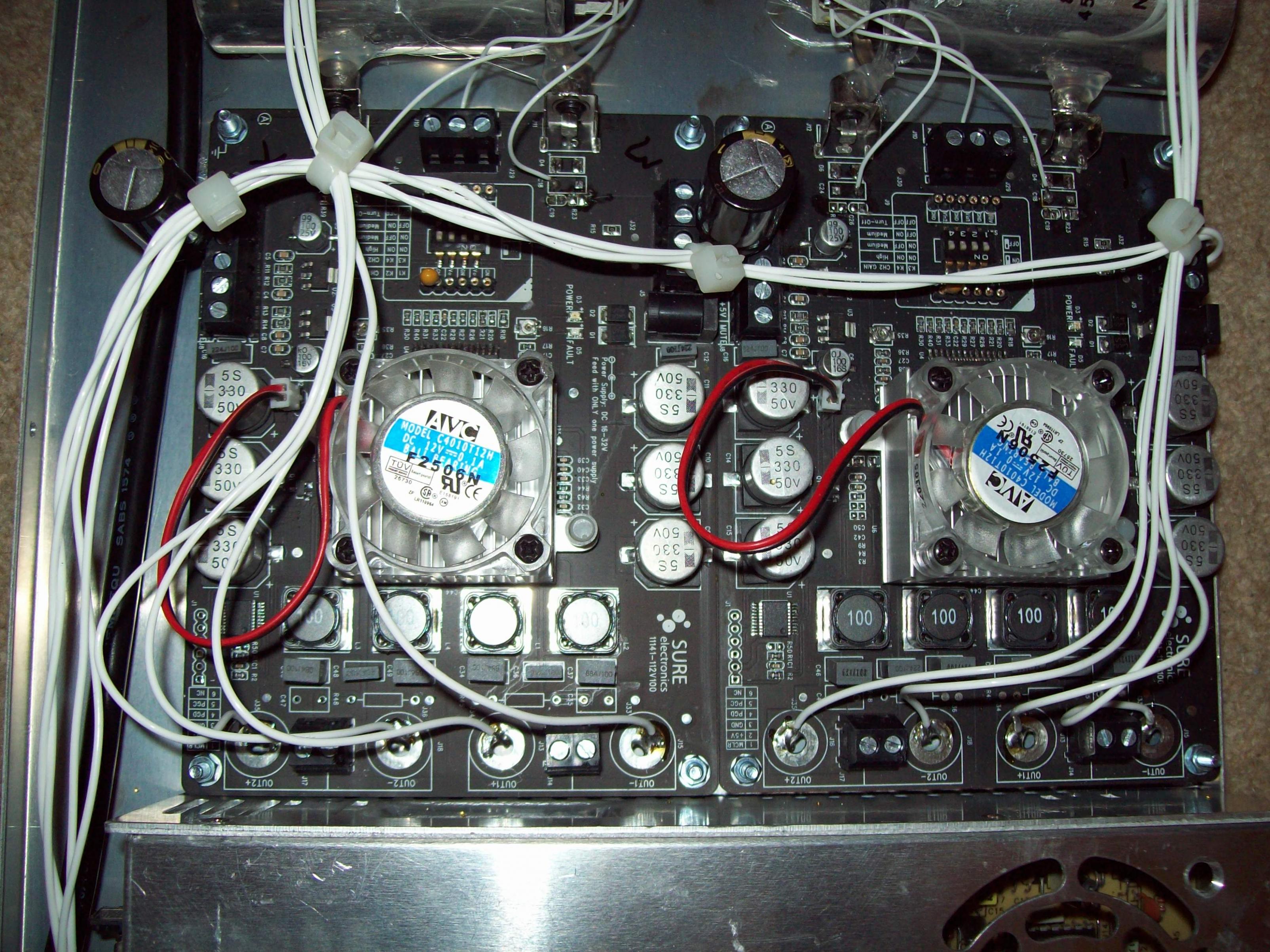

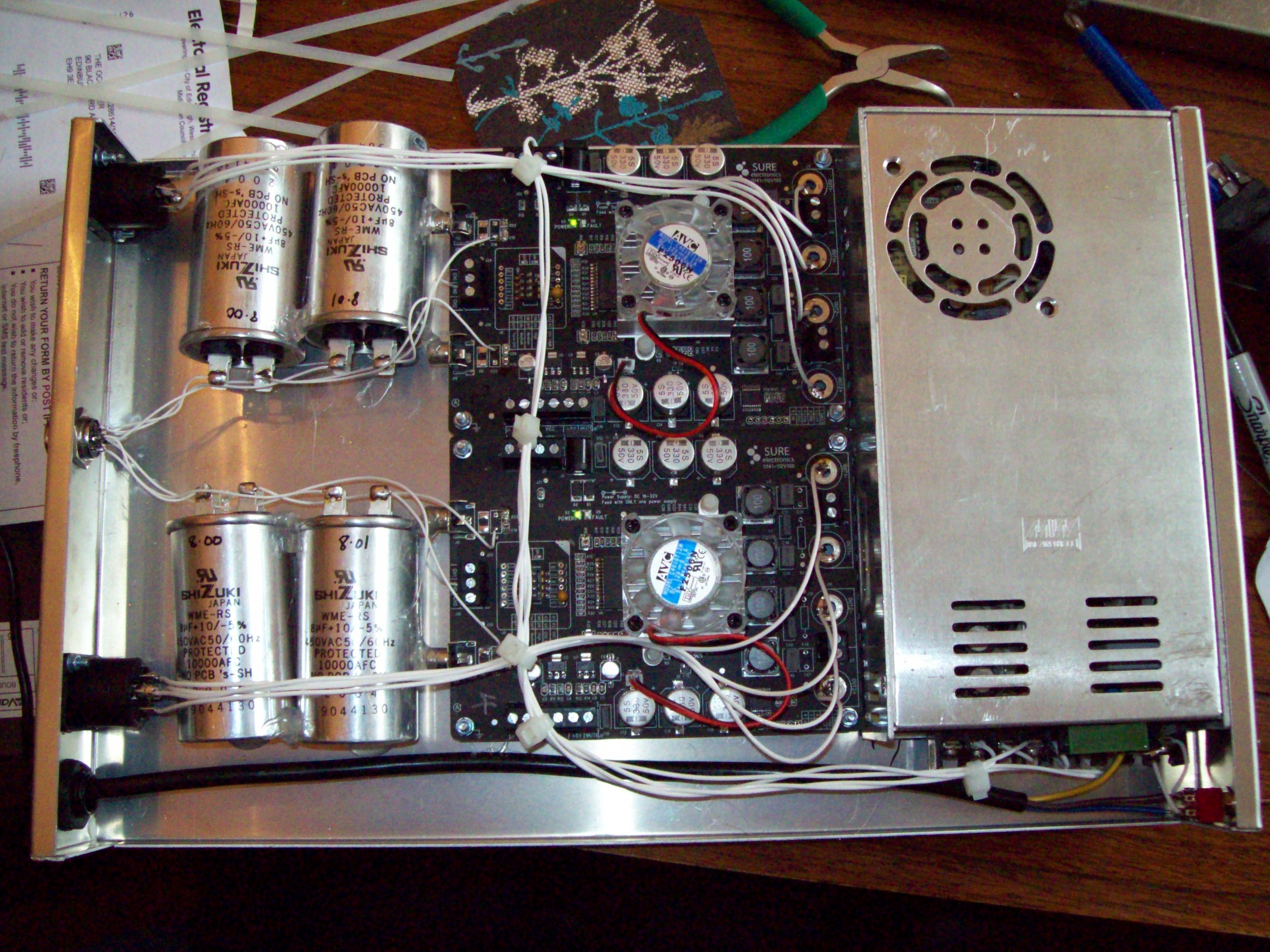

Upgraded
Got rid of the diodes and upped the 12v to 27v using one of these;
eBay - The UK's Online Marketplace
And installed an AMD heatsink.
Got quite a punch now, just the same outstanding quality as before. Bliss.
