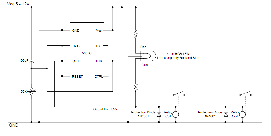

A simple solution for On-Off thumping
I found a simple solution to eliminate on-off thumping noise based on the information provided in this web page 555 and 556 Timer Circuits (Schmitt trigger). It requires just a single 555 IC, a capacitor, a resistor, two SPST relays (or a single DPST relay) and a protection diode. Optional LED indications can be included very simply as shown in the attached diagram. I am not an electronics engineer and I don't know how to draw "standard" circuit diagrams. So I just tried to show how I lay the things on my strip board. I hope you can understand it.
Note that 555 accepts anything between 4.5VDC and 15VDC according to the website above. The coil voltage of the relays must be selected to match the input voltage you are supplying accordingly. I read that most relays can tolerate a bit higher voltage than specified. Personally, I have used two 5V SPST (Normally Open) relays with contact rating of 10A@30V. I supply 5.7 VDC from a phone charger which I savaged from my old Nokia phone.
The turn-on delay time is a function (a multiplication for approximation) of the capacitor and the resistor values but I suggest using a low capacitance and a high resistance (rather than high capacitance and a low resistance) so that we get "instant off" effect. If the capacitor is large, it will take time to de-activate the relay and it might cause turn-off noise. Personally, I have used used 100uF and 50K preset turned down to around 30K to give me about 3 seconds turn-on delay and almost instant turn-off. It's also important that the power source does not have big capacitors of its own. The nokia phone charger I am using doesn't seem to have any (or very little) capacitor in it, which is good thing for "instant off" effect.
The 4 pin RGB LED connected as in the diagram lights Red when the amp is turned on and after the delayed time, will also light Blue when the relays are activated and the speakers are connected illuminating some purplish colour.
I have built the simple circuit and tested and it works for my setup. Please note that it's NOT a speaker protection module, but just a simple solution to eliminate thumping noise during on and off.

Getting rid of the pop...
YouTube - Tripath anti pop turn on/off circuit for SLEEP and MUTE
It can be very simple...
Here's what I designed:
It's the sequence that matters, first transistor can toggle the sleep and mute in one draw and the second a speaker relay...
Thanks for your suggestion.
Not sure if I understood your design right. Means that I find sleep and mute connection on the sure board ?
Is the 12 Volts a separate supply or just the power input of the board ? Usually it should be then at least 24 Volts if your design is integrated into the powersupply connection of the board.
Do you have a breadboard? I suggest you buy one and make the circuit and experiment with it....
It can run on any voltage between say 10 and 100V as long as you tweak the capacitor and resistor values correctly.
For the sure board you can take a 24V speaker relay and get some caps that are rated at least 25V.
It's not rocket science, just a cheap and simple, yet very functional circuit. Basically the transistors make ground in a 1-2, 2-1 sequence. You can choose several things to make ground (relays, chip function pins etc). For instance the sleep and mute function on the Tripath chips are activated that way. But it would suffice to just ground the mute with T1 and then it would be most effective to have T2 do a speaker relay.
You can even connect Hmute to T2 with a similar resistor value towards the base to ensure quick speaker disconnecting when something goes wrong....
