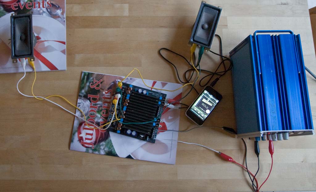

Hello.
I've been lurking here for a few weeks, and was inspired by this thread (and the one about the 2-channel version) to reboot my HiFi-interest. (Well, maybe moving to a larger house with room for decent speakers have something to do with it as well)
</intro>
I just received a 4-channel Sure-board, and reading about the magic smoke being let out at first try, and about missing isolation-washers, I wanted to test mine out immediately.
First the washer; it seems to have been poorly mounted and gets pulled towards the mounting screw when it's being tightened. With a little care, there will be no short, however.
After setting things up with an Oltronix lab-ps (20V 1.5A) a pair of speakers (computer-monitor pulls) and an iPhone for source, I swithched the power on, but was greeted by a whining noise from the speakers. This was due to the current limiting set to 150mA, and went away with more "juice" 🙂
With everything working, and no smoke billowing out I was greated by far better sound than I had expected!
I look forward to box this amp and hook up some serious speakers!
Thanks everyone for the inspiration!
