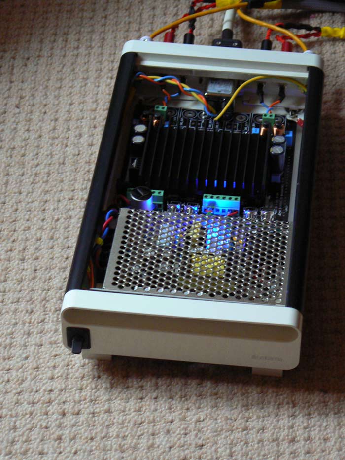

audio1st, could you provide front, side and pack pics?
It is just an old food warmer..😉

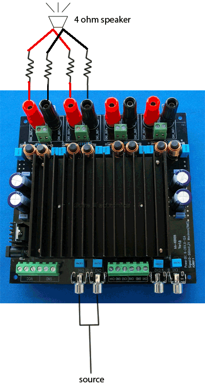

Quite a few people have asked about bridging... could someone confirm the wiring I've posted will work?

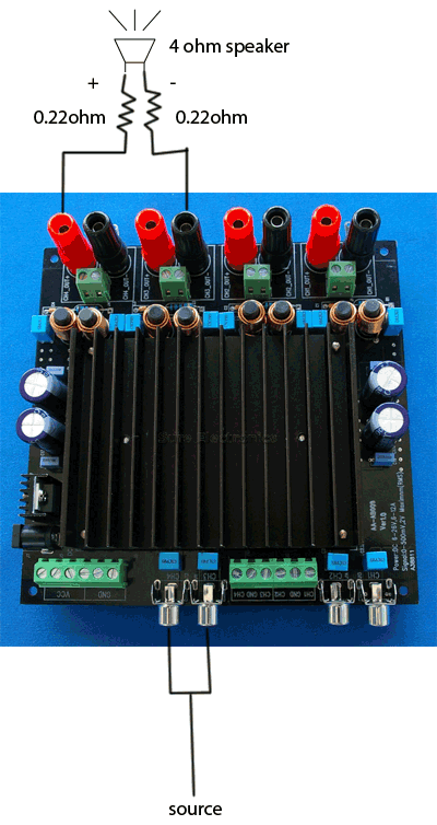

No, I believe it should look like the pic below.
BTW, to not start or continue any confusion this is to parallel the channels. Each individual channel is already a full-bridge.

Thanks for clearing this up! 🙂 I've only ever seen paralleling with drivers (eg 2 x 8ohm drivers wired to an amp channel and has a 4 ohm load). This is the first time I've seen amp channel paralleling, I'm learning new stuff all the time on here... 😎
Does this amp channel paralleling affect the impedance at all, or will both amp channels operate at 4 ohms when driving a 4 ohm speaker?
Finally, may I ask what the resistors are for? Do they help balance the load between the channel, or just raise impedance?
