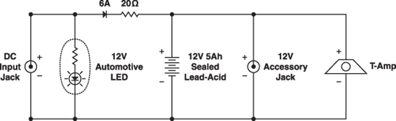

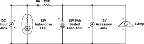

If you check the podzuma schematics, he charges his 12v battery pack with a diode and resistor.
Now, I have 2 12v 7.5ah batteries in series for this amp. If I put 2 12v accessory jacks in series, what kind of things do I need to change in order to charge my 24v battery pack instead of this 12v circuit.
