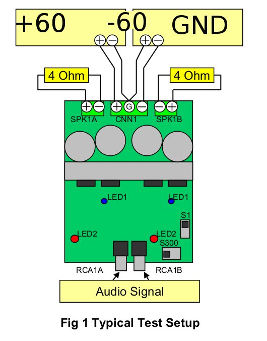

Hello, this is my first post and I am looking for repair assistance for my setup. While switching cases and adding some goodies I happened to switch my -60 and gnd leads.
I didn't notice before pwr on and it sounded violent we'll say 🙁
CSD pin on irs2092s (L&R) have a small divot characteristic of toast.
Anything thing else I might have killed with those 2092s?
Think the smps500r is ok?
I did this:
