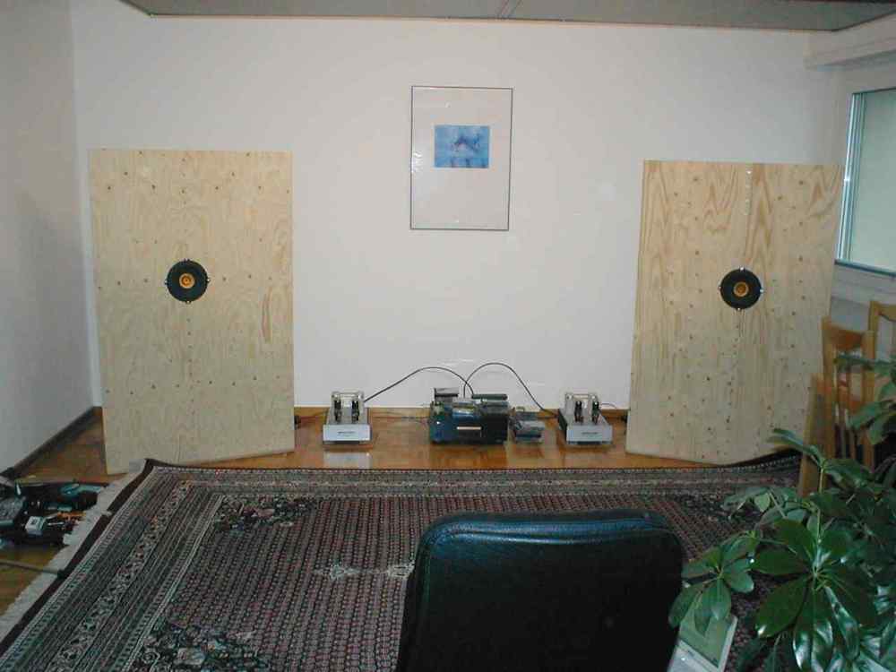

I just finished my OB with these drivers and had a listen. No long time necessary to realize the Fertin 20EX is the best driver I ever heard.
It replaced a "Magnificat"speaker, according to KYW's naming (axiom 80 & axiom 201). OK, the OB has less bass, but with one driver alone, it is making quite nice bass with a 162X100X1,5cm panel.
It has a sound closely related but better than the axiom 80: dynamic, detailed and smoth. Timbres accuracy is great. Just now, it has a so-so DC supply just for breaking in the drivers and because I could not wait more ; batteries later.
So, without any refinment in the setup 🙄 (well I mouted it flush both panel sides, not easy with this guy ...), the potential is there without doubts.

Fertin 20EX setup
about toeing in, yes: to my understanding, at high frequencies the radiation is quite directional. So I have aligned the driver axis with the listening position (see picure).
Of course, I'll tell you about batteries. I googeled a lot about batteries and found only positives reports about it.
Gilles, I don't understand why you say the FC is max. 12V. At Fertin website, the values range is 5 to 15V (20EX curves ).
About the FC power supply I use (constant current regulated):
12,9V - 1.19A (R=10.84) at start
12,9V - 1.10A (R=11.72) after 2 hours.
I choose 12.9V as I read in this forum that at this value the magnetic circuit is saturated. But dice45 had 12.9V/1.5A (R=8.6). Does anyone knows whether the FC design has changed ? I'll also ask Mr. Semblat. A little OT, sorry.

It's best to experiment with PS voltage. When I was using previous version of 20EX, I settled on 11.5V as this worked best in my setup. Increasing voltage above that value seemed to degrade the sound. The PS was based on adjustable LT1086 regulator.
Now, that I have the new version of 20EX, it appears that the driver works better with higher supply voltage (12v and up). I still didn't do any serious comparisons, as I was waiting for a complete burn in.
