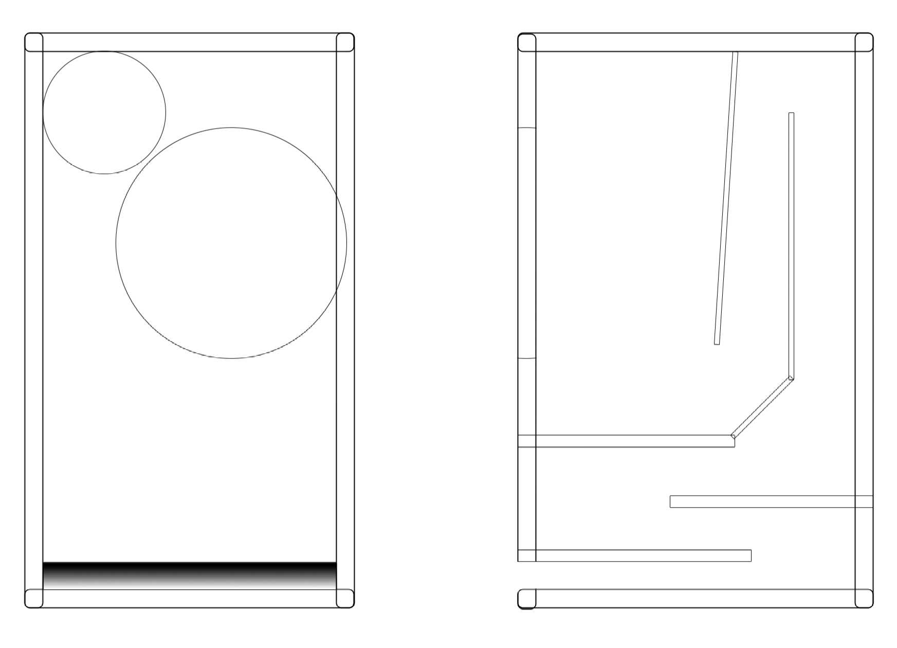

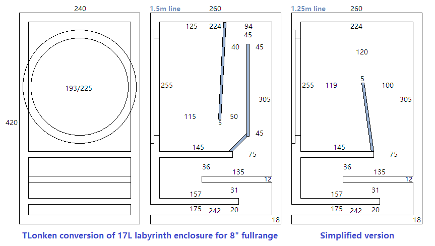

Hi bob53, I looked up the TB's specs: Qts=0.27 Vas=90L Fs=42hz ventedVol=23L ventedF3=65hz (compare F200A specs in post #20). The 17L 1.5m 1:6.25 <40hz TLonken should work if there's good room-reinforcement; 23L (make cab deeper or taller simplified) would be better and allow the tapered line to be fully fleshed out. If you started with a run-of-the-mill cab and inserted cardboard dividers to create & lengthen the line, the jaw-dropping "good bass" will go incrementally deeper. I stop when my music requirements are met (organ/piano/bass-drum climaxes). Also, my one TB (W5-1880) takes/taking a very long time to run-in.
BTW, tapered ML-TL isn't new just somehow overlooked by MJK, Bob Brines et al. So-called "Fat Thor" ML Beta is 83% the volume of "equivalent" TL design.
FatThor tapered TL 191x1111x582=123.5L https://www.diyaudio.com/community/threads/clarity-on-seas-thor-kit.64799/post-743582
FatThor ML tapered TL 191x1093x492=102.7L https://www.diyaudio.com/community/threads/clarity-on-seas-thor-kit.64799/post-744315

Don't know if the 20% larger 123.5L Fat Thor was a highly suboptimal tapered-TL design in terms of volume.
Citing MJK, Bob Brines has shown (ppt or pdf, see https://www.diyaudio.com/community/threads/low-sensitivity-coaxial.396170/post-7282796): Tuned to the same alignment frequency, all five types deliver equal SPL and fall-off, but line volumes are straight-TL(100%), TQWT(70% or 76%), ML-TQWT(62% or 50%), ML-TL(57% or 51%), tapered-TL(51%). Too bad no ML-tapered-TL (TLonken).
Thought experiment 1: TLonken is an "approximate" tapered TL. One can Hornresp a few hundred times over (area ratio, average CSA, slot dimensions if any) to optimize/minimize volume given target QW alignment and output, thereby quantify whether/how much it helps to have the ML slot as a design freedom.
Thought experiment 2: The bends and folds in the line are empirically important to the sound, in two ways. First as filter to reduce output, more so the higher the frequency including QW harmonic peaks. Second, if a bend is treated as a halfwave pipe to the exit terminus with reduced length and CSA, and derived, mulitply-reflected paths are similarly considered for standing-wave resonances, the calculated summed response might be somewhat different from a straight line. Perhaps at least the first fold/bend can be simulated.

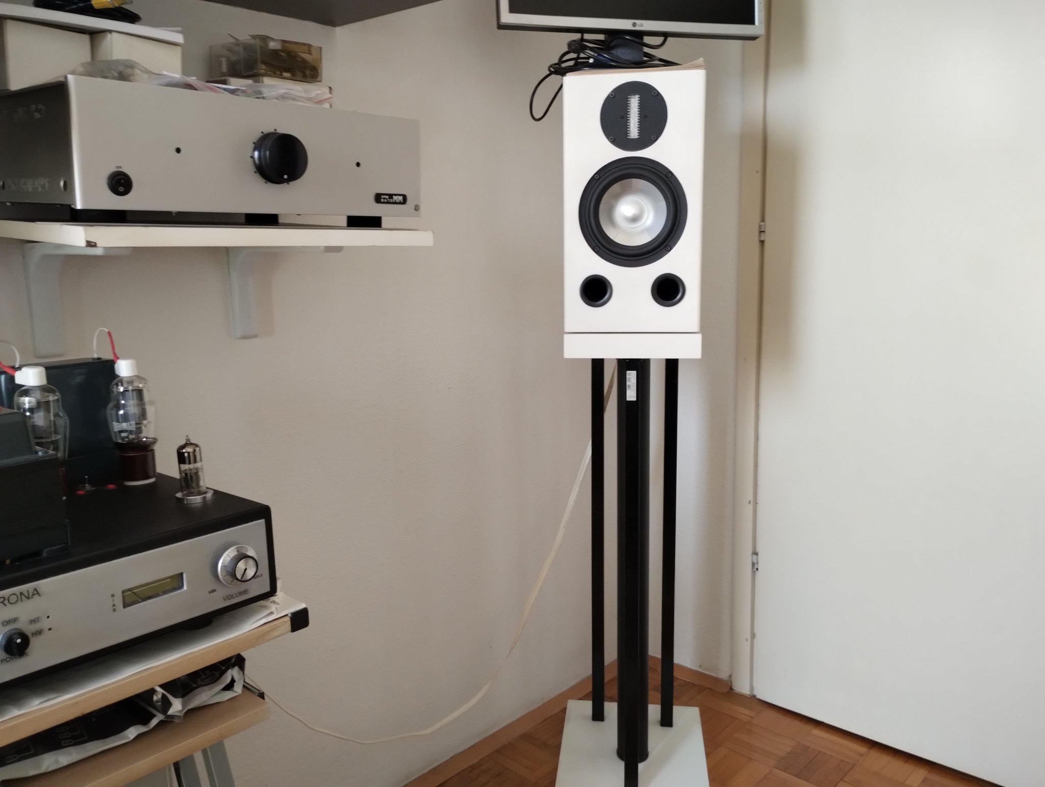

Hi wchang,
Thank you for comprehensive answer.I must explain why I asked for your opinion.A few years ago I made, based on Hiraga calculator, TQWT speakers
with Jamo IO165(wall spk.)+Jantzen tweter.They mesured good and sounded decent. I made my own TQWT design for TB 1772,but it is BIG box.
My room is small and speakers (SBA+RALL-on the picture) are about 1.5m away from my ears.

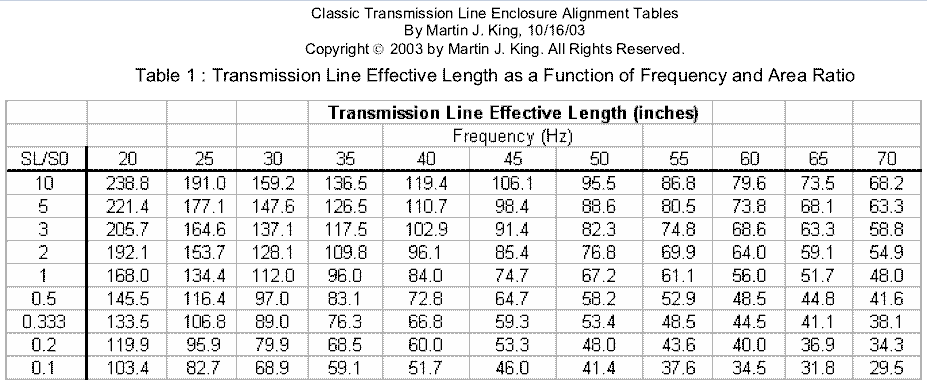

When I saw your design,I liked very much.But I know that the line must be lengthen to ,2,15m for 40Hz and volume has to be risen to 23l as you wrote.
I shall make it with 2 addtional "tube" and see what will hapen.
Regards

Well, I designed it, so I'm in a reasonable position to say on that front.Don't know if the 20% larger 123.5L Fat Thor was a highly suboptimal tapered-TL design in terms of volume.
Except they don't, quite. Bob's example suffers a little as it's not entirely like-for-like, and acoustically large to begin with so in relative terms gain should not be a problem for the chosen Fb. However, you can in fact see that gain is reduced for the tapered line relative to the straight, with its greater Vb, and clawed back with the expanding line (horn). As noted, your 'ML-tapered-TL' is just a tapered TL (tapered TLs are mass-loaded by definition). It's just a slightly over-complicated geometry thereof; you'd get more or less the same results by using the same Vb & simply adjusting the length & taper ratio to achieve your desired Fb.Citing MJK, Bob Brines has shown (ppt or pdf, see https://www.diyaudio.com/community/threads/low-sensitivity-coaxial.396170/post-7282796): Tuned to the same alignment frequency, all five types deliver equal SPL and fall-off, but line volumes are straight-TL(100%), TQWT(70% or 76%), ML-TQWT(62% or 50%), ML-TL(57% or 51%), tapered-TL(51%). Too bad no ML-tapered-TL (TLonken).
You can, but as noted, ducted vents tend to be most useful with untapered pipes and horns. Since a tapered pipe is innately mass loaded, there doesn't seem a whole lot of value in providing only a small amount of loading via that, and then adding a duct to provide what the basic geometry fails to provide -assuming you're holding Vb static, you might as well just just a higher taper ratio to achieve your desired tuning & have done with it. No harm in it of course, it's just a somewhat over-complicated way of going about it. The caveat there I'd add is for tapers created by (in this case a contracting) cascade of untapered pipes that are approximating a general target taper ratio, e.g. 6:3:1 or whatever. But in that case, the final part is an integral stage in the overall line rather than viewed as an addition.Thought experiment 1: TLonken is an "approximate" tapered TL. One can Hornresp a few hundred times over (area ratio, average CSA, slot dimensions if any) to optimize/minimize volume given target QW alignment and output, thereby quantify whether/how much it helps to have the ML slot as a design freedom.
'doesn't have to be empirical, except in the sense that all science is ultimately derived from empirical testing & observation of behaviour.Thought experiment 2: The bends and folds in the line are empirically important to the sound,
They all can be, if you've the software to do so. That's how most of my commercial horns are modelled at some stage of their design process.in two ways. First as filter to reduce output, more so the higher the frequency including QW harmonic peaks. Second, if a bend is treated as a halfwave pipe to the exit terminus with reduced length and CSA, and derived, mulitply-reflected paths are similarly considered for standing-wave resonances, the calculated summed response might be somewhat different from a straight line. Perhaps at least the first fold/bend can be simulated.

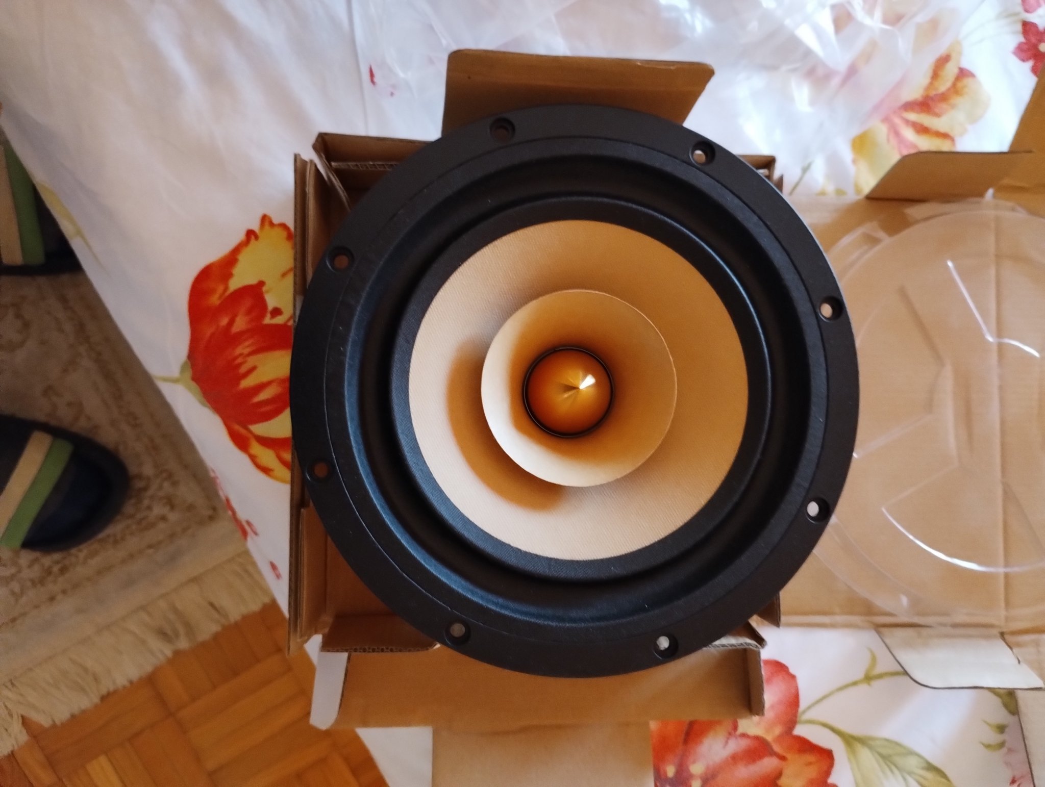

I would like to ask you how you see the use of a new Supravox 215 Heritage bi-cone driver with field-coil magnet in your TLonken 17L 1.5m cabinet. The possibility of varying the operating voltage of the field-coil magnet should allow fine tuning of the Qts value (I plan to use a battery supply).
Do you think it would work properly without applying modifications to your design?
Thanks again and congratulations,
Gianluca
The driver : https://www.supravox.fr/products/215-heritage-bicone-exc-haut-parleur-large-bande-25w-96-5db-8-ohms

Heart takes a leap seeing those beauties. The 215 heritage (bi) cone itself should be very similar to mine. I don't have first-hand knowledge of field coils though, especially how to lower Qts to near ~0.3 like the vintage permanent magnet 215. Since you are not constrained by a ready-made cabinet, I would suggest a slightly wider and deeper box, so there's more space for the field coil, and the first divider board tilted more to redirect reflection. Greater width should lower baffle-step a bit and raise deep bass sound level by adding volume. Finally, the stepped tapering of the line could be tweaked (middle divider lowered fractionally) to be more "geometric", though this might not be audible. Better material (hardwood or good ply) will lessen the work needed to pad the driver-chamber surfaces for max-clarity sound (MDF untreated imparts "warmth"). Those are my initial thoughts. Your kind words are appreciated.

Yes, the 215 Heritage EXC is a field-coil driver actually! Their website is wrong by reporting the same specs of the non-EXC version for the EXC version of the 215 Heritage!

Following your invaluable advice I am thinking of increasing the width of your original TLonken to 30cm and proportionally enlarging the depth and height. I will use 2.4cm birch plywood and try to calculate exactly the proportional increase in internal dimensions according to your design.
If I understand correctly, I will have to angle the first partition board just behind the driver a bit more and leave everything else untouched (I don't think I will be able to apply fine modifications to your design!).
What do you think? Could it work?

More drool... As you double the volume (each dimension ~5/4) and lengthen the line (~5/4 proportionally lowering the quarterwave frequency), there may well be enough boost to the low-end to not need those very expensive subs. Especially given the adjustability of your intended field coil (relax on the Qts a bit due to cab volume) and amplification means.Following your invaluable advice I am thinking of increasing the width of your original TLonken to 30cm and proportionally enlarging the depth and height. I will use 2.4cm birch plywood and try to calculate exactly the proportional increase in internal dimensions according to your design.
