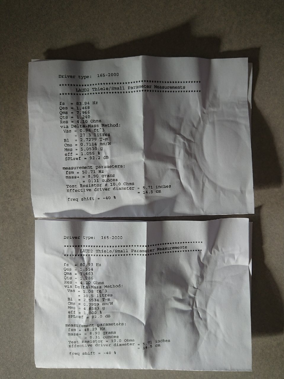

Arrived today so thought I would test them, hoping there would not be such quality control issues as mbrennwa had below:
Supravox 165-2000 parameter inconsistencies
Out of the box, they came with individual spec sheets with the measured parameters, not looking good as they both say a Qe of around 1.5!
Most of the other specs are roughly in the right ball park, fs a little high but not too far.

Ouch. I'm sorry, but I'd send them straight back. Especially if the individual spec. sheets you say they've provided are so far away from the published data. Some tolerance variation is to be expected, particularly with hand-built drivers, but that's way too much. They advertise a Qe of 0.9 and they then supply you with units they themselves have measured at 1.5? Nearly 68% higher? That's ridiculous.
A real shame. I genuinely want to like Supravox; European specialist company in a small field, no bad thing. But it's a mite tricky when they knowingly send out product massively wide of published spec. :scratch1:
Post 10 above states that individual data sheets were supplied with the drivers themselves, and that these show electrical damping to be far from the advertised specification on the Supravox website:
The advertised Qes on the Supravox website is 0.9, making a deviation of 67% [nearly] from what is advertised. :sad:

If it's a typo though, it's a very long-standing one indeed. Back in 2003 that unit had an advertised Qes on their website of 0.8. Some time between April and November 2006 that was changed to 0.9, and it has remained at that 0.9 value on their website ever since, even when they got a brand-new site earlier this year. Hopefully they'll be able to send a replacement pair out that does conform reasonably to the advertised spec.
I have emailed Cyrille @ Supravox and he is looking into it.
As Scott says, the drivers came with spec sheets for each, and the values largely reflect what I measured.

Attached are the spec sheets from Supravox for reference.
