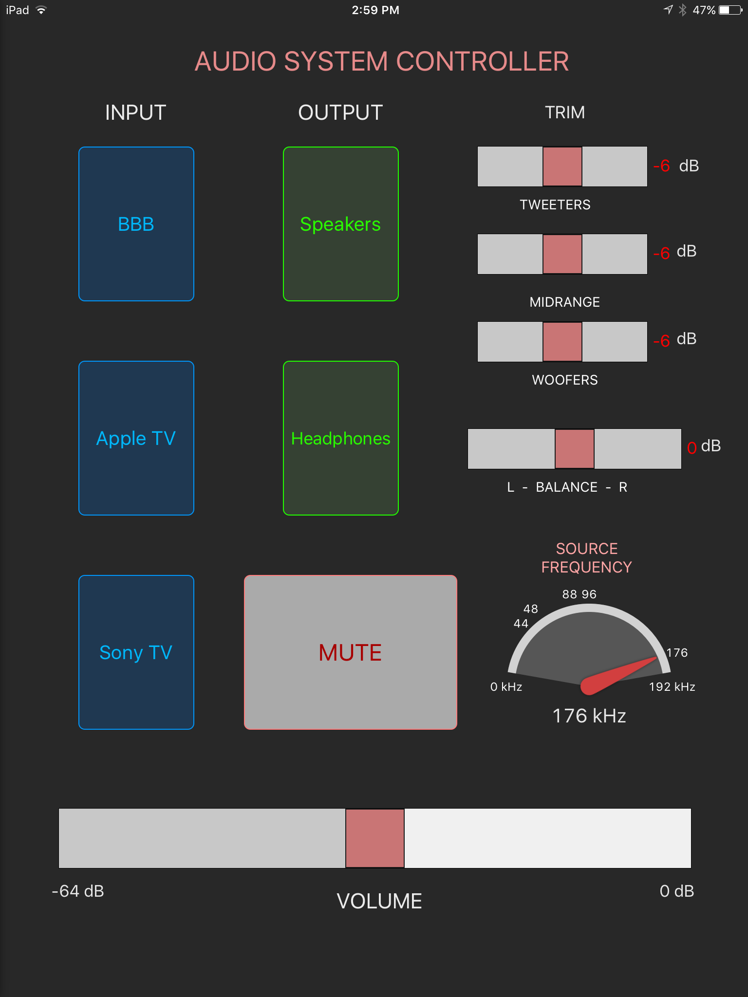

As an alternative to a front panel display why not get the same information presented to you on a tablet/smartphone in the comfort of your listening seat? Oh, and be able to select what is playing from your network music library on the same device (and, I'm hoping, be able to control the volume too - presume that will need miero to release a Botic distribution with i2c).
Ray
I have been working on and off on the kinds of things that Ray spoke about some time ago. There are many ways to integrate the functions of these little boards and I have come up with a very personal version of a full-function audio appliance. The controller uses the NetIO application for iOS, and my wireless remote is comprehensive for my needs. All volume functions are at the level of the ES9018 DACs. Photo attached. An on-going 'how-to' thread exists nearby. I welcome your questions and comments there.
Best,
Frank
